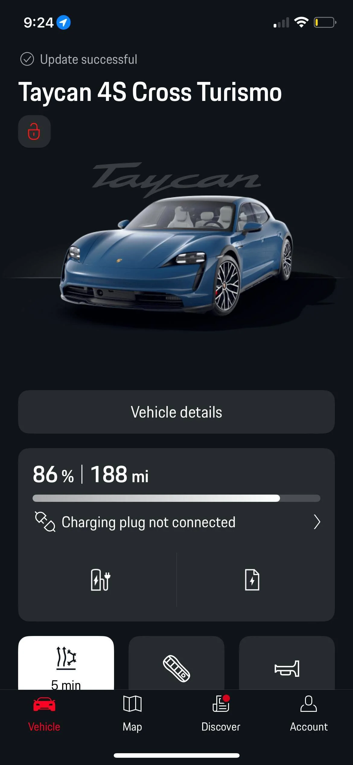

Have you found the state of charge home screen on the my Porsche app nonoperational with ChargePoint EVSE? My my Porsche charging screen is locked with this information displayed:
Porsche Taycan ChargePoint vs Mobile Connect for home charging IMG_1159
