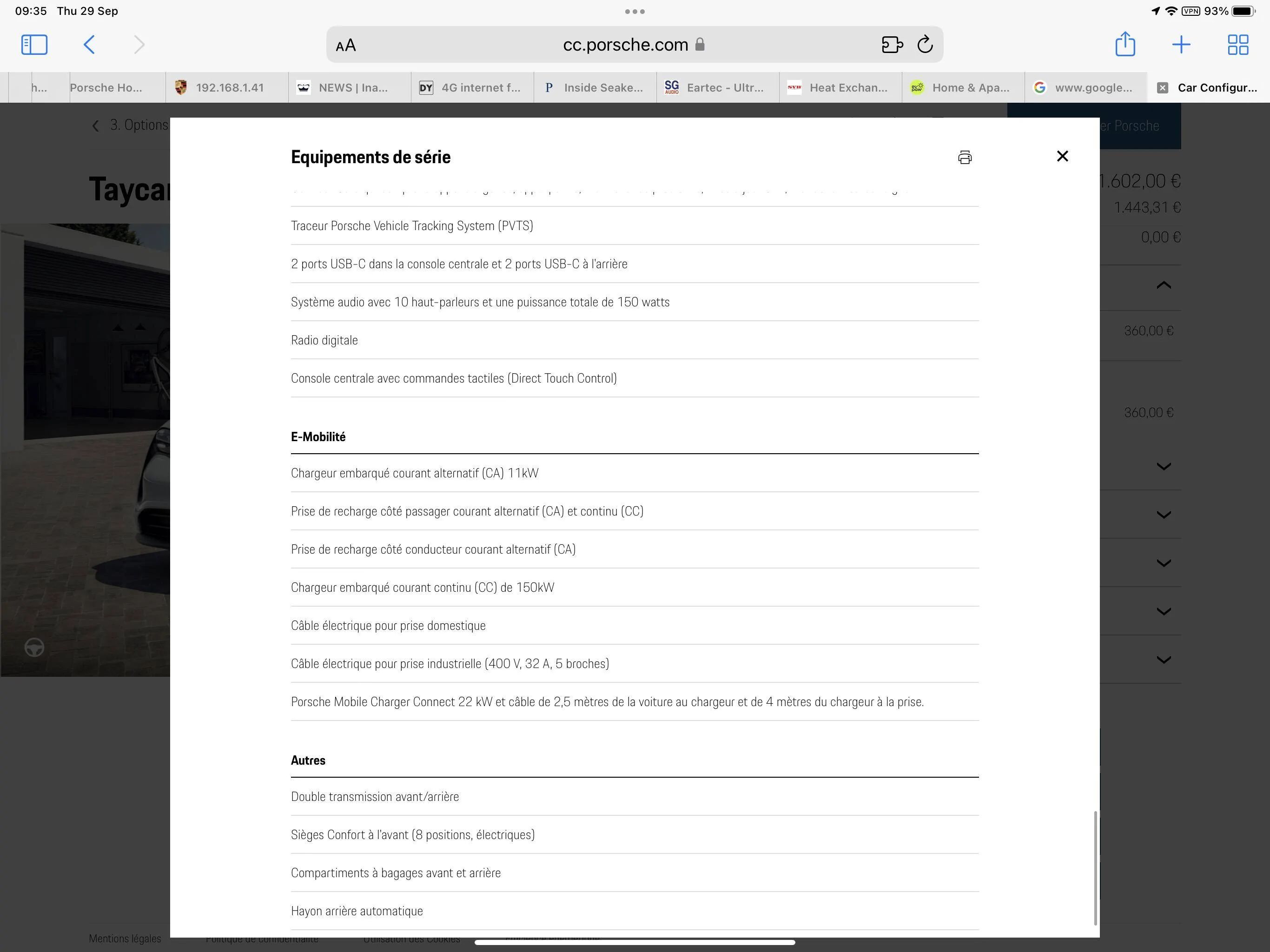

Ah, ok - didn't realise PMCC is standard for France!
Is the on-board AC charger the basic 11kW or is it also 22kW?
If so then this is a no brainer assuming 3 phase is installed!
It would look like there is a difference in standard spec between UK and France. And here in France it also seems they have included the onboard 150 kW , 400 volt charger as standard, which makes a lot of sense since Tesla opened some chargers.
But the 22 kW charger is not standard? A bit surprising since there are so many 22 kW charge points due to the Renault Zoe.
Yeah I noticed that too. In respect of 22kW AC on-board I thought the same but perhaps its price sensitive at a certain point?

One more question. What is the difference in the PMCC and PMC+. I think you are saying I get the PMCC in France for free.
I think I would have the 22KW onboard upgrade. This solution avoids a wall charger anyway which I had budgeted for. Just hope the Enedis cost to upgrade to 3 phase is not rediculous. I have no other option but to use them as they own the infrastructure here in France.

My advice for you would be to look around where you live and perhaps where you intend to drive, short and long trips, before ordering the 22 kW charger. It is an expensive option and if you have your home charging sorted out plus checked where you have any of the fast DC chargers like Ionity, the role of the 22 kW onboard charger might be limited. There are other options in the Taycan that can give more enjoyment! Two yers ago when I got my Taycan the 22 kW charger would have been a great addition, but now there are so many DC chargers around!
And as far as I can see on the french configurator, Yes you do get the PMCC as standard.

The Porsche France configurator clearly lists the PMCC as the standard EVSE supplied with any Taycan (marvellous!) at no extra charge.
Forget the PMC+ exists in other countries as this is not relevant to you now and will only confuse.
If money is no object then the 22kW AC on-board charger upgrade would be worth it (and arguably worth it for use in France in general) but not essential.
If you go ahead with your 3 phase install then you will get 11kW for maxing out your Taycan's charging capability (11kW AC on-board charger is standard equipment).
If you end up with single phase (sounds unlikely) then no issue either. Your PMCC will be quite happy with this and will provide 7.4kW AC for charging your Taycan (more than enough for charging from say 20% to 85% battery overnight at home within 7 hours).

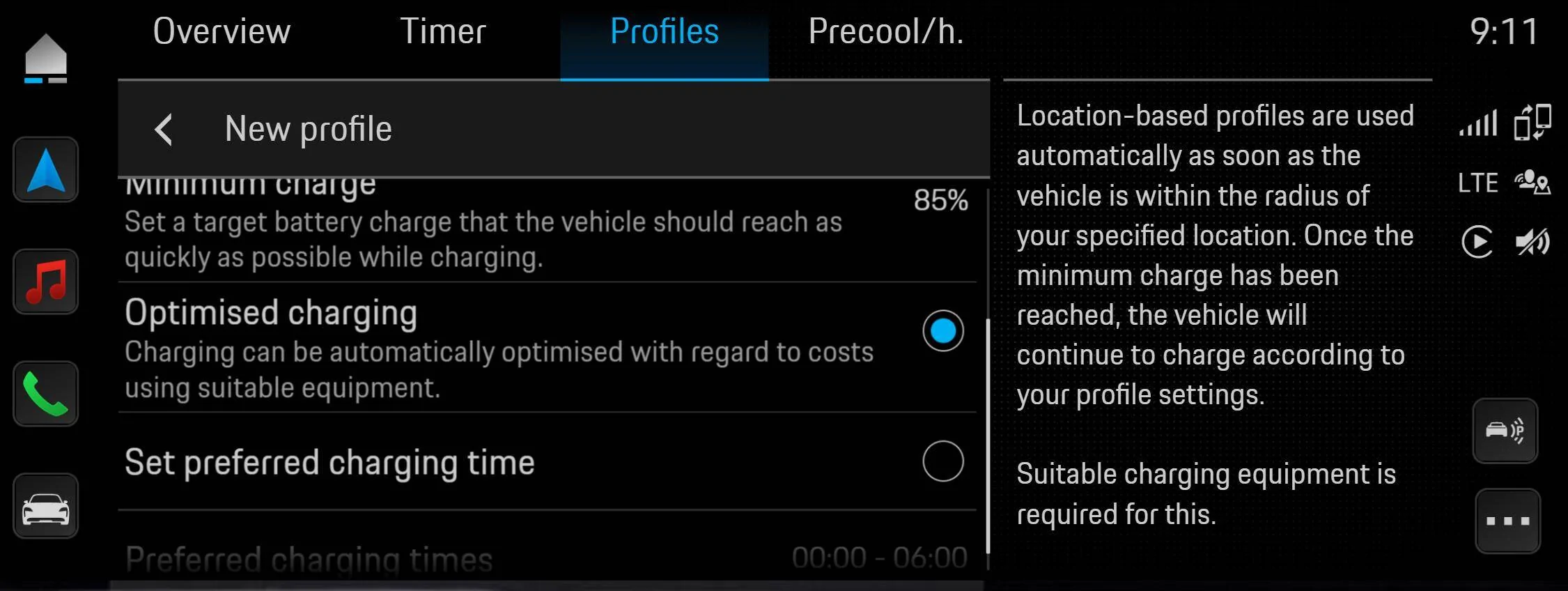

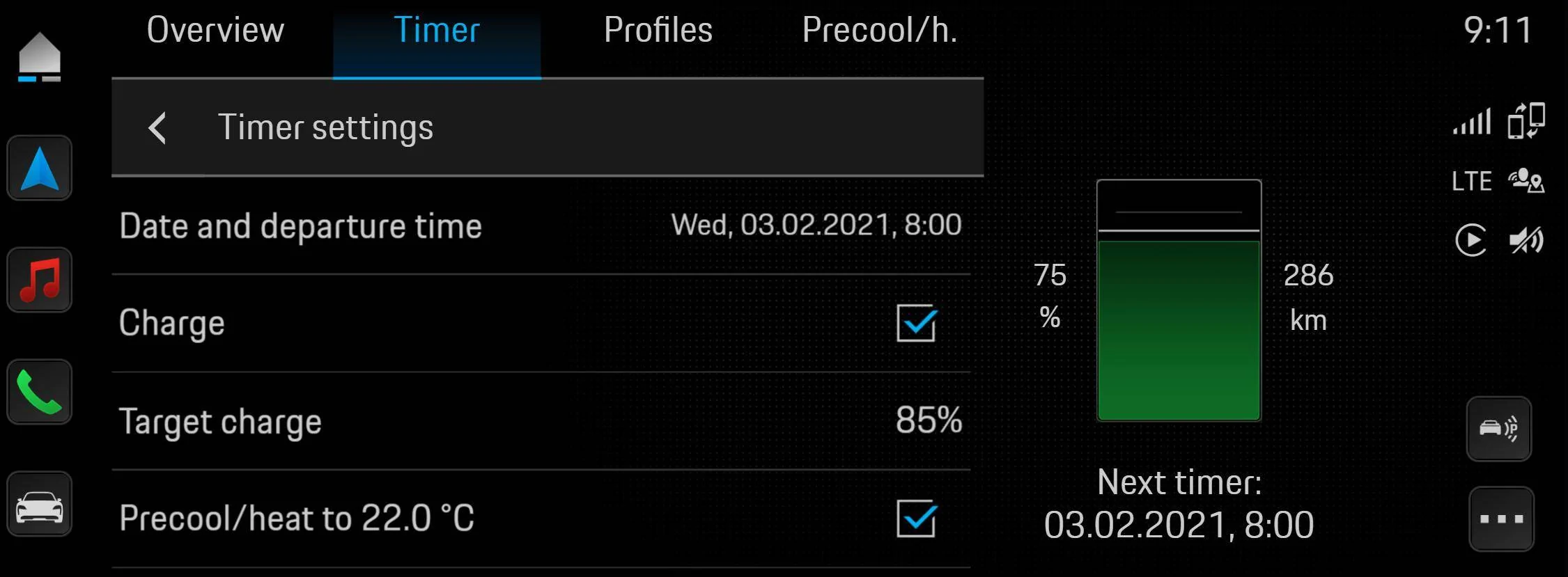

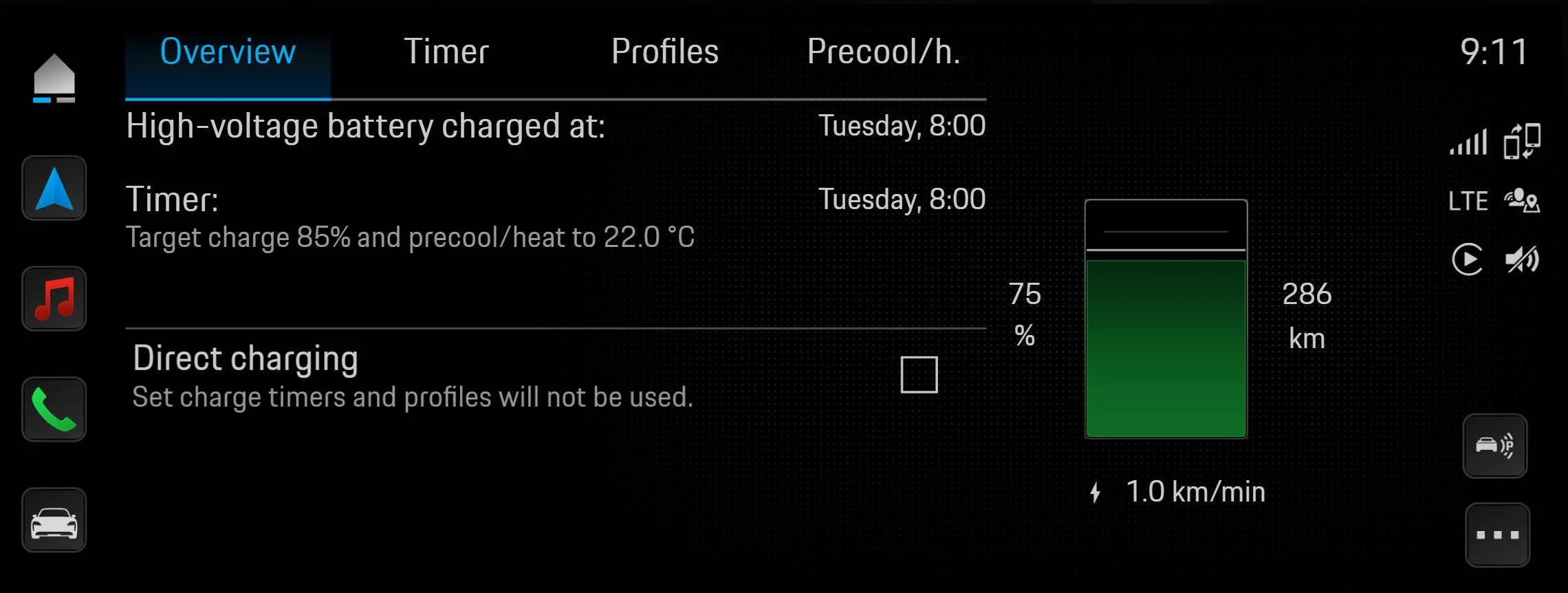

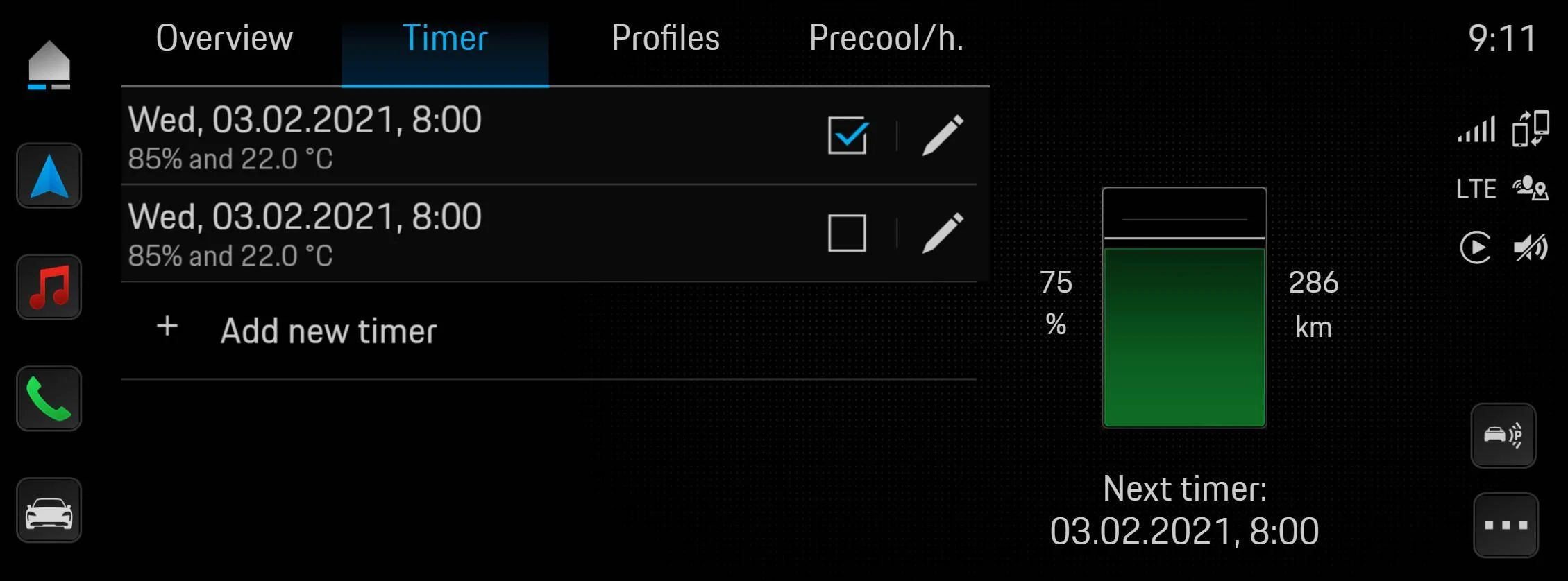

I don't know anything about the French legal aspects (@Scandinavian no doubt will).
The PMCC is not programmable.
The programming of charging sessions takes place on the mobile app 'My Porsche App' where you configure Timers and Profiles which are then sent automatically to the car. Remember that the charging (and charger) is controlled by the car and not the PMCC (or any EVSE for that matter on any EV).
Programming can also be performed on the PCM and whatever you set on the app is also visible in the PCM (and vice versa). These screen shots are from the app and the PCM just to give you an idea:
TImers:
Porsche Taycan Newbie question on home chargers 1664443090503
Porsche Taycan Newbie question on home chargers 1664443121227
Porsche Taycan Newbie question on home chargers 1664443150366
Porsche Taycan Newbie question on home chargers 1664443171778

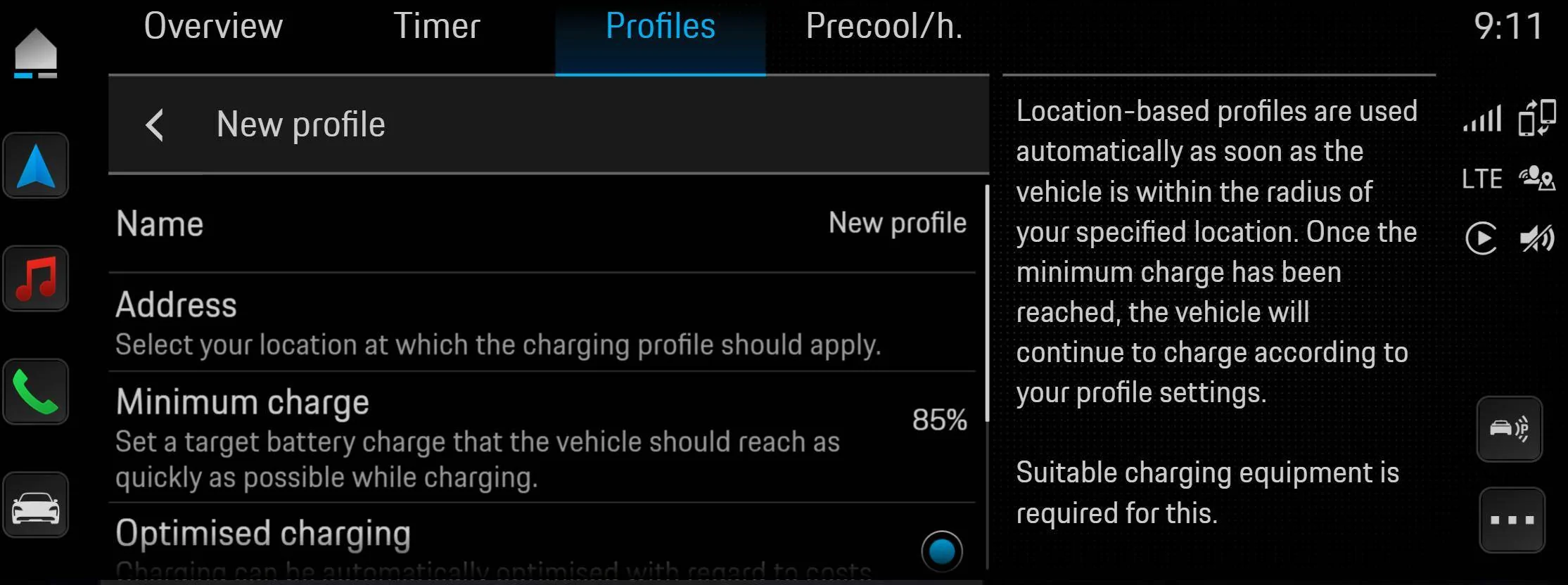

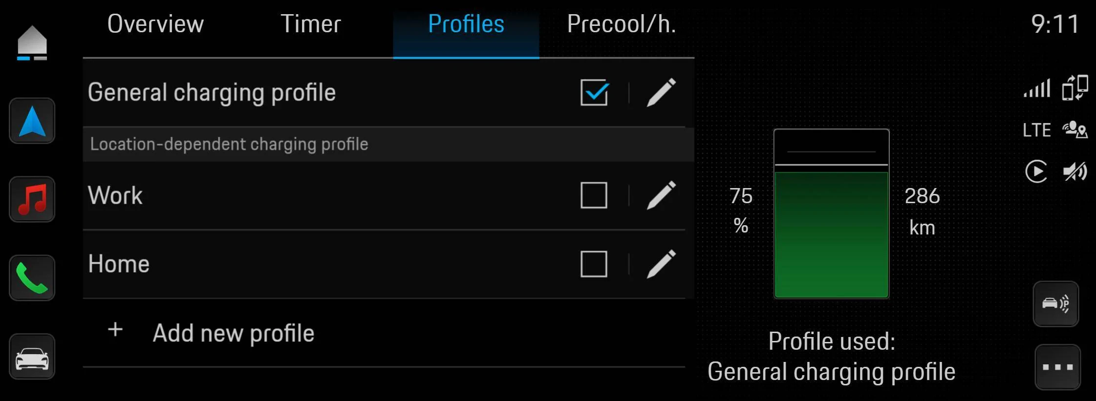

Profiles:
Porsche Taycan Newbie question on home chargers 1664443235816
Porsche Taycan Newbie question on home chargers 1664443291295
From the app (Timer):
From the app (Profile):
Porsche Taycan Newbie question on home chargers Profile - Preferred Charging Time

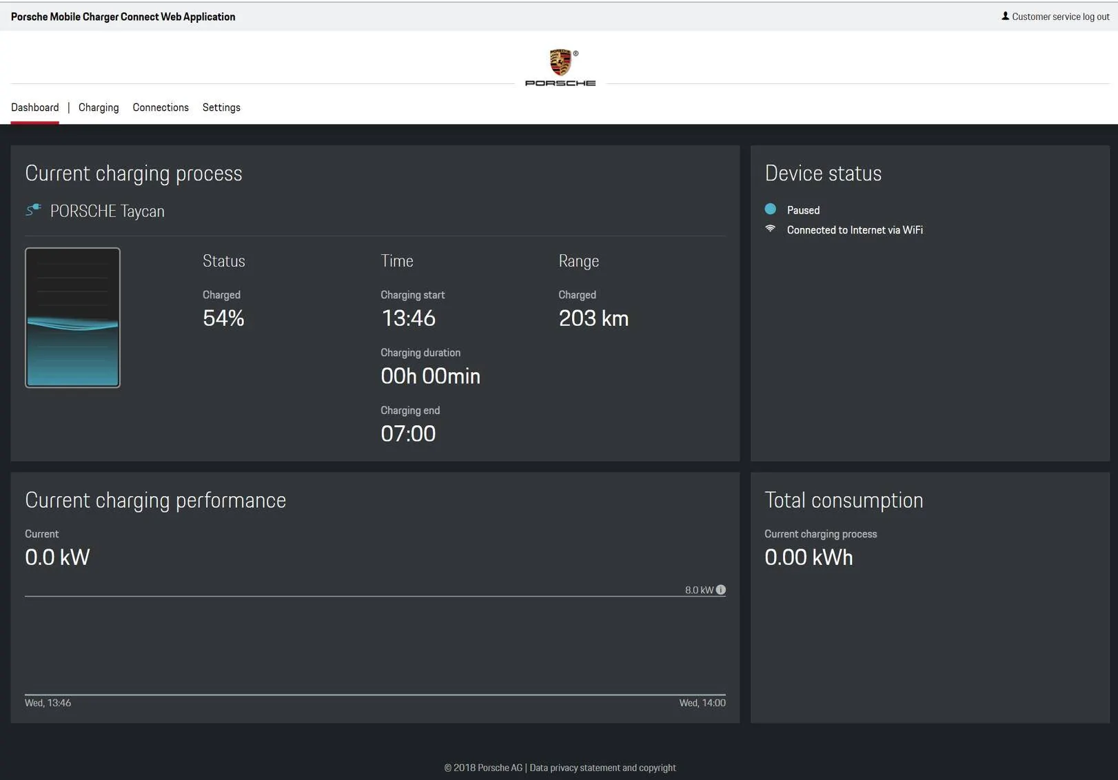

The PMCC has a touch panel for access to set security, amps, networking etc and displays the current charging session. All replicate from the web interface when either connected to you home WiFi or via a direct hotspot connection. You won't make much use of it in general but if on your network then charging stats are automatically uploaded to your My Porsche Connect website where you can view charging statistics.
I have the PMCC and rarely access the PMCC directly or via the interface. Setup once and then forget about it.
Sample PMCC display:
Porsche Taycan Newbie question on home chargers 1664444133686
TImers:
Profiles:

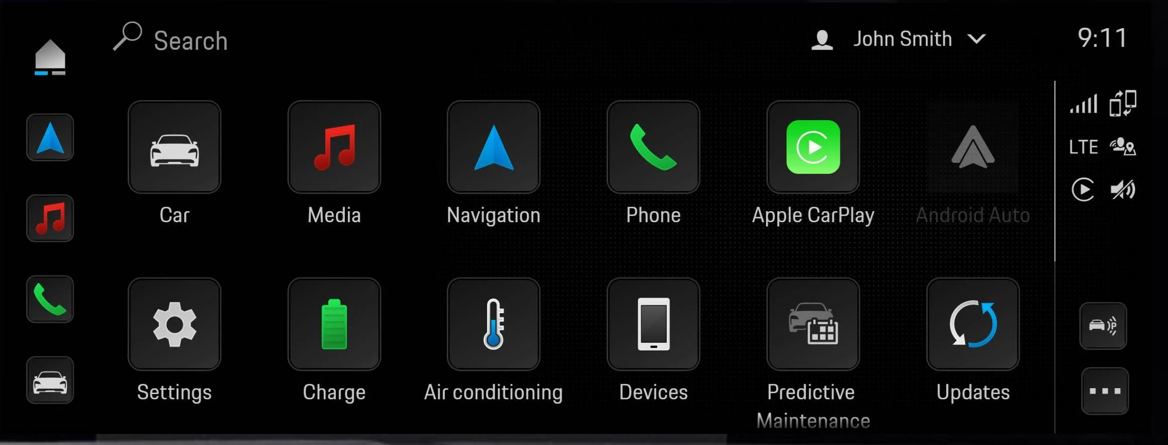

PCM = Porsche Communication Management - this is the 'heart' of the Taycan (and any model of Porsche for that matter) - sits in the central dash and is your main media / nav / AC / control for the car.
This is the Home screen of the PCM
Porsche Taycan Newbie question on home chargers 1664446031694
Have a play with the PCM Simulator to get familiar.
