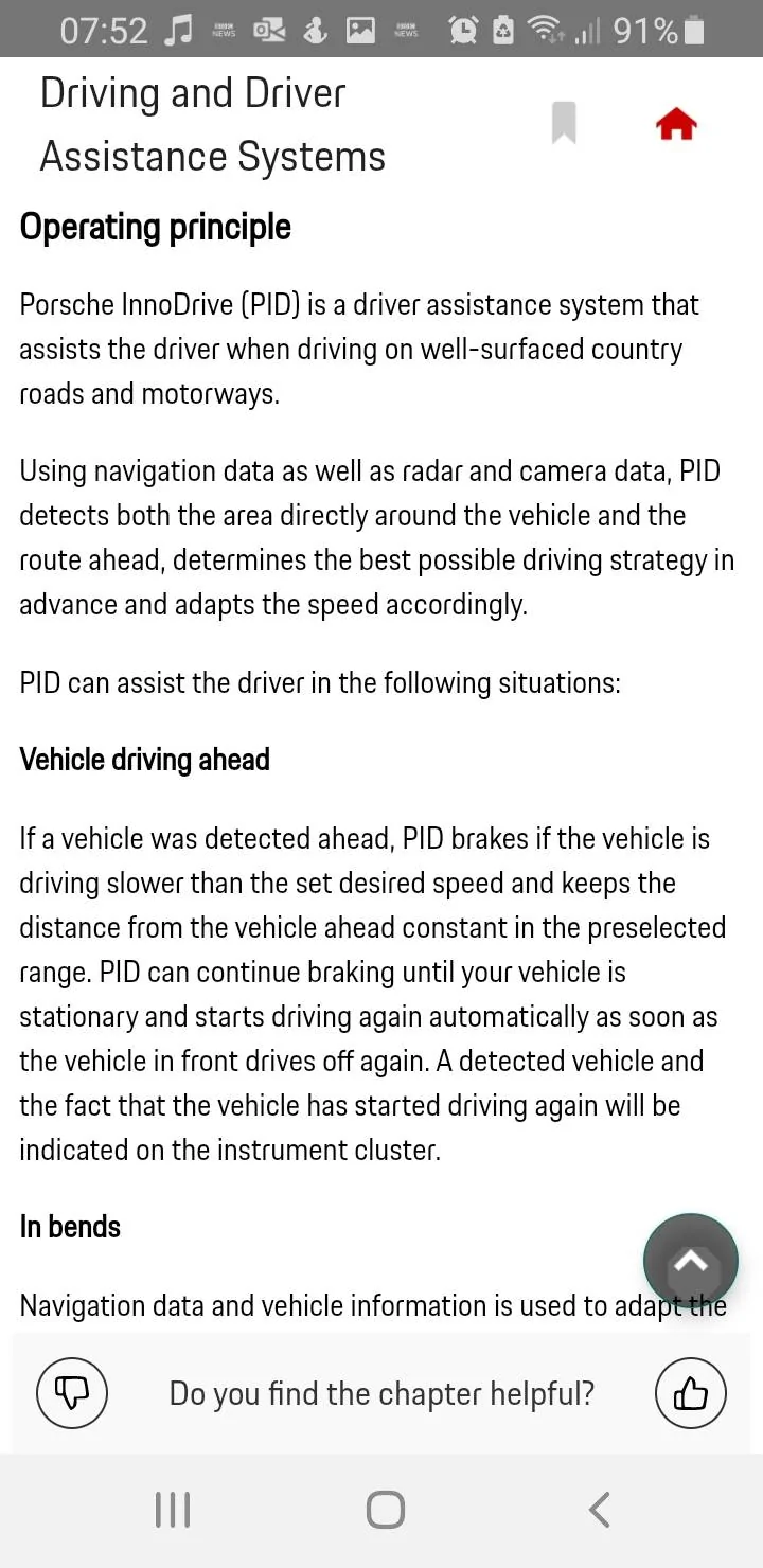

Context: This is my build spec:
http://www.porsche-code.com/PM5KQBL3
Questions and Clarifications:

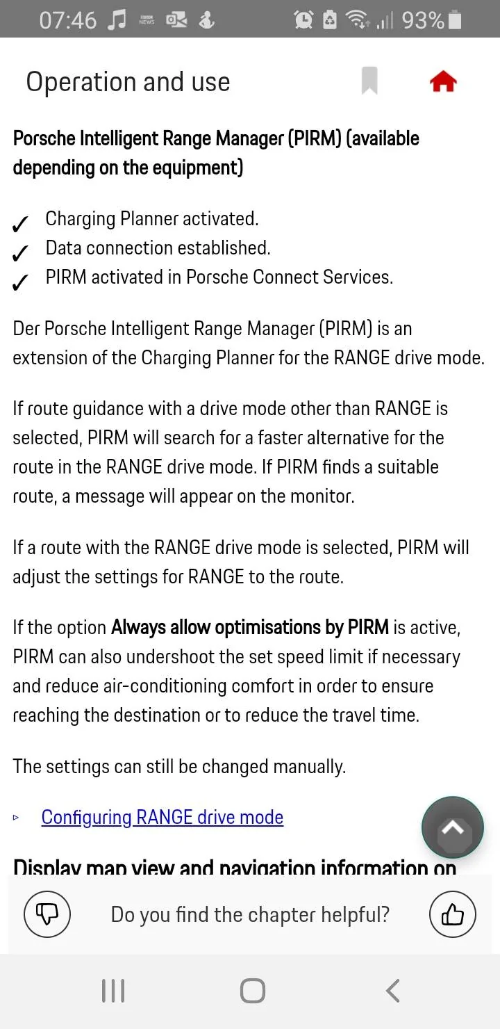

1. Will I get navigation from place to place including adding charge stops? Or does that require PIRM?

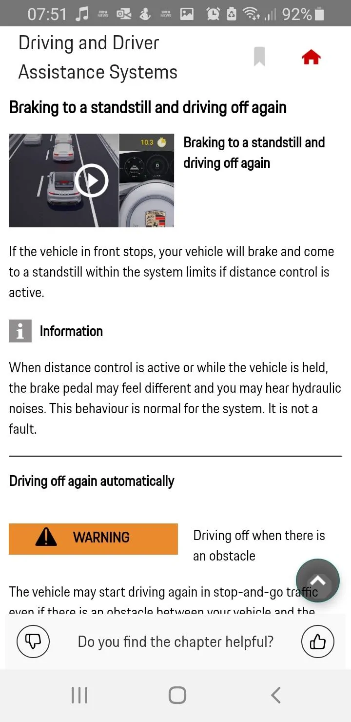

2. I believe the cruise control will maintain car distance, will it also start/stop in a bumper-to-bumper traffic scenario? Or does that require InnoDrive?
3. The lane change assist is just warnings when you run over a line, right? It does not autosteer unless Active Lane Keeping is added?
I am in general I am finding the descriptions for PIRM and InnoDrive somewhat vague and I'm not sure what the benefits are (or the tradeoffs of not having them.)
Are ALK, PRIM and InnoDrive all must-haves?
Thanks for the info and feedback.

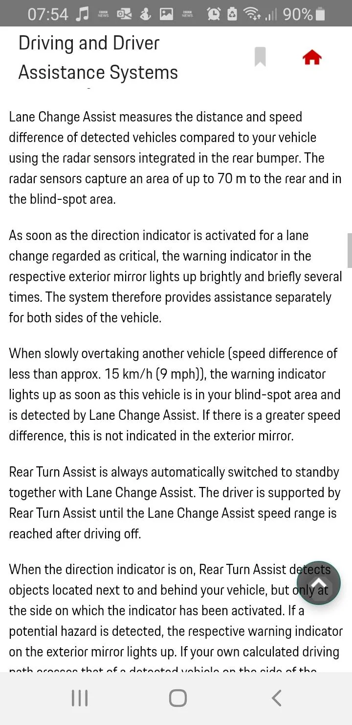

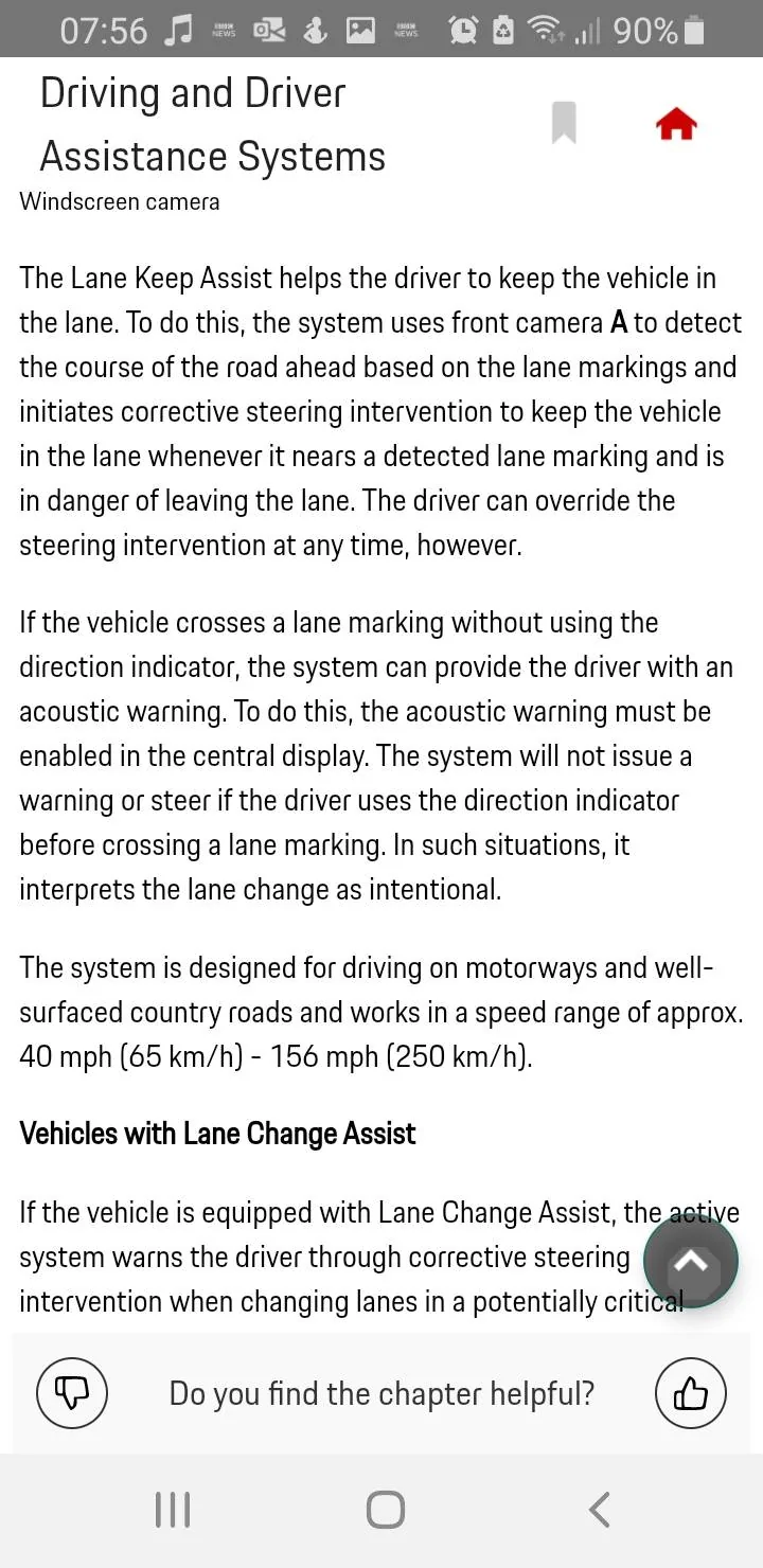

1. Nav - place to place yes, Charge Planner is std and PIRM (STD in UK) introduces some enhancements.
2. ACC will do stop start. Innodrive adds further enhancements.
3. See below.
Download Porsche Good To Know App and watch the videos to get comprehensive information.
