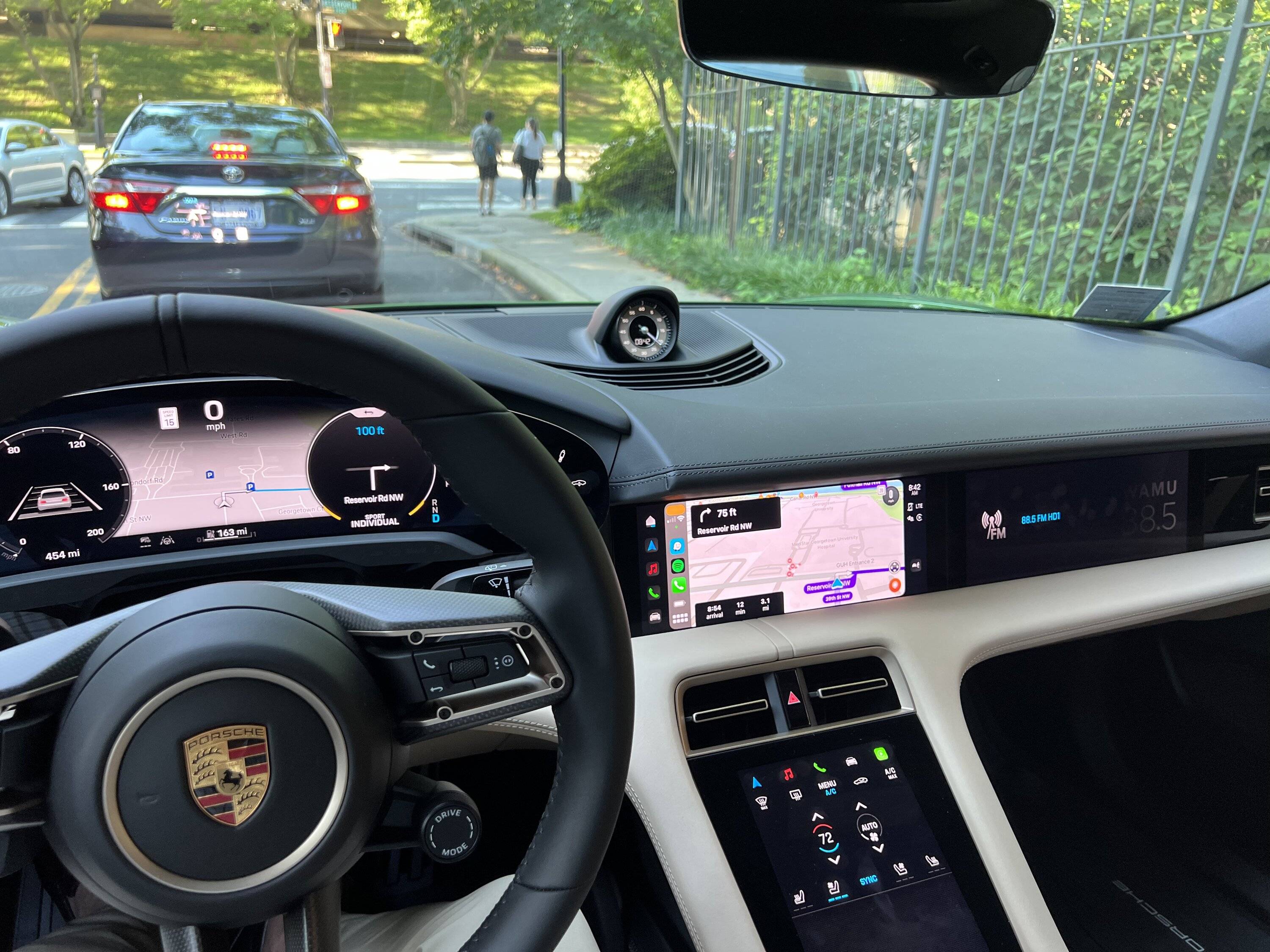

Visual Confirmation!
For what it’s worth, it works best if you put in destination in Waze on phone, get started with CarPlay, and then when you are on the way with good signal, hit the NAV button, put in destination, start, and then simply hit CarPlay button again once NAV has started.

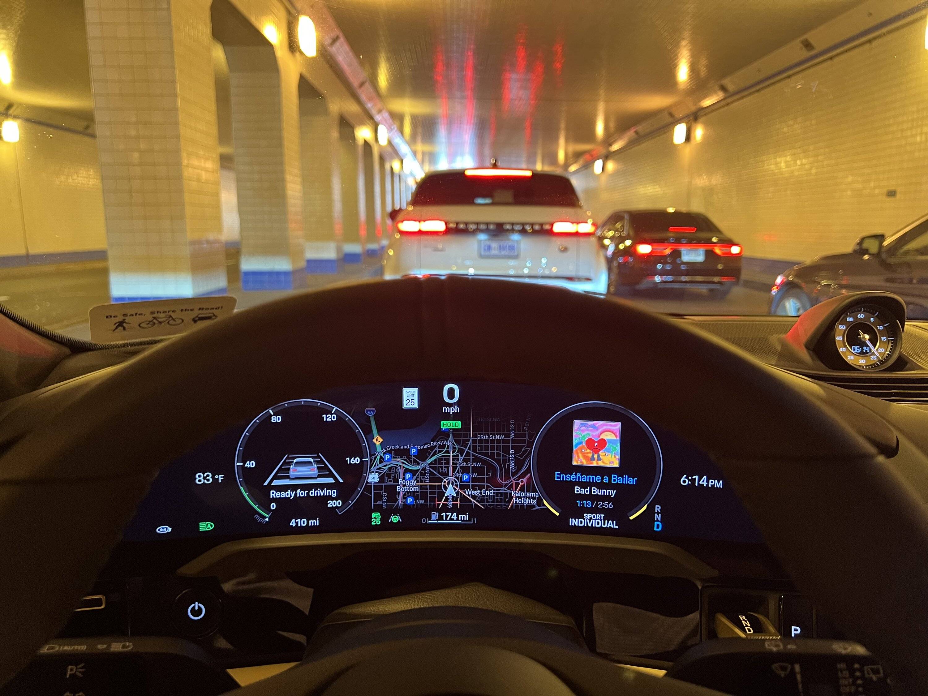

Ok, I paid attention to the steps I use and that work every time:
1. Open Waze on iPhone and get routing started before entering car.
2. Enter car and start CarPlay.
3. Start driving and get to point with good signal.
4. Hit Navigation icon on left of upper center screen.
5. Enter address (I usually have the address in the car already, so not sure whether manually entering address now would change anything).
6. Start Porsche Navigation
7. Hit CarPlay icon (and Waze should appear as before).

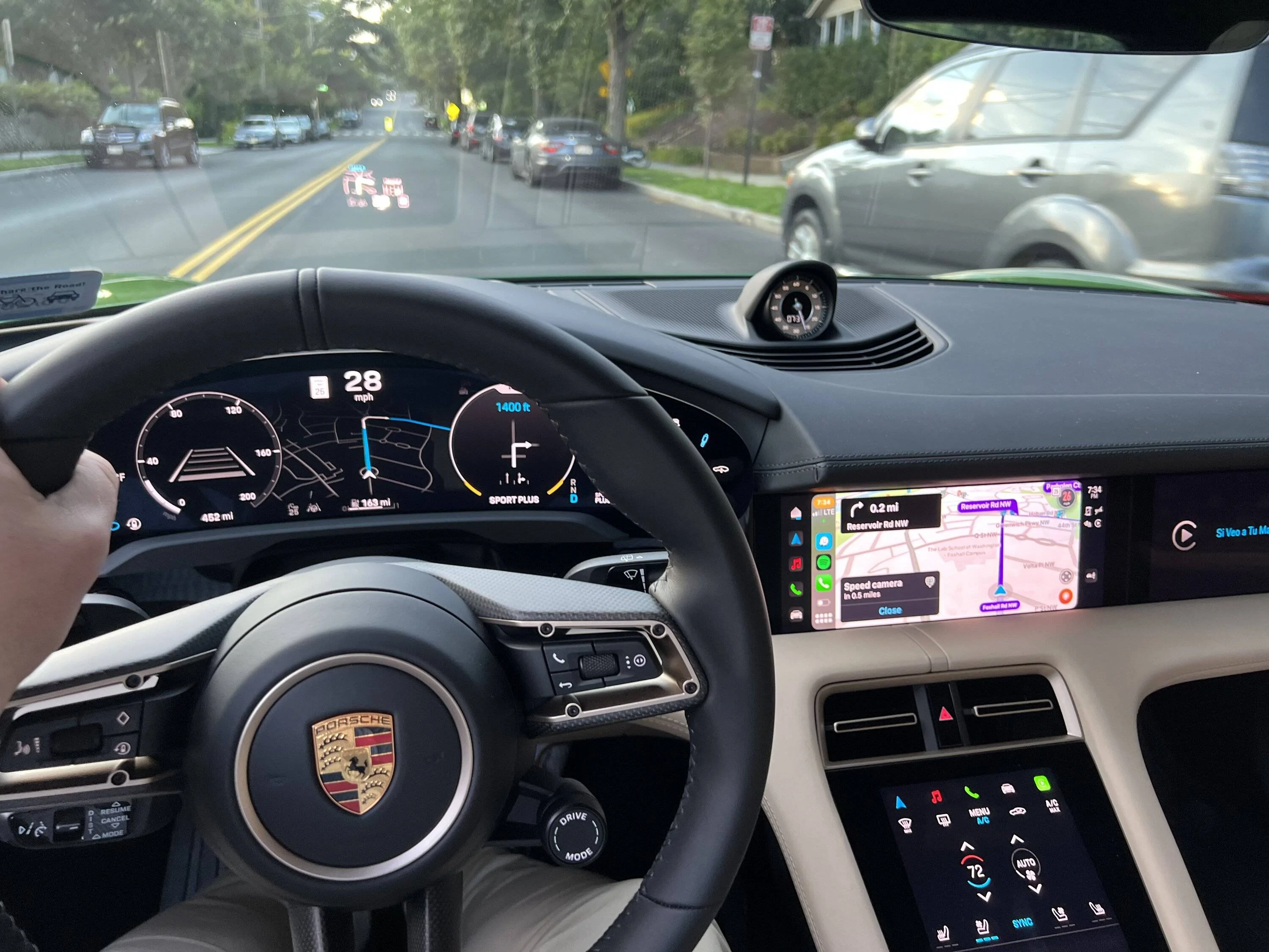

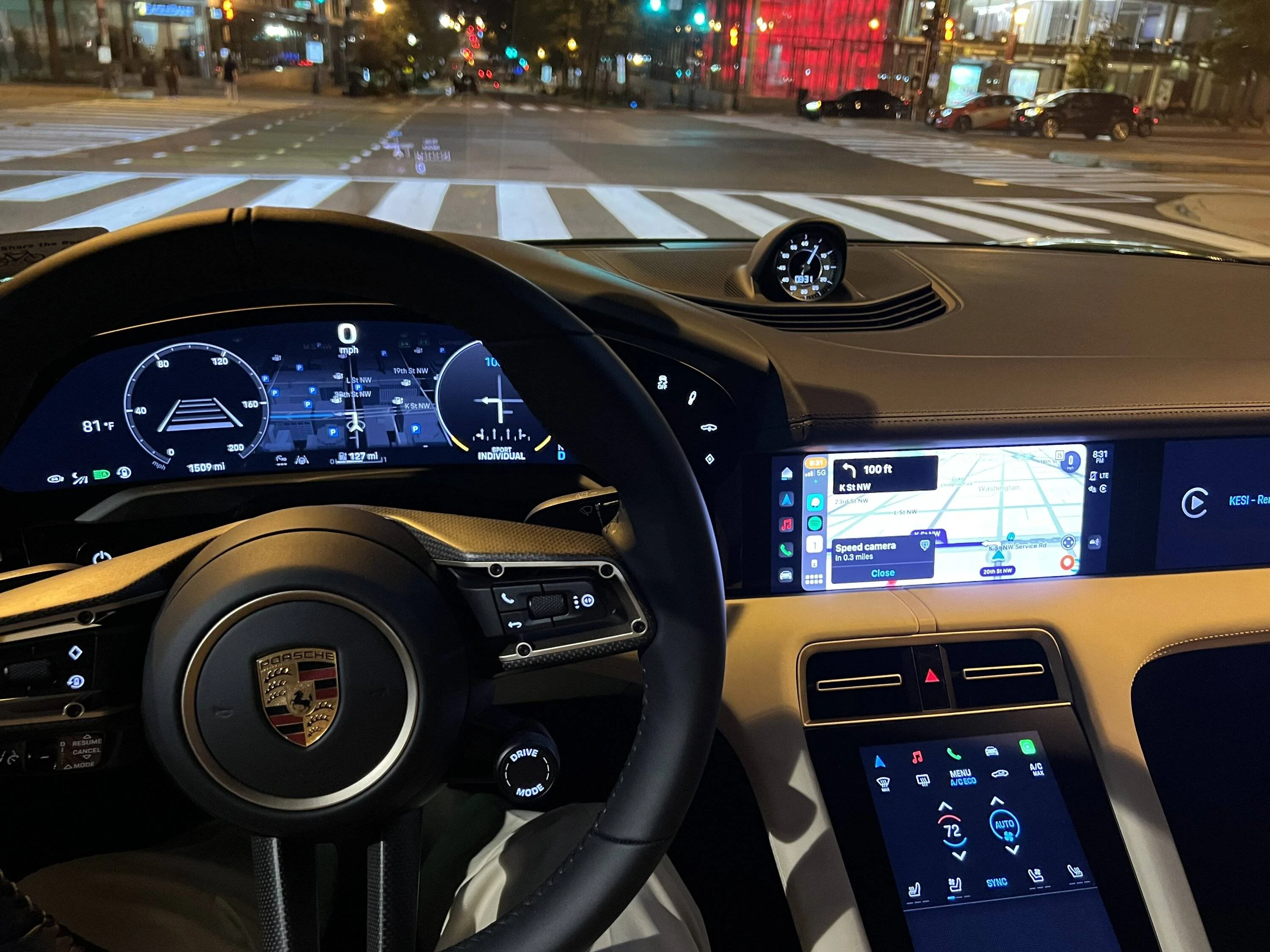

I have to admit that you all had me doubting myself, but no, it works every time. Here’s from tonight. Again, I think the key is to get on the road with one and then join the other rather than fussing with both right when you get in the car.
