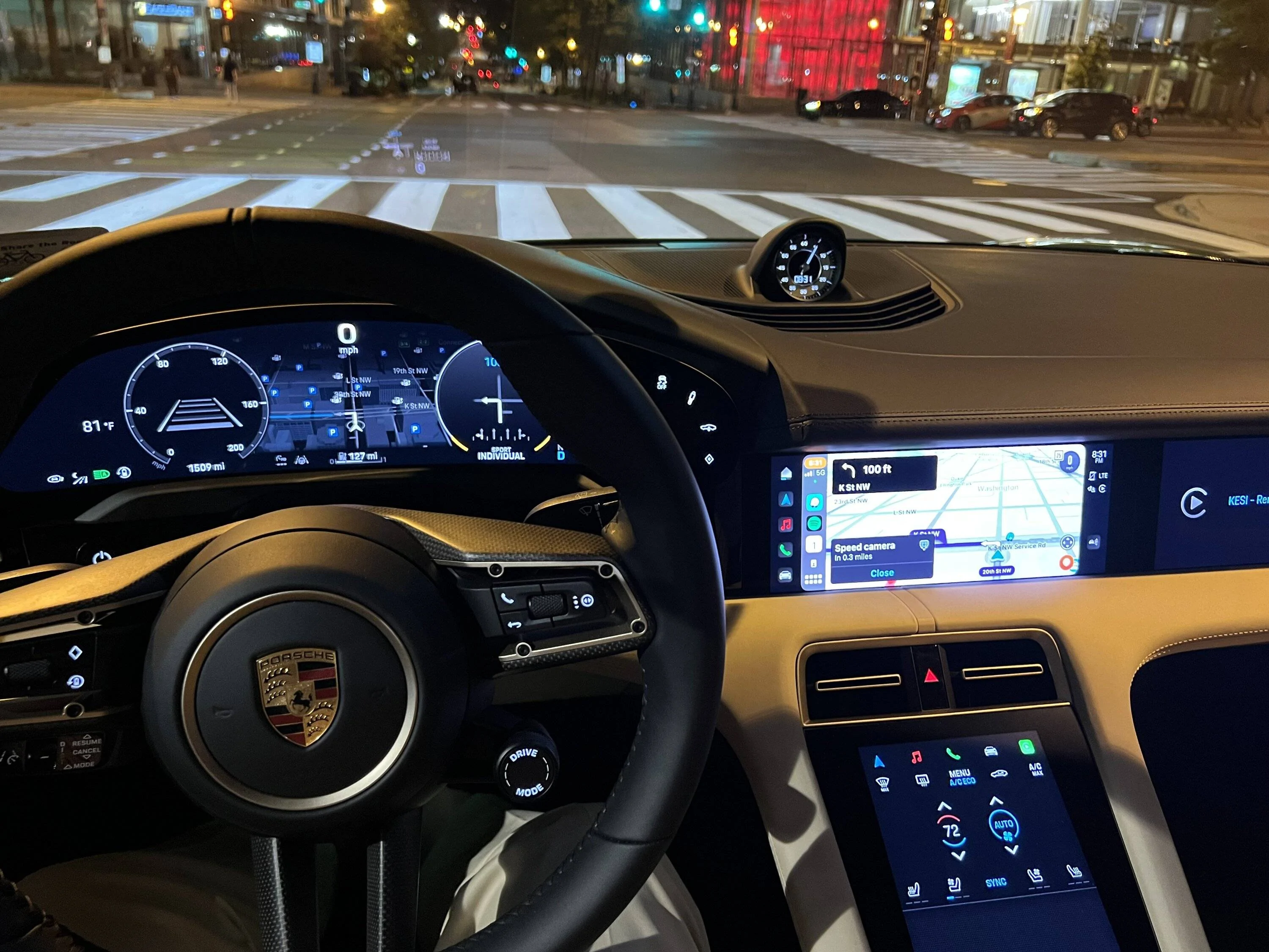

I can run Waze and Porsche nav at the same time too . . . If you look closely you can see Porsche NAV on HUD too

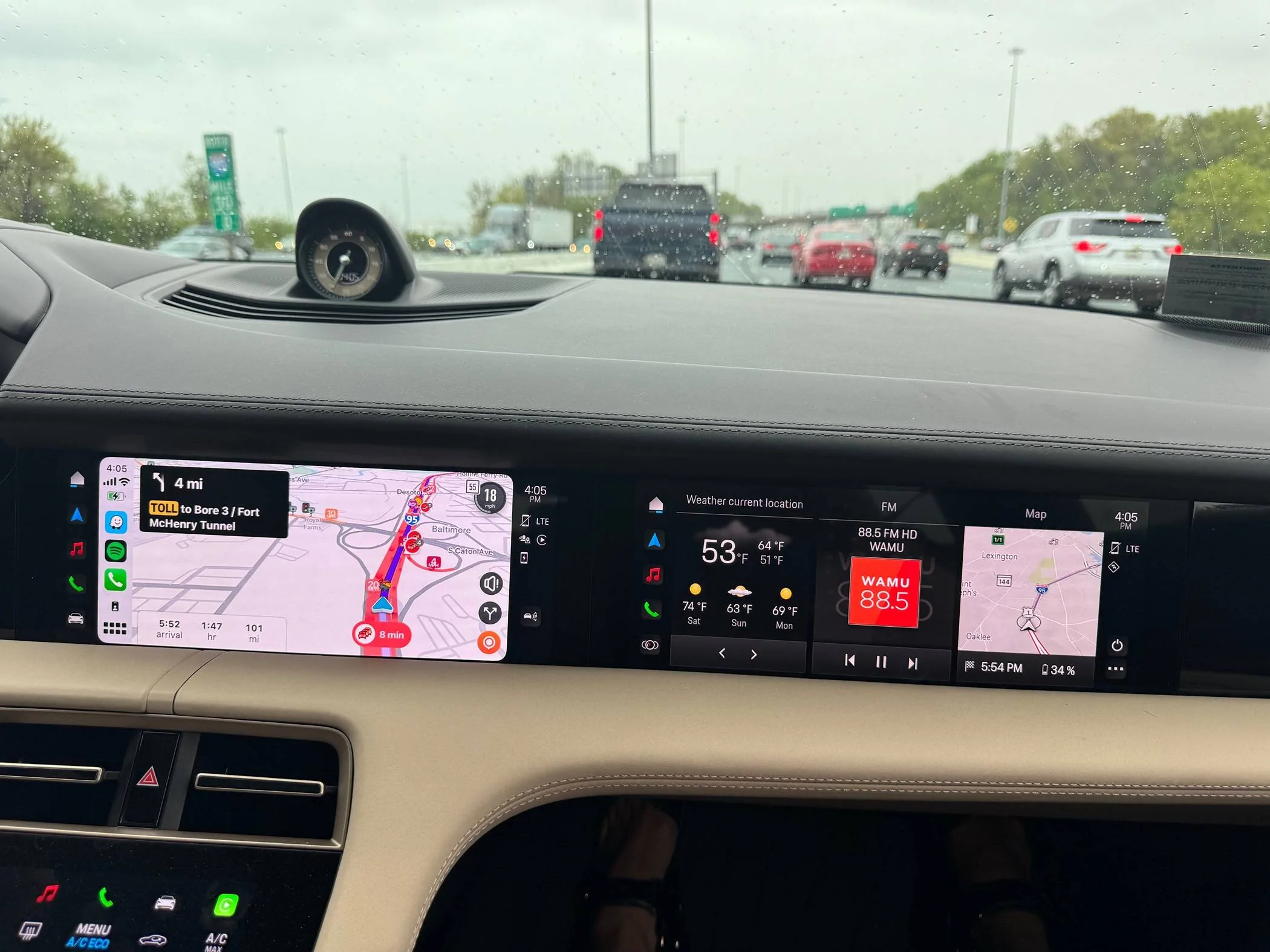

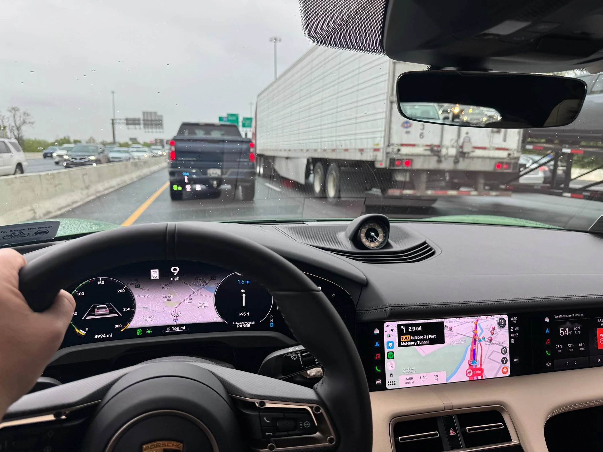

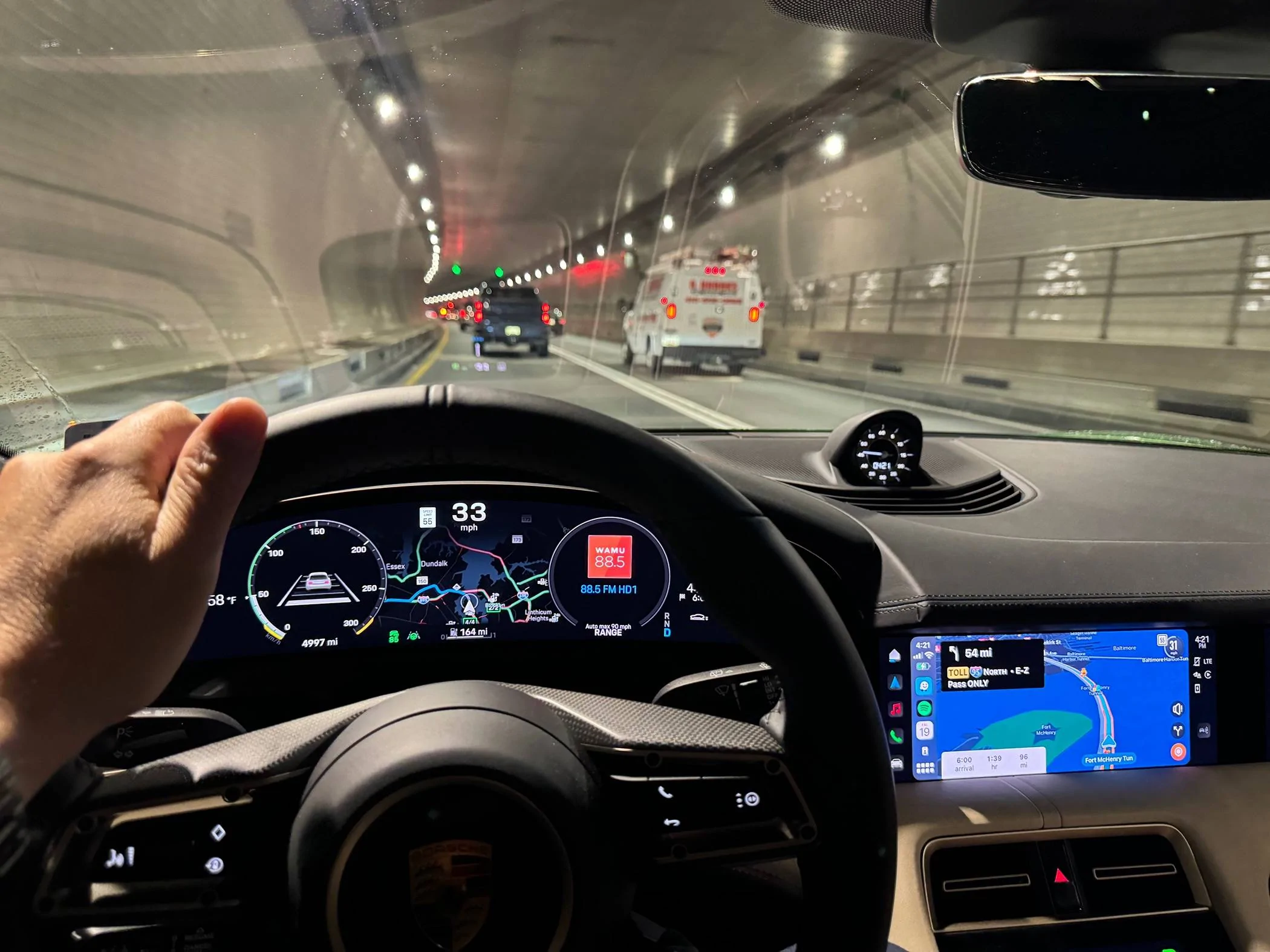

Just a quick update here. I have always been able to run PCM navigation and Waze navigation via CarPlay at the same time.
I am happy to report that recent updates to iOS, Waze, PCM (or a combination) had made it MUCH easier to run both at the same time in a very reliable way. Before, if some voice announcement came along, it could stop the PCM navigation. I'm happy to say that now both run very reliably at all times and you can easily switch back and forth between the two without either shutting off, or you can do as I do and display Waze on the center screen and the PCM navigation in the right tube and heads up display.
In the pictures, the difference are due to the fact that PCM calls splits in interstates "turns" while Waze just ignores them . . . It's hard to capture heads up display image, but if you look closely, you can see PCM guidance. Also, the PCM guidance is shown on passenger screen.
When no turns are near, the right tube shows the default setting, which in my case is media, but when you get closer to a required action, the right tube switches to navigation, which is less important to me personally because my heads up display shows navigation constantly.
Top picture shows PCM Nav in heads up display, default content for right tube because no action is near in the PCM Nav (in my case, default is Media), PCM nav map in center tube, and Waze via car play in main center display.
Middle picture shows PCM Nav in heads up display, PCM Nav in right tube since action is upcoming in PCM Nav, PCM nav map in center tube, and Waze via car play in main center display.
Bottom picture shows Waze via car play in main center display and PCM Nav map in right panel of passenger display.
Very happy with the new reliability
