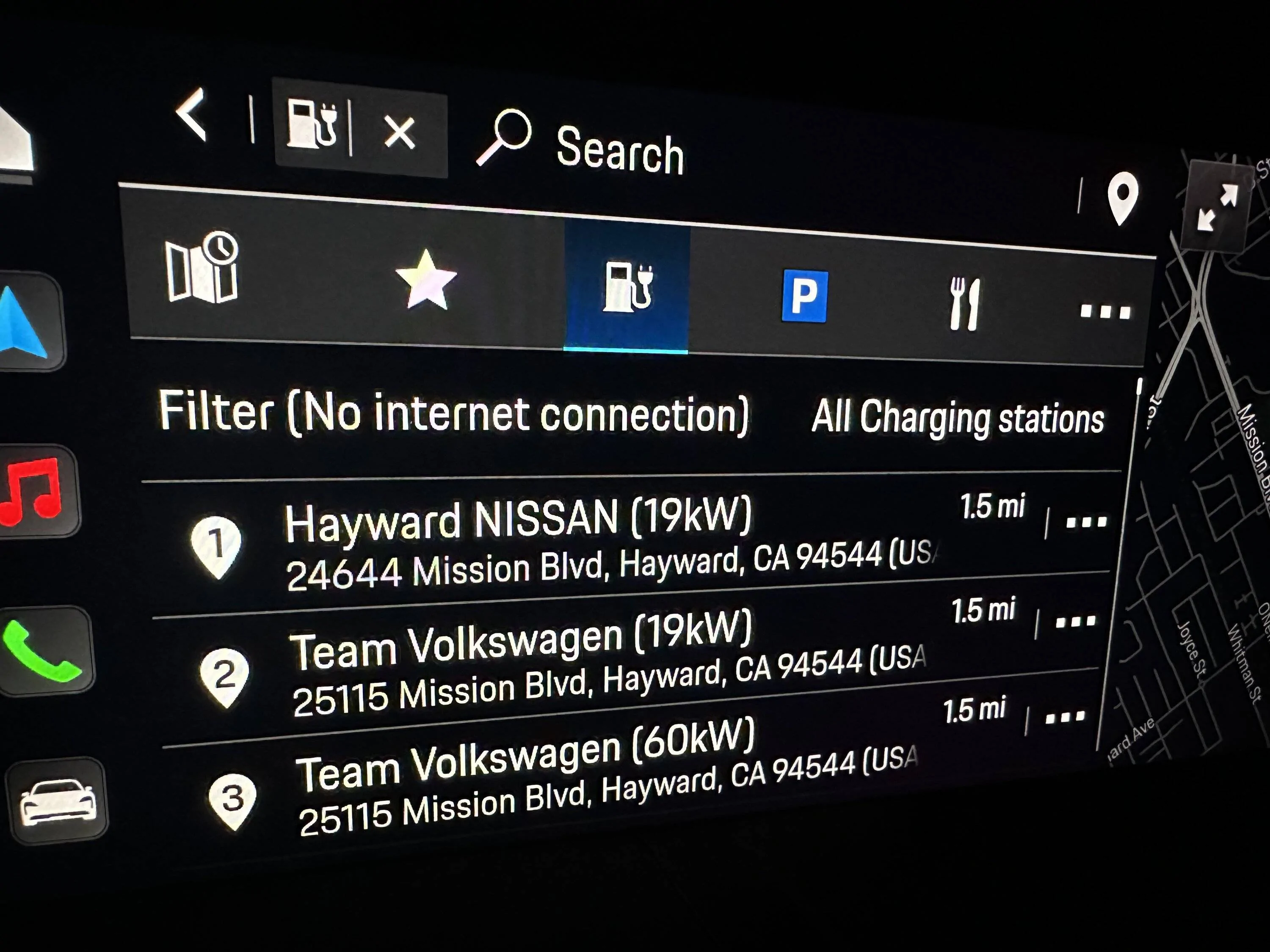

Hello everyone,
So navigation on my Taycan 4S doesn’t route using ev stations, any far destination I put it would say your charge will be negative ?.
Nav also says no internet connection when I’m trying to filter out stations, LTE is available.
My car equipped with Porsche intelligent range manager. Am I missing something?
Porsche Taycan Navigation with charging stations IMG_3728

This is another situation that we need more info from you.
If you bought it used, they disable Porsche Connect contract automatically.
You must have active Porshe Connect contract active to perform the features you are describing.

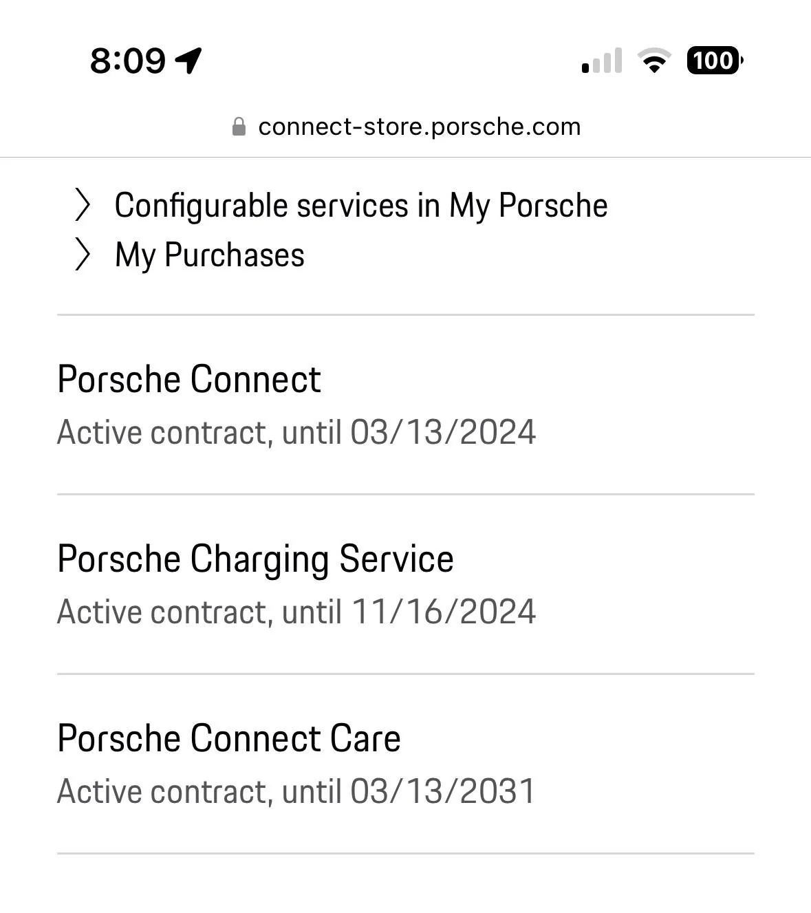

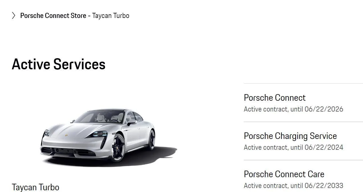

This is what you should see. Otherwise, I drove a loaner with these services turned off and had the same issues you are stating and then I could not get more than 50kW at at EA station I stopped on a multi-state 700 mile trip:

Checked just now. My Filter works as expected. However, there has been connection issues in the last 10 days. My best advice would be to start with log back out and then back into Porsche ID. Then check remote connection from app and car such as send and remove destinations, see if app connect to the car remotely, green circle.
