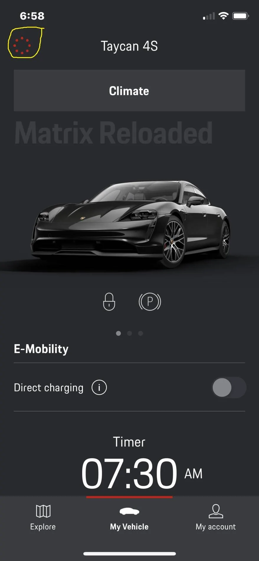

IT works for me - with a caveat. The Porsche Connect app gives you the start climate option, you press on it and the counter start ticking - which makes you think the climate is on. In fact, you have to wait until the connection circle is green - meaning there is a link to the car. Then turn climate on works. See below series of pictures showing just that
1. Connection not available (red dots at top left)
Porsche Taycan Connect App and Remote Control of Climate Control IMG_2408.PNG

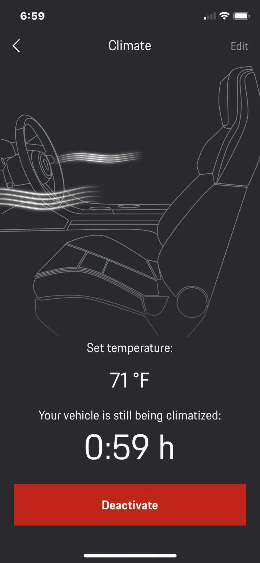

2. Software allows you to "start" climate even if connection is off. This does nothing....
Porsche Taycan Connect App and Remote Control of Climate Control IMG_2410.PNG

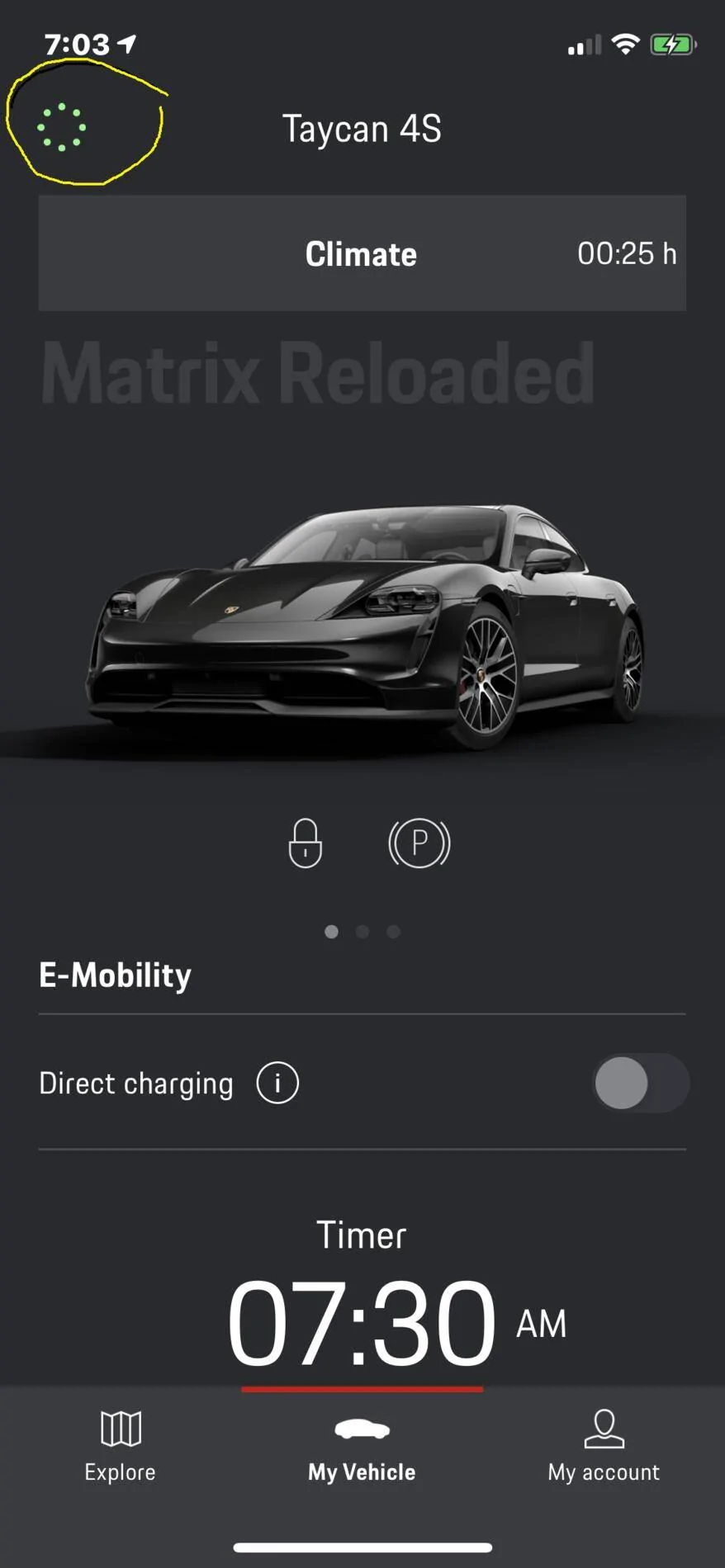

3. Wait longer until the dots are green - then climate will actually start if you activate it now. Coincidentally, if you click now climate, the software does not remember you actually "started" the thing minutes before.

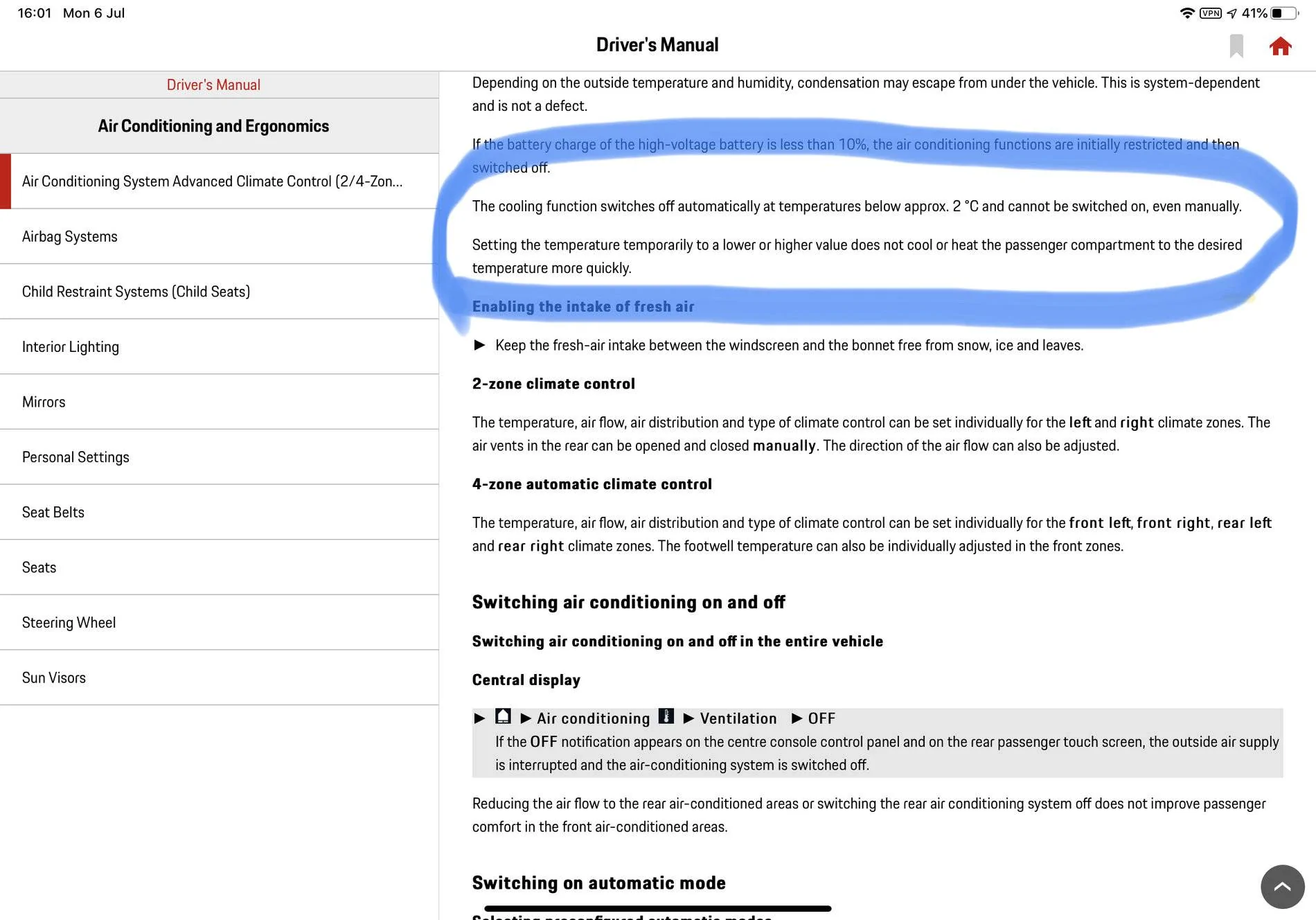

I will try tha5 as well, but I had been discouraged by the Good to Know app about that, see screenshot

Yeah I remember reading that line but based on my short experiences so far that does not seem to be the reality. However this is just a feeling based on playing around with the aircon when driving. Haven't used the precool yet. And as said with my other cars that has also always had an effect regardless of what the manual claims.
