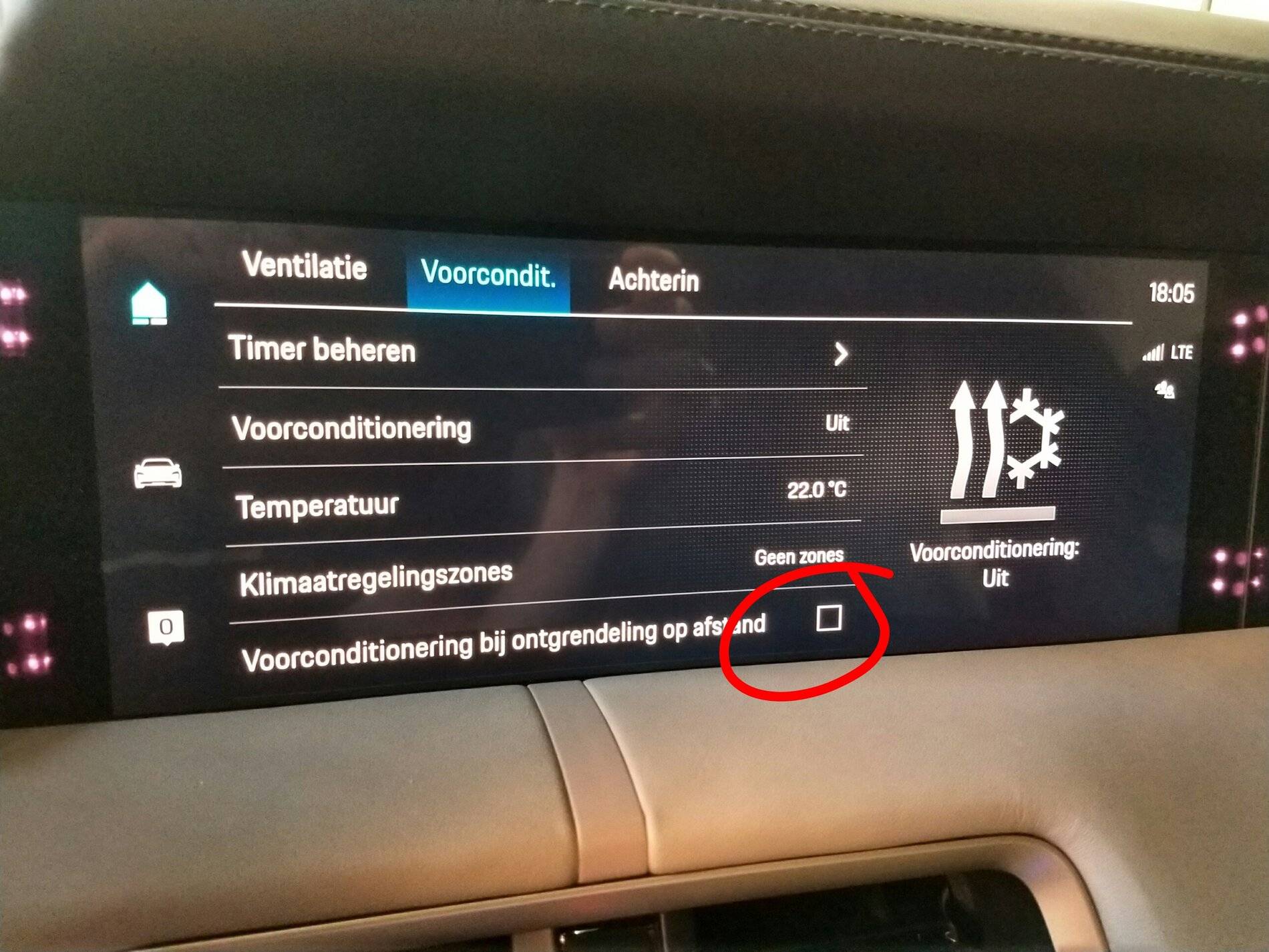

Ok, I may have found something.
Charging profile: 100% charge, time 14:30, temperature set to 22°C.
This time it worked like a charme.
What did I do?
1. Set airco to normal instead of ECO.
2. Checked the box (airco by remote set to on).
Porsche Taycan Connect App and Remote Control of Climate Control 2020-08-07_18.05.45
I unchecked it cuz of energy saving in the past.
Now it seems this one should be on, otherwise the airco doesn't cool the car, I think...
The airco remembered the setting in Normal mode (ECO off).
I'll do some more testing but at least it works properly now! :)
