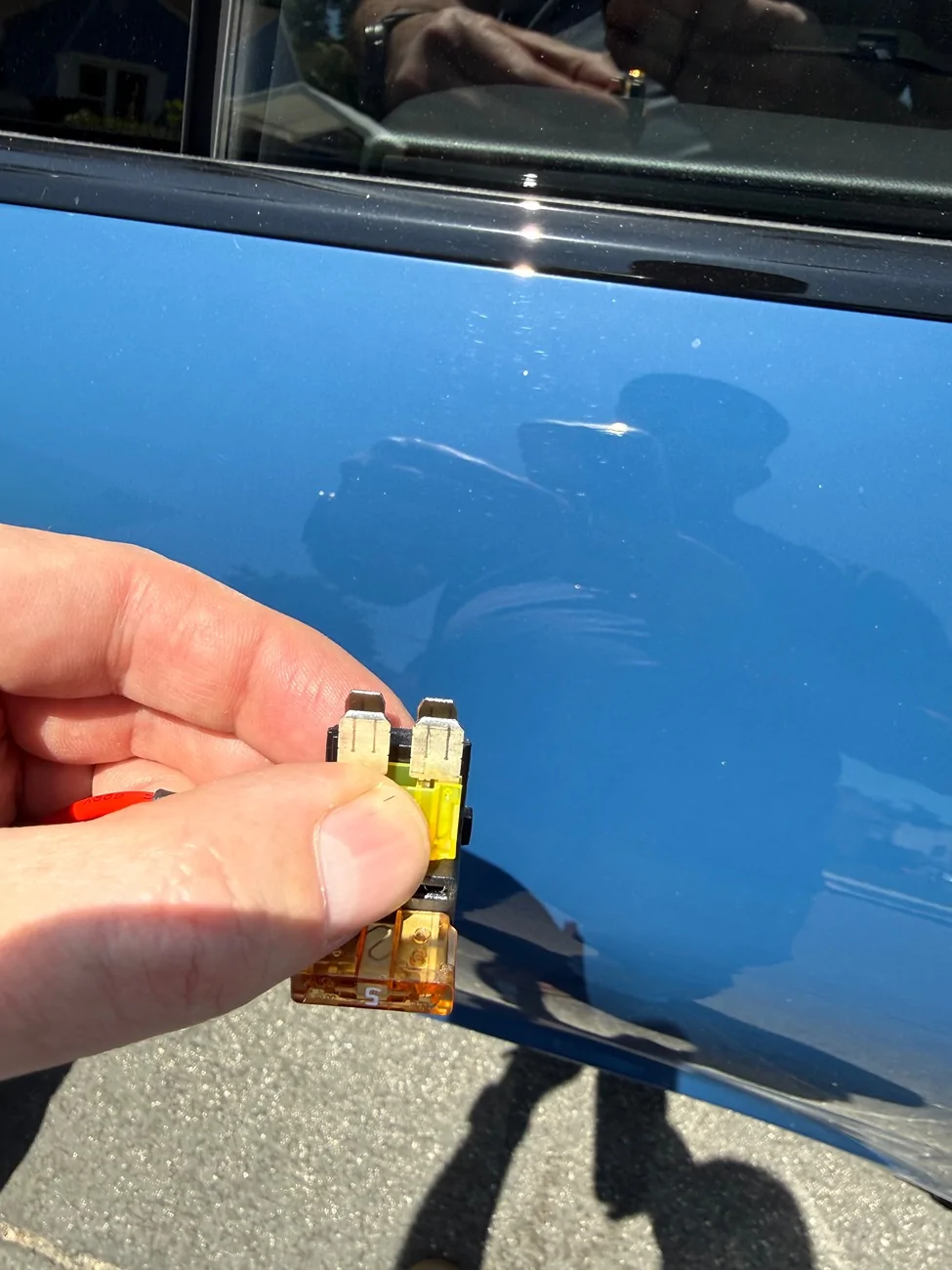

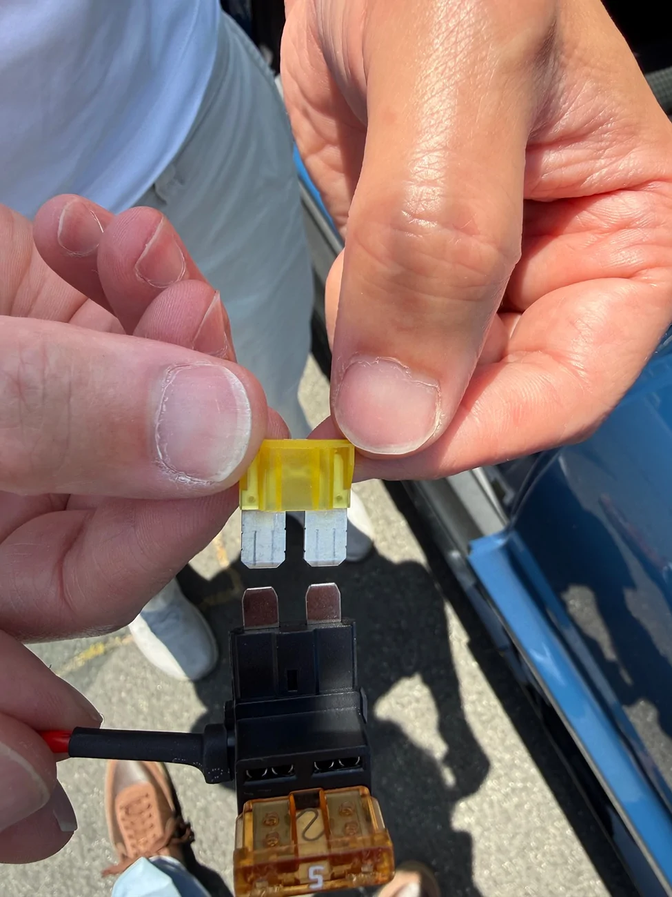

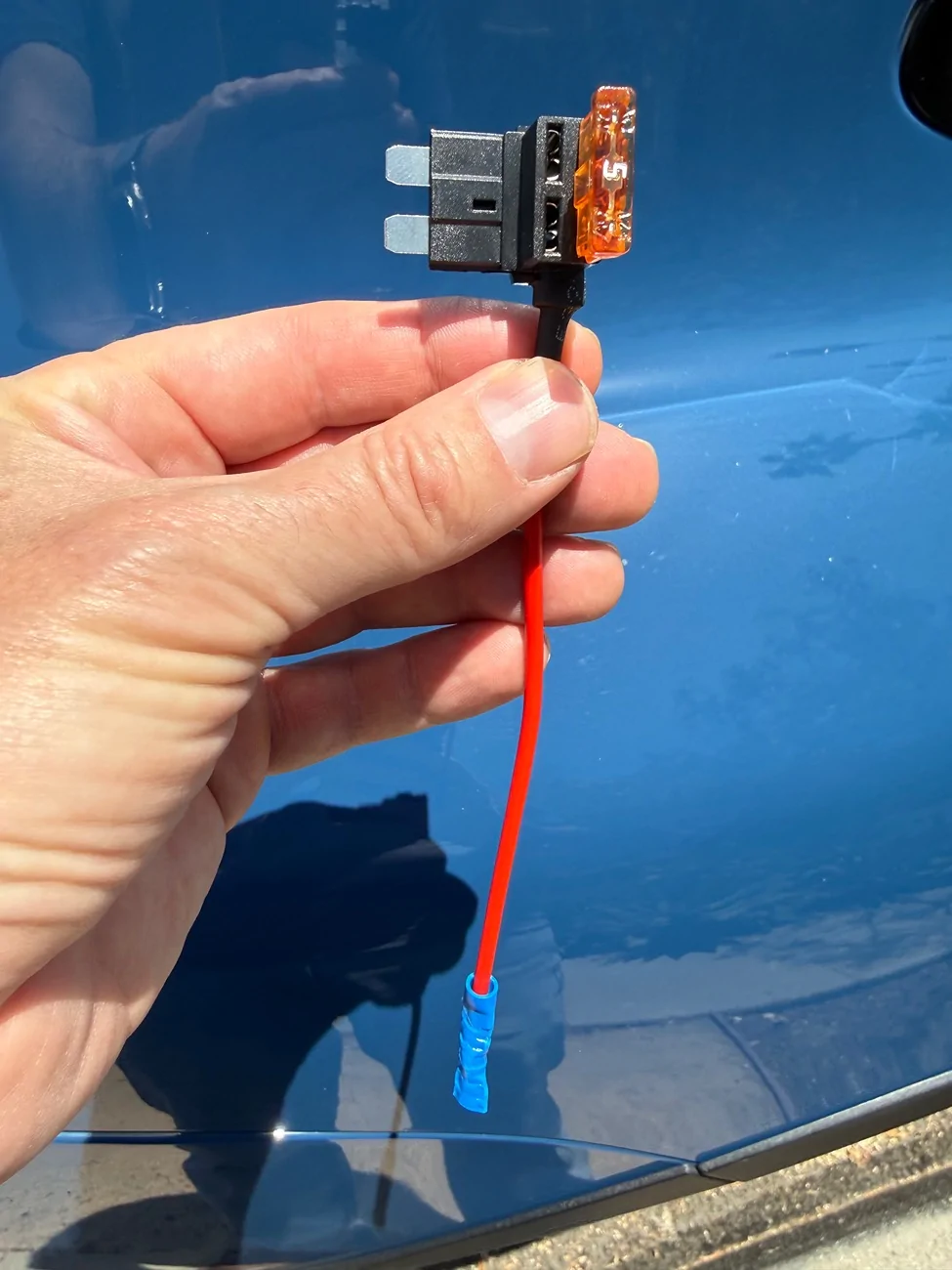

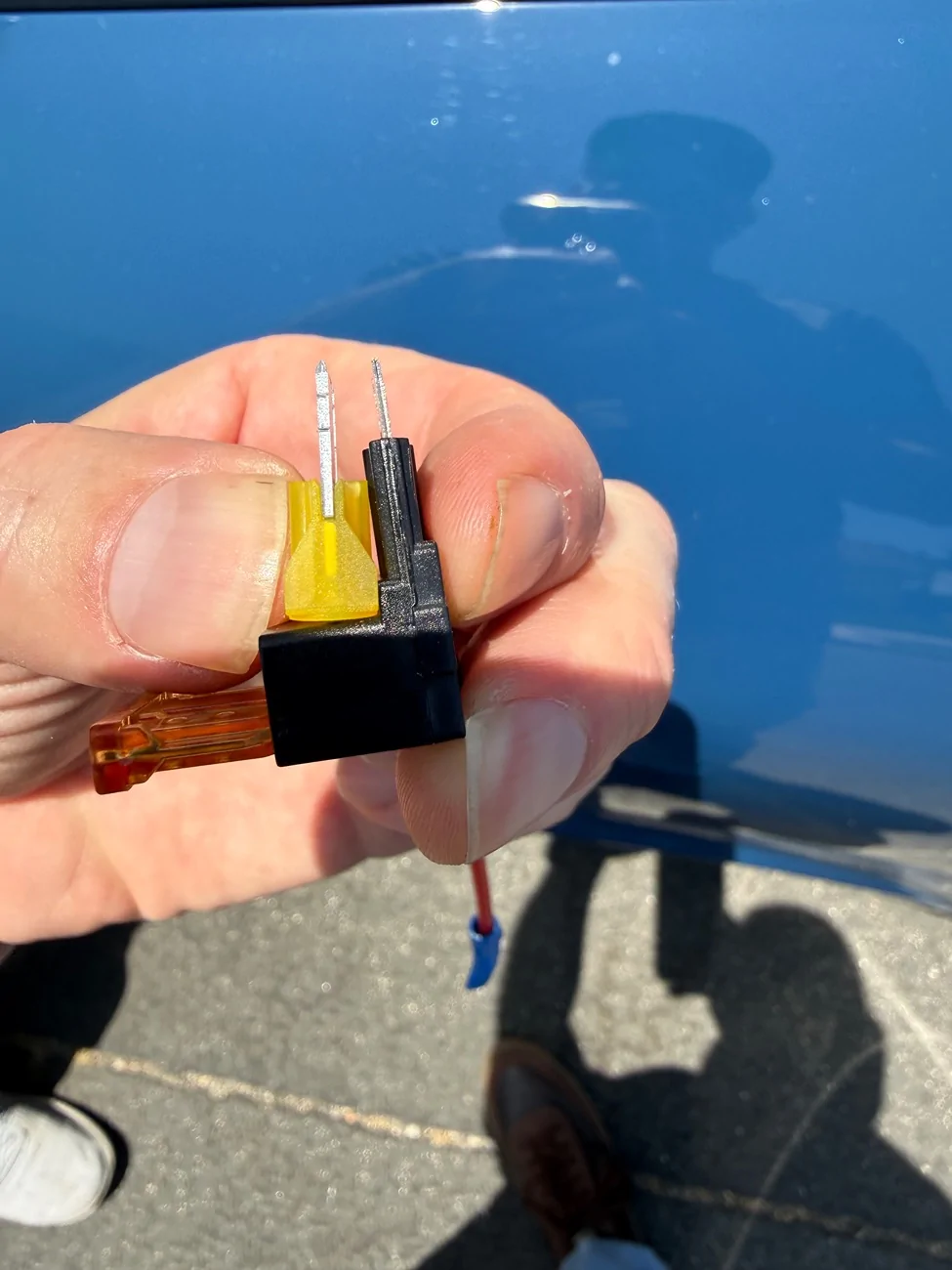

Hello, my installer, Rich, couldn't fit his standard sized tap into the fuse box to power my Thinkware Dashcam. Does anyone know whether this fuse box uses a proprietary sized fuse? How did others do this?

That yellow fuse looks like a maxi compact ... porsche uses the standard ATO sized ones
the add-a-fuse with the orange 5 fuse in the pic looks correct.
Yes, but it didn’t fit. That’s why I’m asking.

Did that yellow fuse come out of the taycan?
The 3 bottom rows of the fuse box near the pedals are all standard fuses
usually when people add stuff, it's done there
