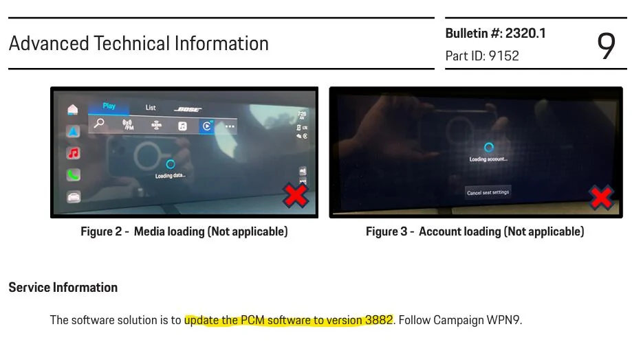

Not OTA, no. Installed by dealers; there is no update campaign, it’s installed only if a customer complains about connectivity problems, porsche logo freeze, etc
There is a TSB about it; will look for it later when I can - the remedy of the TSB is to update to 3885 2020-2024 cars
In earlier version of same TSB in Feb. 2024, the solution for Porsche logo freeze was to update to 3882. ;)
