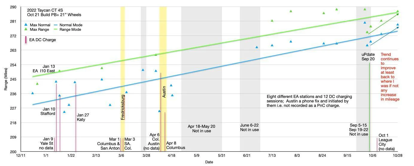

Well latest at home charging has brought my car back to where it was pre-uPdate in respect 'predicted' range in Normal/Range mode with AC off. Have seen a continuous improvement trend since drop post-uPdate but have not actually gained any addl. range - as before though, I am quite happy with these ranges being upper end of my original purchase expectations.

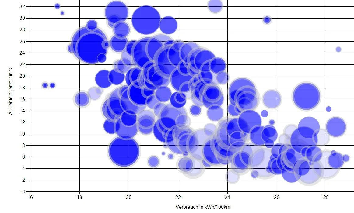

you are actually showing the relationship between consumption and temperature, aren't you?
these are 436 Taycan short term trips > 5 km ("trip since" )from a total of 535 trips of 22600 km of the last 22 months showing the correlation of temp and consumption but may be less than expected. The size (area) of the dots is reflecting the distance of each trip
I don’t believe so as, as I mentioned in a previous response, temperatures here in Texas have actually being unusually stable (read hot/warm) throughout this period and the return to my max predicted ranges from a definite drop immed post uPdate has occurred with near identical trip distances pre and post update.
The only possible difference again is slight cooling/drying trend here (nothing close to what you’d classify as cold) that ought to at some point impact range I.e. considered maybe the fact I got my ‘old’ range back might argue for post-uPdate ‘improved’ range in slightly cooler temps but I’m not buying it as simply too hot here still and that data in the noise!

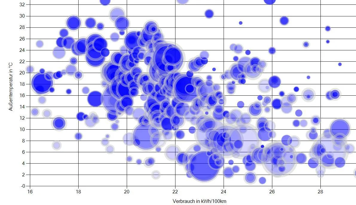

Any number of things - if still in it's first 6 months then ranges improve, if comparing seasonal changes they differ, if driving lots of short inefficient in-city trips followed by one or more efficient long trips your guessometer will come up with all sorts of changes :)
Here is the GoM values for my car after every charge over nearly 2 years - the most interesting perhaps the seasonal variability but also the impact of declining SoH!
Porsche Taycan Latest Taycan Software Update Findings and Reviews Thread Screenshot 2023-09-07 at 8.32.57 AM
