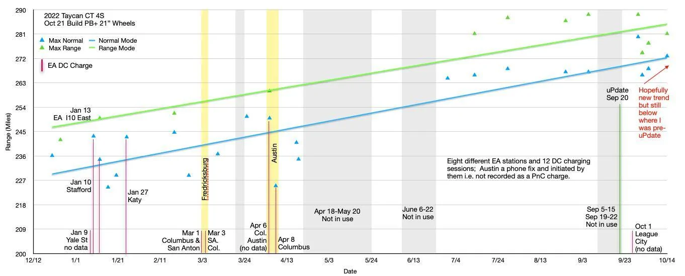

No idea what month you build was (or if Sedan vs CT and whether or not with PB+) but might your car be still in a 'learning' or conditioning state re the predicted battery ranges?
It took my car (build Oct 2021) a full 4-6 months to lose the 'scatter' in my charging max. range predictions (plotted for both Normal and Range mode with AC off - see chart in last post) before predicted range in Normal mode with no AC settled to around 265 mile max range at 100% but with an equivalent Range mode prediction at 100% SoC with no AC of 280-290 miles of range.
Not sure the build month but it is a 2021 I purchased in June 2021. The max battery prediction before the update was around 242 under the same conditions. I have the performance battery not the performance plus.
11,064
6,846
Amazing range estimate - makes a joke of PB+ in UK and Europe!

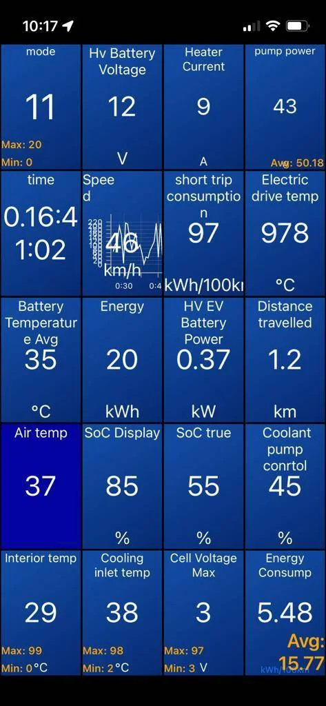

When i start the car (few hours later), estimated range 355km only….and after few hundreds meters, SoC dropped to 97%.
Usually, I spent 10% of SoC from work to home, today i spent 12%.
Outside temp: 19-20C.
using CarScanner App+OBD will help you to understand what's going on by e.g. showing the insane amount of energy the HV heater is eating and more.
Did you try it and post some results?
3,907
3,552
Interesting that you found that.
Can you share where I can see that HV heater consumption. I have not found this so far.
Thx, but I don't have OBD.

heater current is HV heater in HV Amps.
here is a demo shot with random values.
Porsche Taycan Latest Taycan Software Update Findings and Reviews Thread 1666081148711
this is my main view of the 5-pages dashboard I use and the config file is attached.
OBD device is only ~20-30 bucks and Amazon next day, check the forum search.
