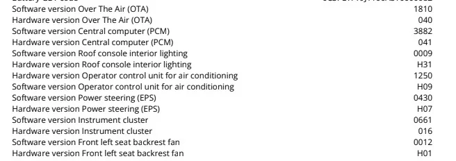

This is mine Taycan RWD (MY23) software version -> after doing WPN9 - Reprogramming central computer (PCM)
where did you get the version for all the other components from?
You can use VIN to retrieve the car data through paid report, not expensive.
I've tried it, but for mine it doesn't return nothing beside that it's a porsche (car vertical).

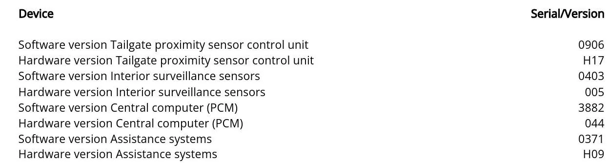

vinanalytics.com
Surprisingly, this one worked. I guess carvertical is good only for paying for ads to youtubers...
Porsche Taycan What's the current Taycan software version? Screenshot 2024-02-29 231034
Do you happen to know which one of all the many softwares it mentions happens to be the software handling the brakes?
I wonder if it's BCM1 & BCM2
sorry i have no idea about it...

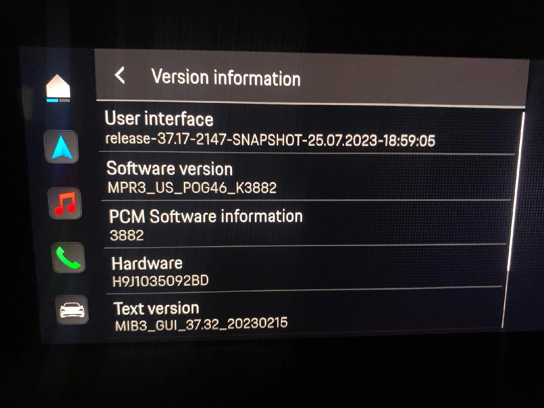

Here's a pic of my PCM info after the WPN9 update.
y
Porsche Taycan What's the current Taycan software version? IMG_2851
Thanks for starting this thread.
My UK-based Tacan Turbo S CT was in the shop yesterday and received what looks like the same update, save for some European vs USA differences.
My car will be on the receiving end of the thermal management campaign. The software is apparently included in this update and a new passenger side heater has been ordered although I have had no issues with the one in my car.
Do you, or anyone else know what is included/tweaked in K3882 vs the previous version?
Thanks. Matt
Bug fixes. Nav software updated - not sure what changed though. I noticed that the weather option is gone from the customizable Home Screen.
FYI - Also, make sure you car isn’t in privacy mode. I noticed I was no longer getting traffic, parking, charger info while driving and found that they returned the car to me with privacy mode switched on. Turning privacy mode back off fixed it.

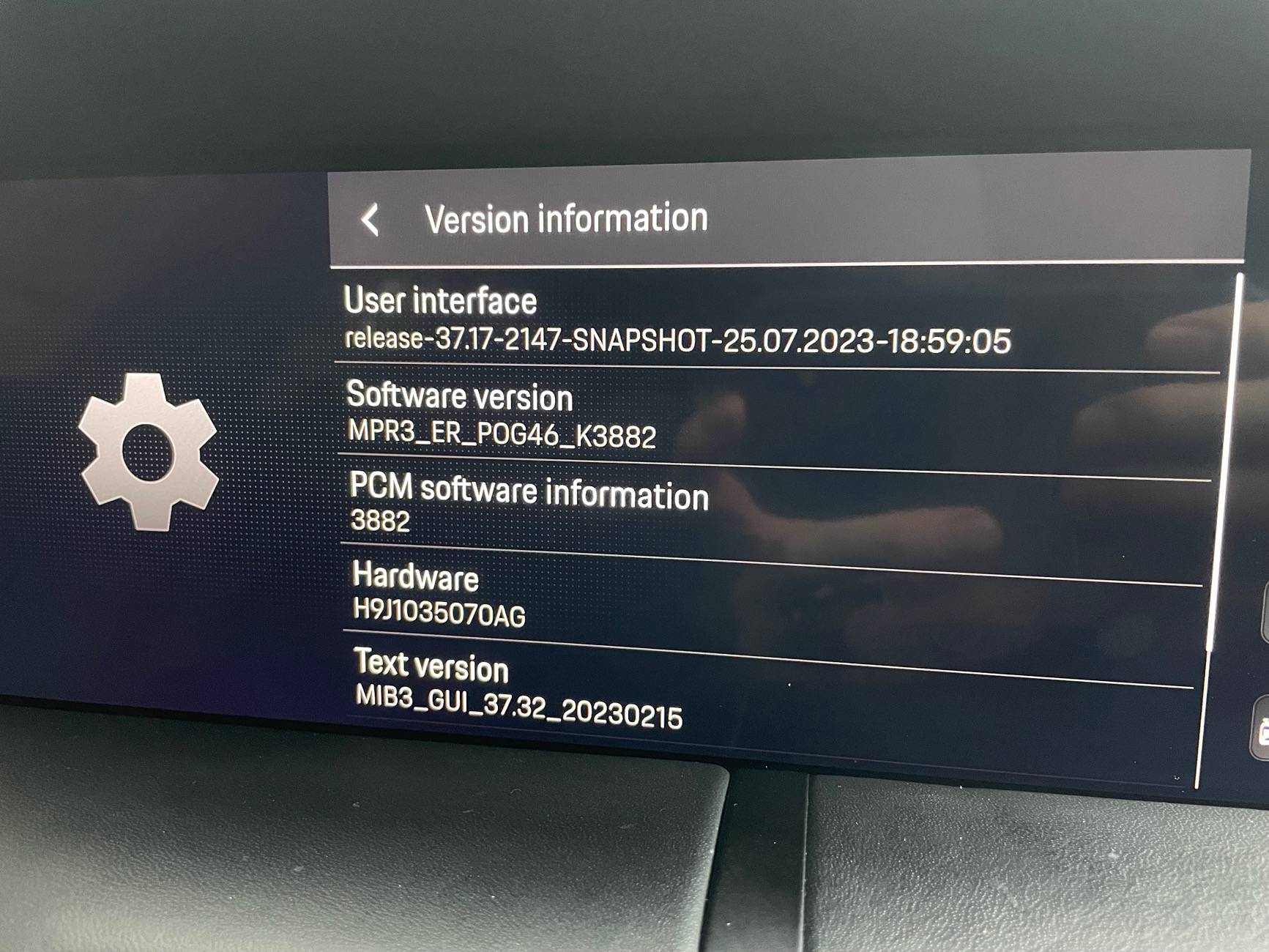

During my 1st service a few weeks ago, my PCM got updated to version K3882. One thing I noticed, the aircon controls by sliding finger on the screen seems to work much better !
Porsche Taycan What's the current Taycan software version? Taycan_aircon_controls
