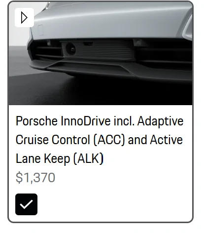

Please share your window sticker, should be available in the App. InnoDrive is an option as shown below and the only way to have ALK. I have it but have not tried it in your situation. My understanding is that it handles round abouts automatically by slowing down and then steering around under active navigation guidance. However, if you do not have it and it is not enabled in the Assistance Systems menu, then what you are experiencing is normal ACC operation.

It's still Innodrive in UK.
I'm really not sure what your expect it to do. Adaptive cruise keeps a constant speed then slows if the vehicle ahead slows. Innodrive adds the function to slow down for junctions, roundabouts, tight bends, etc. What Innodrive will not do is slow or stop for red lights, give-ways, crossing traffic, ...
What do you expect you're not getting?
