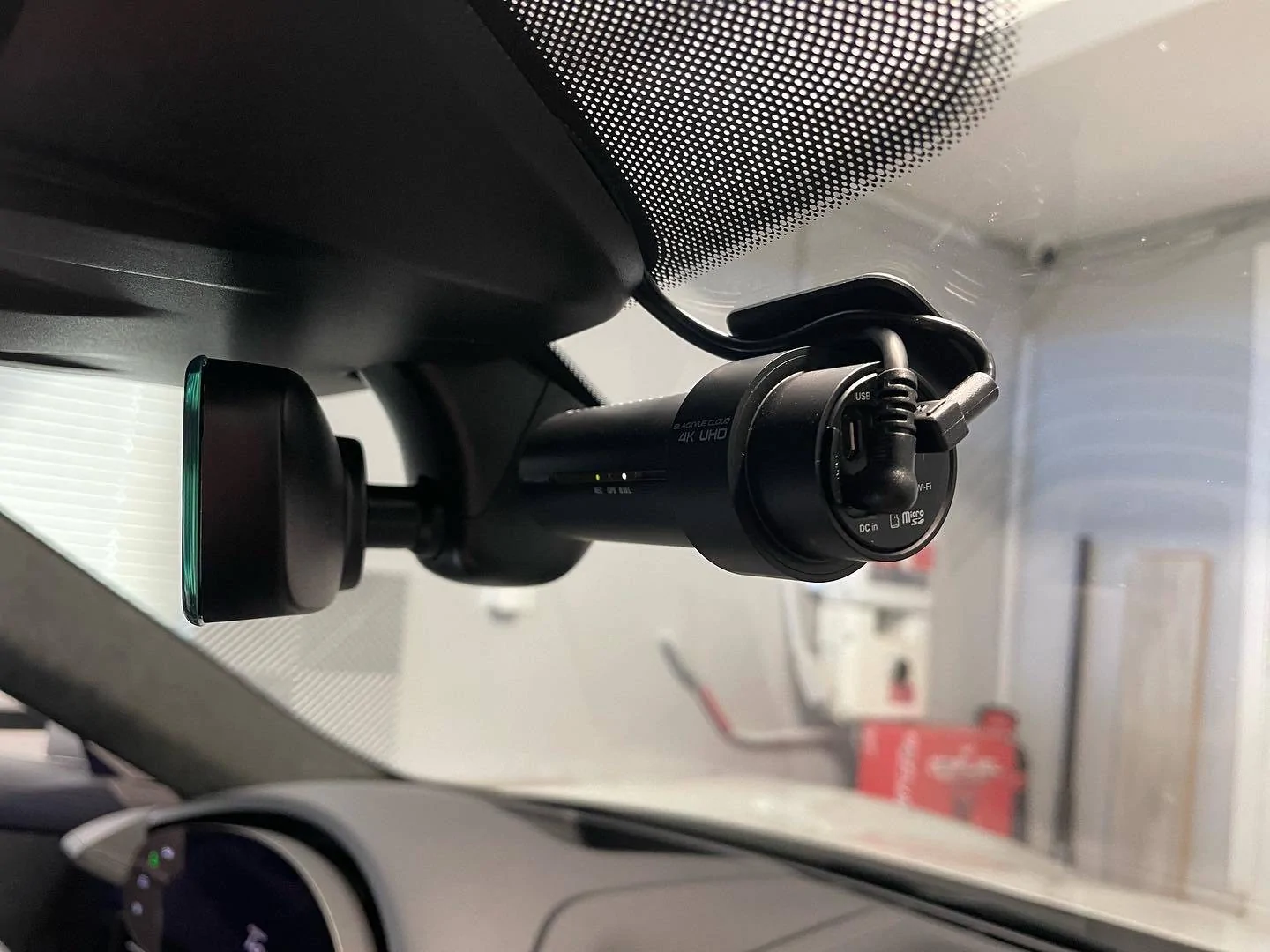

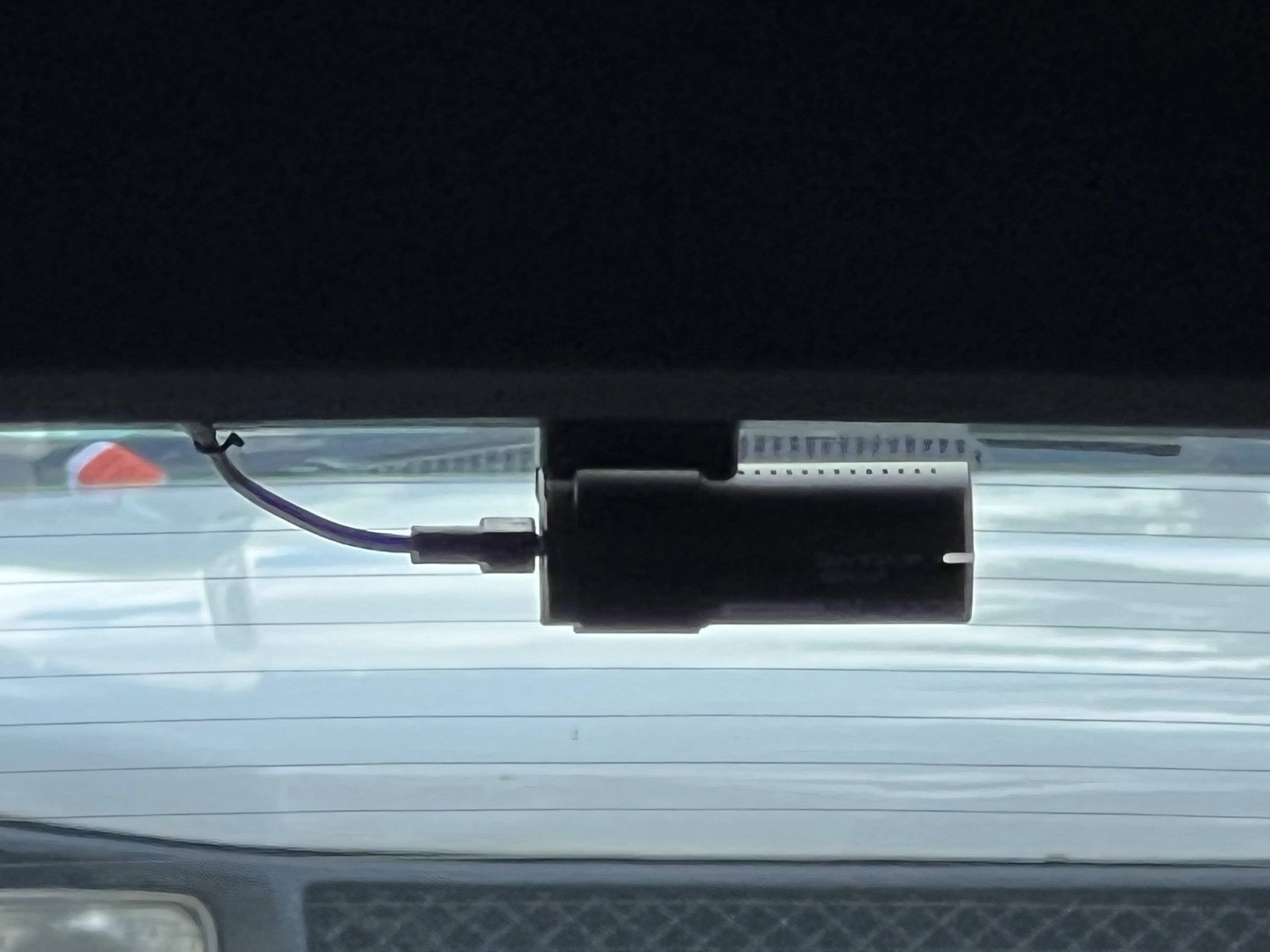

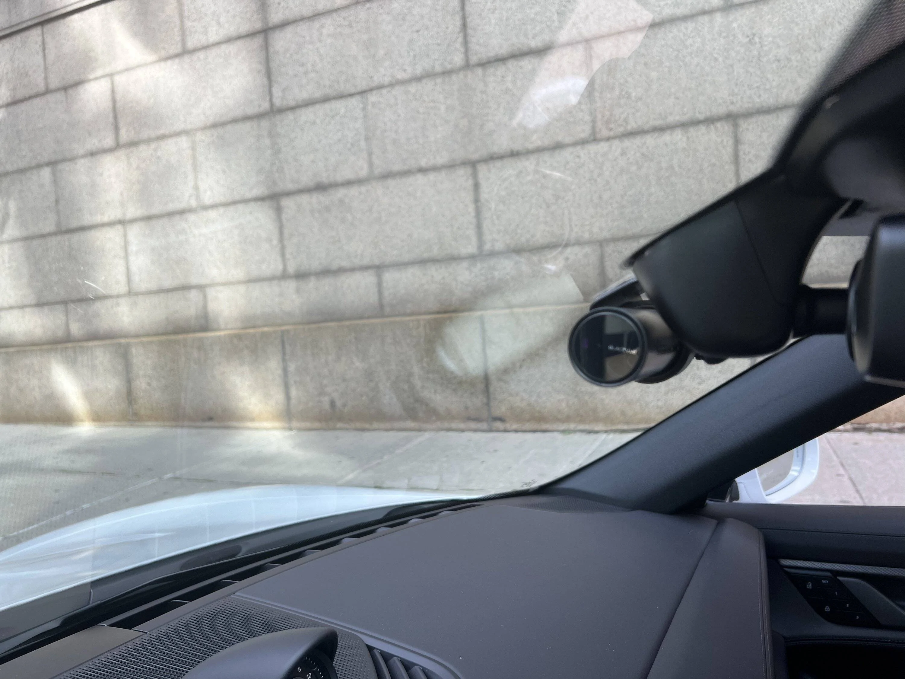

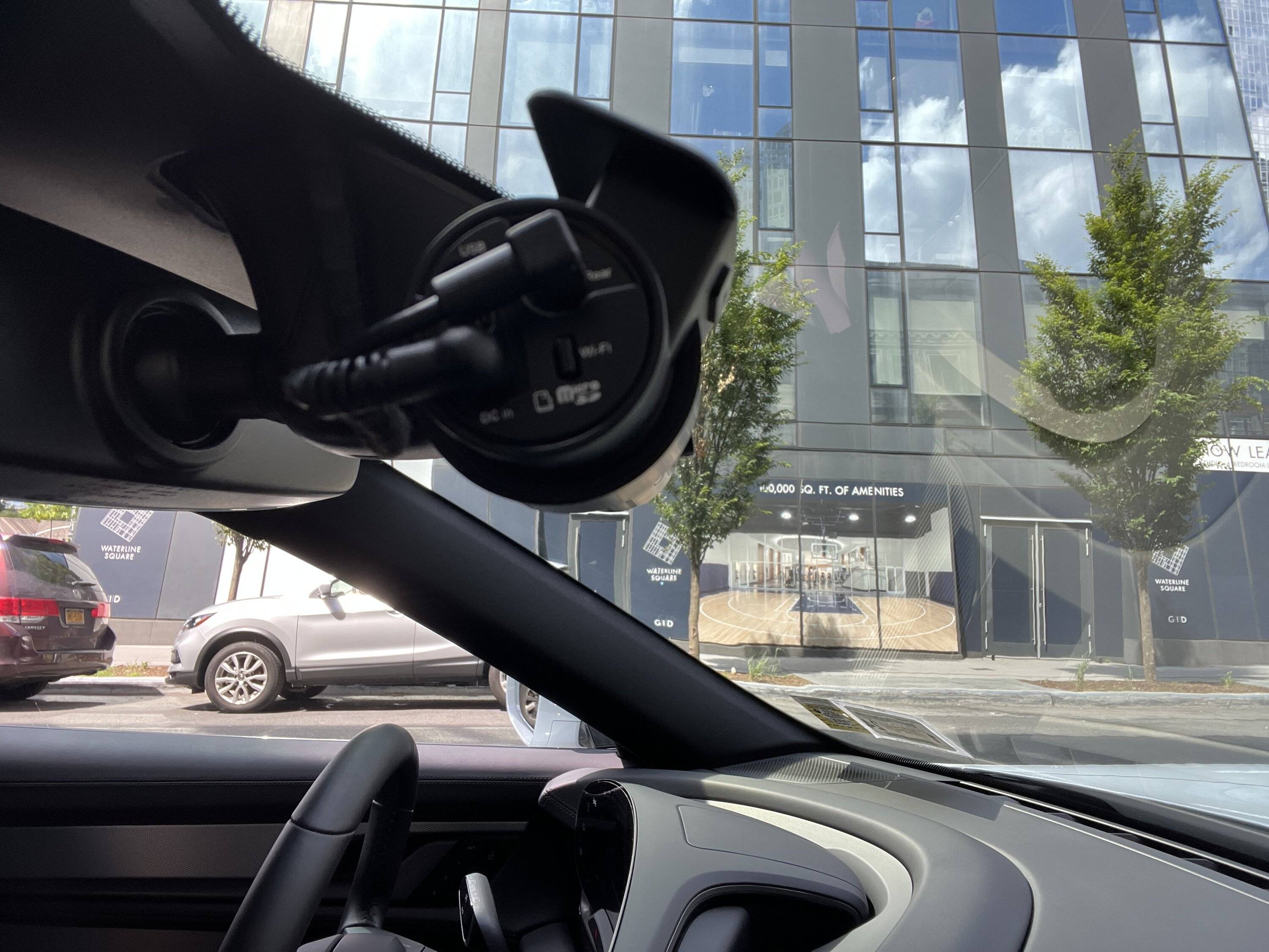

Hi,
Thanks for all the suggestions on the forum. A little price difference but I let the Porsche dealer install. As recommended, safer on warranty. It’s with the 124X battery pack Below are the pictures. Would love to know if you think the job is done fine, or could be better. I didn’t want to tell him till I could see it done better. But I’ll see the technician tm for setup (as wifi kept failing). If there’s a less obstructive way, please share pictures :)

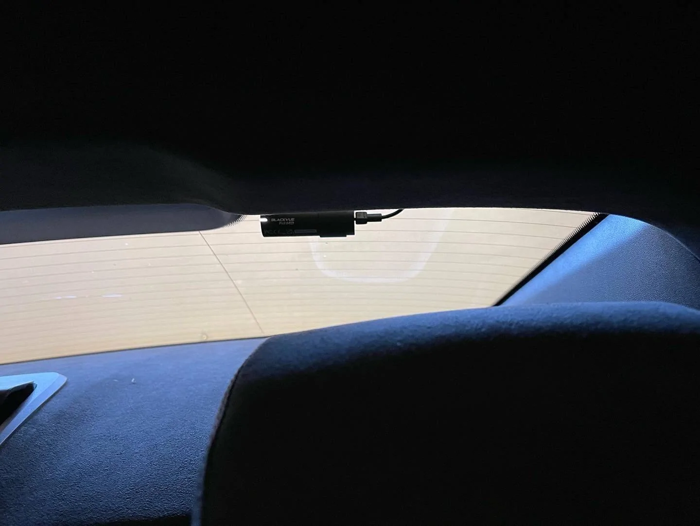

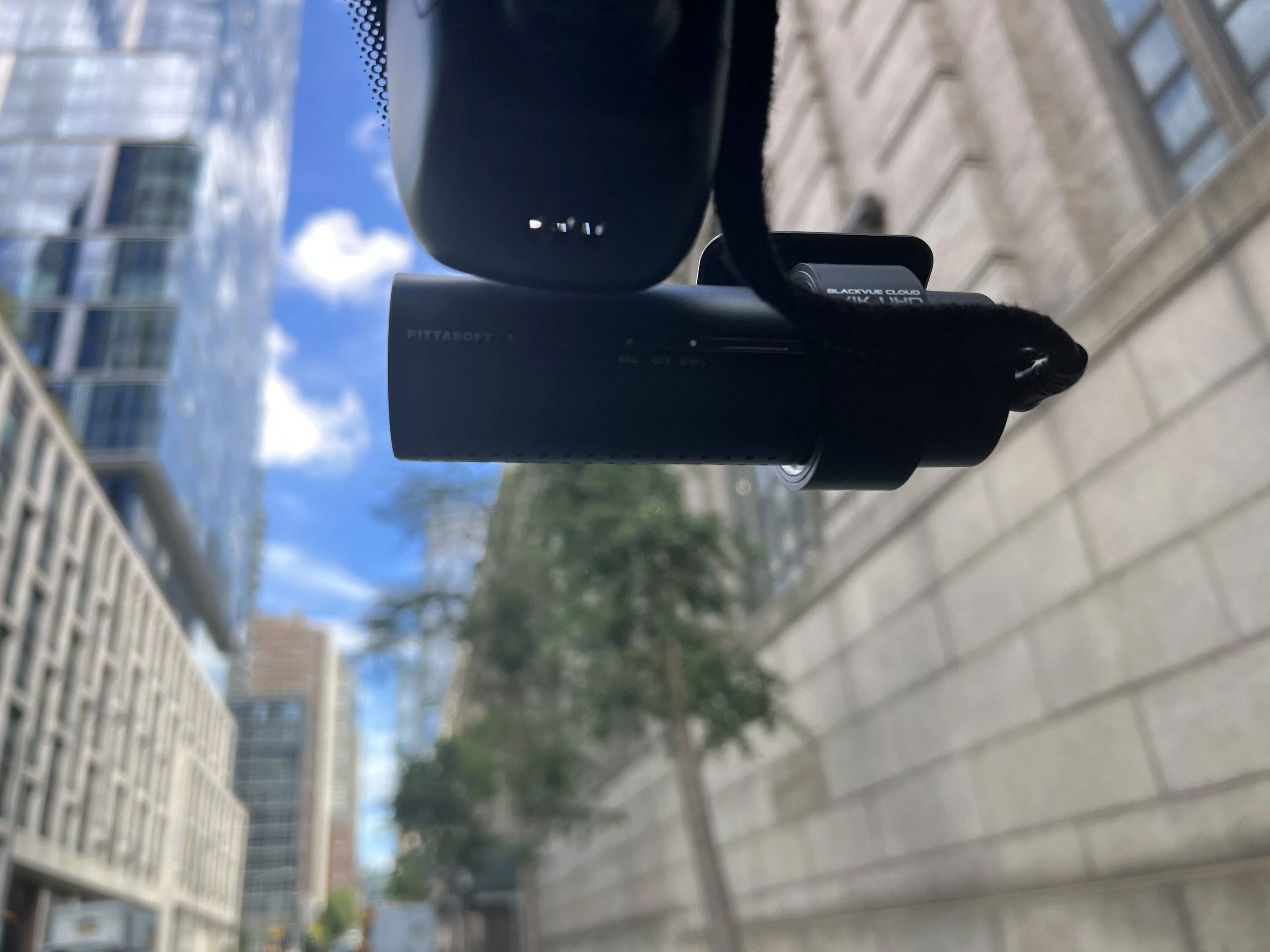

It does seem quite obstructive, but you are the one driving. I can see why they are installed the way they are to keep the frame absolute centered, but to me being centered isn’t that important compared to the obstructiveness.
Mines are installed off center.
