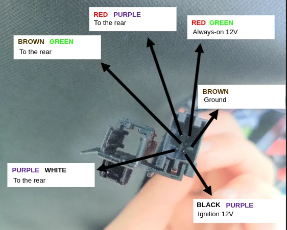

I tried the installation today for powering the dahscam with the pre-wired connector.
I can confirm 3 of the wires are running to the back, the 3 others should be Always-on 12V, Ignition 12V and ground.
However, the always-on wire doesn't have any power on it. After reviewing the "Installation and Conversion Instructions" from NHTSA (https://static.nhtsa.gov/odi/tsbs/2023/MC-10232387-0001.pdf), it looks like I need to add a fuse somewhere, probably the one used for always-on 12V:

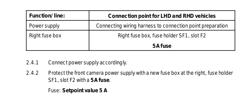

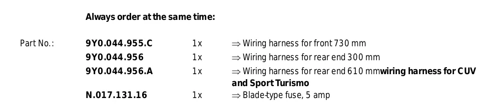

The issue I have now is the document mentions right fuse box, fuse holder SF1, slot F2. I'm not sure though which exact fuse it is as the fuse box is labeled by rows (A, B or C) in the Taycan manual.
On the passenger side, row A fuse 2 isn't labeled in the manual, so I believe it could be that one but I'll have to check it.

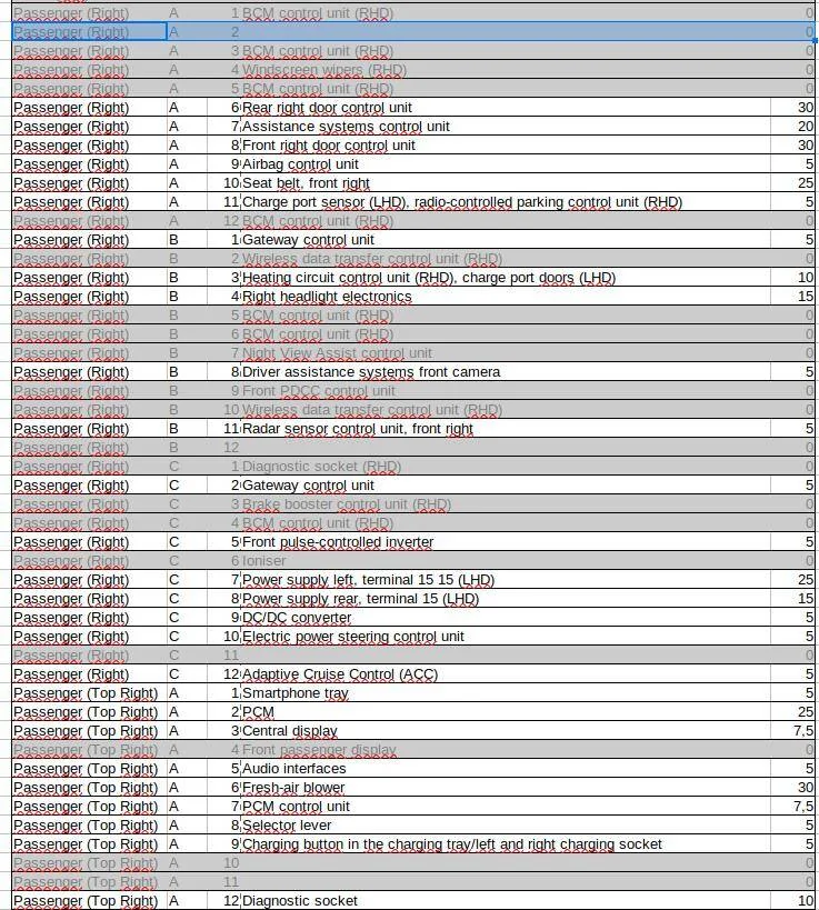

For information, this is the fuse mapping I made from the manual; the grayed out lines are the ones with empty fuses:
It should be a quick job to ring through (using an Ohm meter for example) which missing fuse is feeding the pre-wire.

I've found the 2 fuse holders that are pre-wired:
- Always-on 12V is located in passenger side, fuse A2
- Ignition 12V is on the driver side, fuse C8 (Interior mirror from the manual)

5​
Passenger (Top Right)​
A​
10​
0​
A​
11​
0​
A​
12​
Diagnostic socket​
10​
I think I'll check to use another ignition 12V fuse on the passenger side and use a fuse tap. The provided hardwire kit from Viofo has really long cable and a voltage drop check box, I don't think I'll have enough room to put it behind the overhead console.
I'm planning to use the Passenger A2 fuse holder for the always-on 12V and maybe the Passenger (Top Right) A1 fuse holder (Smartphone tray) for the ignition one
fastlorenzo
Jan 6, 2024
Taycan CT4 MY24
I've finally finished, I used a fuse tap on one of the empty fuse slot for the ignition 12V (Passenger (Right) C3 - Brake booster control unit (RHD)) and another fuse tap on the pre-wired always on 12V (Passenger (Right) A2)
Happy to help by providing further information to whoever needs it ;)

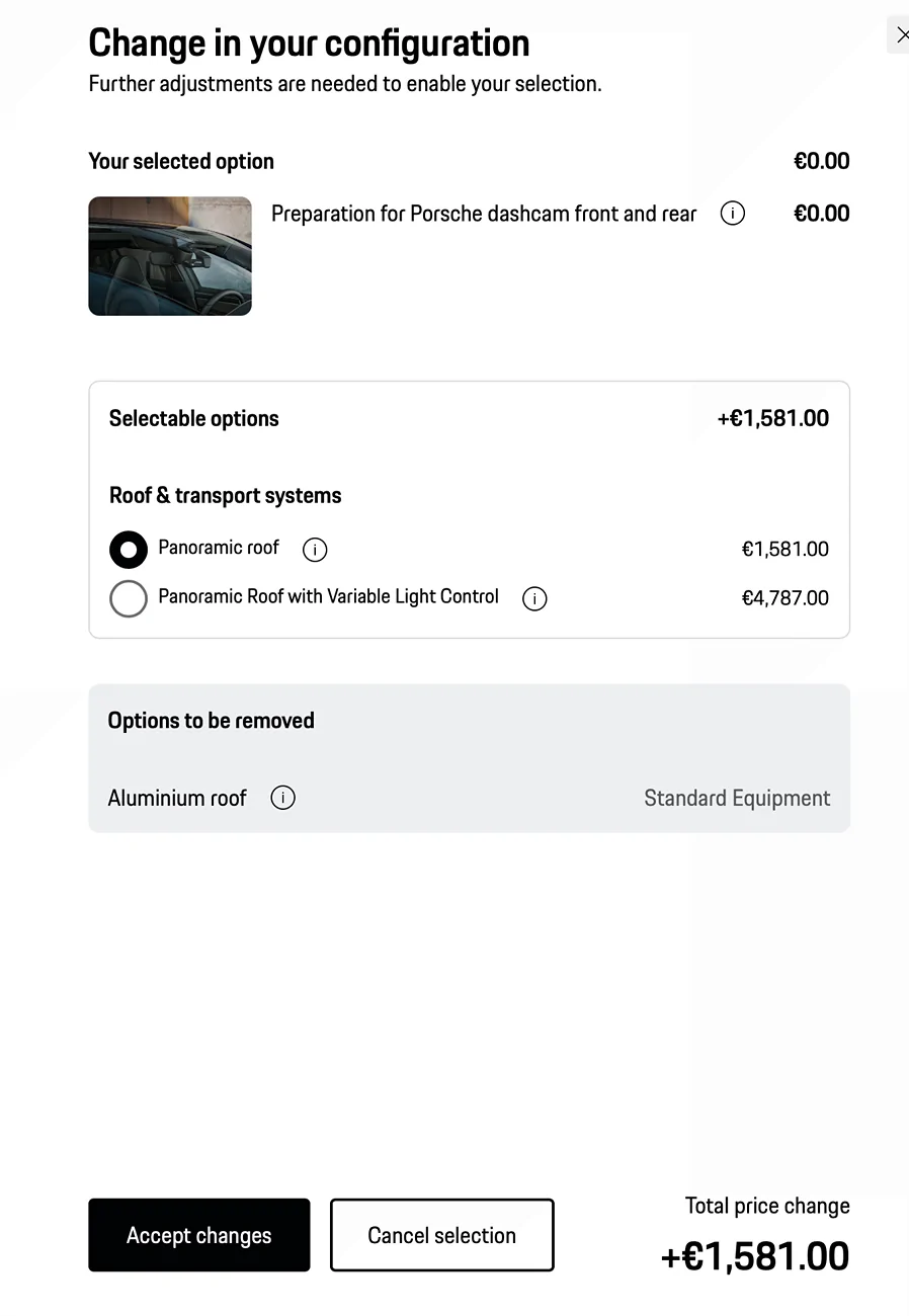

i just went to the latest (Irish) configurator and selected base Taycan, which does not include a glass roof by default.
I then selected Dashcam pre-wiring and it is forcing me to choose a glass roof option:
Porsche Taycan Front and rear dashcam preparation option Screenshot 2025-10-31 at 20.38.48

I've just been into the UK configurator and the dash cam preparation is offered as a no cost option, without any requirement for the pano' roof option.
Seems odd?
