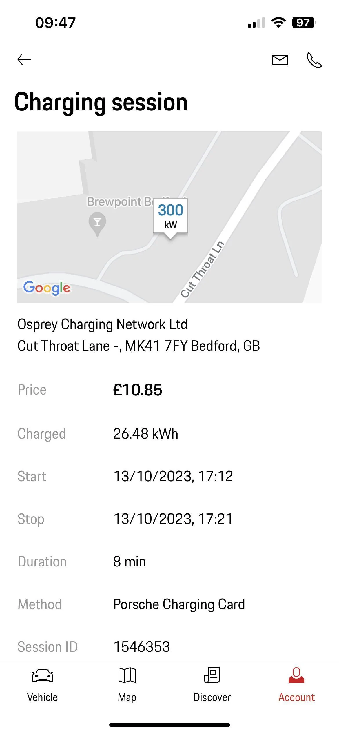

Just out of interest, can you check your Porsche monthly billing when it comes through. I used the Porsche card on Osprey last month and when the bill came through, I got a charge for KWh used (£0.31) and also a charge for time (£0.22 per min). 10.5KWh delivered in 9 minutes cost on average £0.50 per KWh. So less than the £0.79 per KWh they publicise, but that will vary if you are there for longer and/or the charger is delivery less than the maximum (75KW was the one I was using). All prices rounded and including VAT

Porsche Taycan Dealership charging IMG_2312
From the app. Doesn’t break down how the charge is calculated or whether vat is included.
but as above it is 41p per kw.
