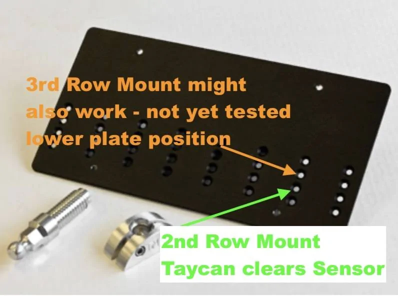

counting from the bottom:
row #1: not tested, but higher mount position than row #2 - so this would definitely not interfere with parking distance sensor
row #2: my current mounting row - 30 minutes of low speed parking lot testing - no false positive signals from the one sensor - Lower plate position visually which I prefer - so we're going with this mount location for now
row #3 - looks like it may also clear the sensor - untested at this time - but would be a lower plate mount position and therefore in my mind visually more appealing - I have not tested this mount location as of this posting
row #4 - definately too low and will interfere with the parking sensor.

good question - the answer is no…
over the past few years I've moved away from the tow hook based plate solutions for two main reasons:
  1. I simply can't get them positioned on my vehicles to avoid interference of the front bumper sensors
  2. automated car washes sometimes get tangled with them and bad things happen
I however still pursue solutions to avoid the hassle of a "front plate fix it ticket" - they are a hassle - so I've moved to a compromise solution…since a front plate is still a matter of law in California

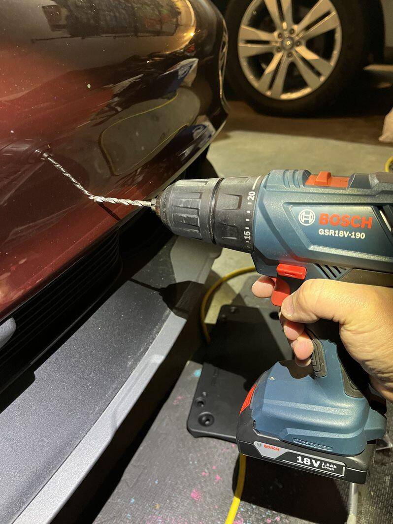

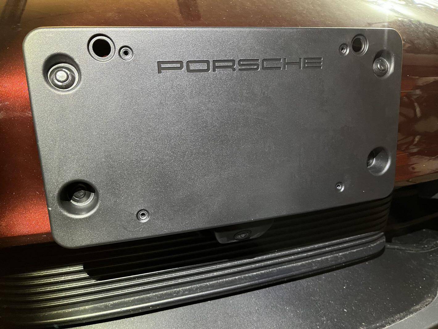

Drill, baby, drill. The OEM plate holder fits perfectly - zero movement.

It went pretty quickly, too.

Old pictures, or did you just get around to it? If the latter, why now, ticket? Also, why not VHB tape?

I have to confess this hurts my soul more than watching someone put Coca Cola into a nice rum or orange juice into a nice champagne (or ask for a well done steak). ?

Old pics, did this a while ago. (Actually right after I finally got my plates.) No ticket, just didn’t want to live a life of crime anymore. Slept better too - or it might have been the night cap.
Wanted to use VHB tape initially, but upon closer examination the plate holder has a narrow edge (hollow inside/underneath) and I didn’t feel comfortable with the small contact surface - especially at high speed. (I confess I did not give up on all manners of crime.)

European cars come with the supports already pre fitted so the painful drilling is done at the factory. I would cry seeing it being mounted.

Yea, I looked at mine. I just might be enough if you put all 4 circles of VHB where the screws are holding it, perhaps add a plastic circle on the screw side to stick through the hole (it's a pretty strong tape, holding many cars together, holds dashcams on less than 1 square inch of tape) but yea, if it was me I'd probably fashion an additional bracket to have a bit more more surface area.
