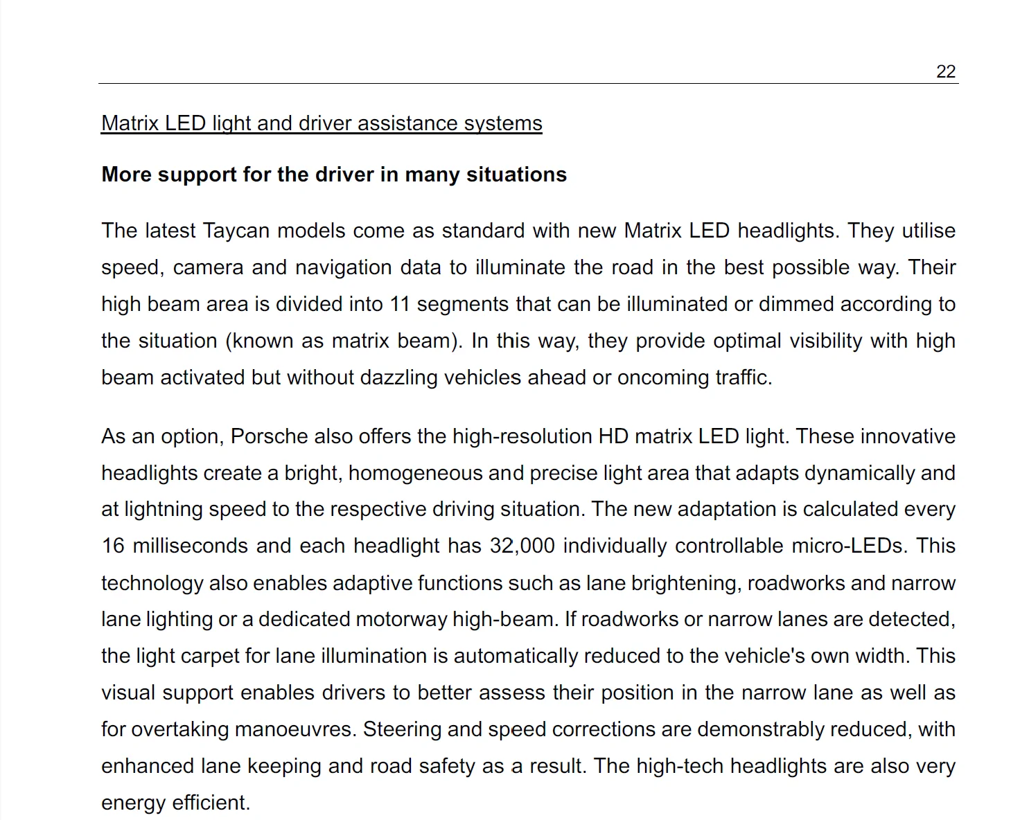

This is from the J1.2 Press kit regarding the lights that are both Matrix.
However, I am not sure how to compare "matrix functionality" of the J1.2 Matrix (non-HD 11 segment) to J1.1 Matrix LED that has 84 segment. I do know that J1.2 HD Matrix is required for swivel beam and other things that are normally PDLS+ functionality above the basic Auto High Beam.

J1.1 had LED as standard with PDLS+ as an option and low resolution Matrix with PDLS+ as standard but at extra cost.
J1.2 has Matrix with PDLS+ as standard and HD Matrix with PDLS+ at extra cost up to Turbo.
There will be little or no difference between J1.1 and J1.2.standard matrix other than the visual appearance.
There is no comparison between standard matrix and HD matrix - a step change improvement.
