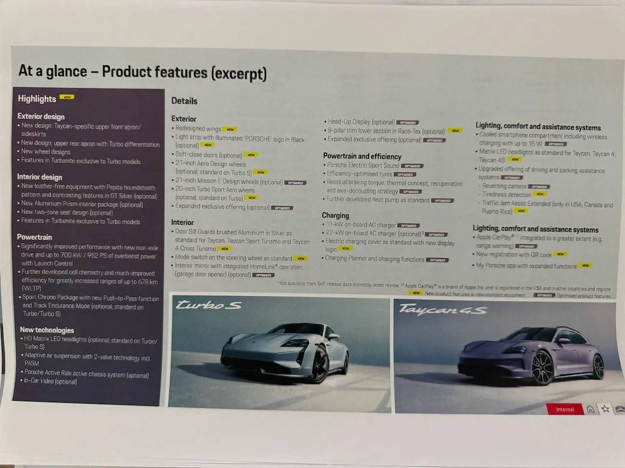

Thanks, i found the doc and there are indeed quite a few nuggets which speak to the underlying changes:
- new pouch cells, lower internal resistance
- new rear electric motor, higher power, 10kg lighter
- upgraded pulse inverter
- new heat pump with higher power
- new AC compressor running under 800V instead of 400V
- new Combined Booster Charger replacing DC/DC converter & HV booster (for 400V DC charging)
- new Power Distribution Unit
- new controller for the 11kW AC charger
- optimised brake pads
So all the critical systems are new: battery, rear motor, AC charger, DC charging, heat pump & AC. Whether this contributes to reliability improvement remains to be proven, but at least there was a re-design effort which must have been informed by field returns.

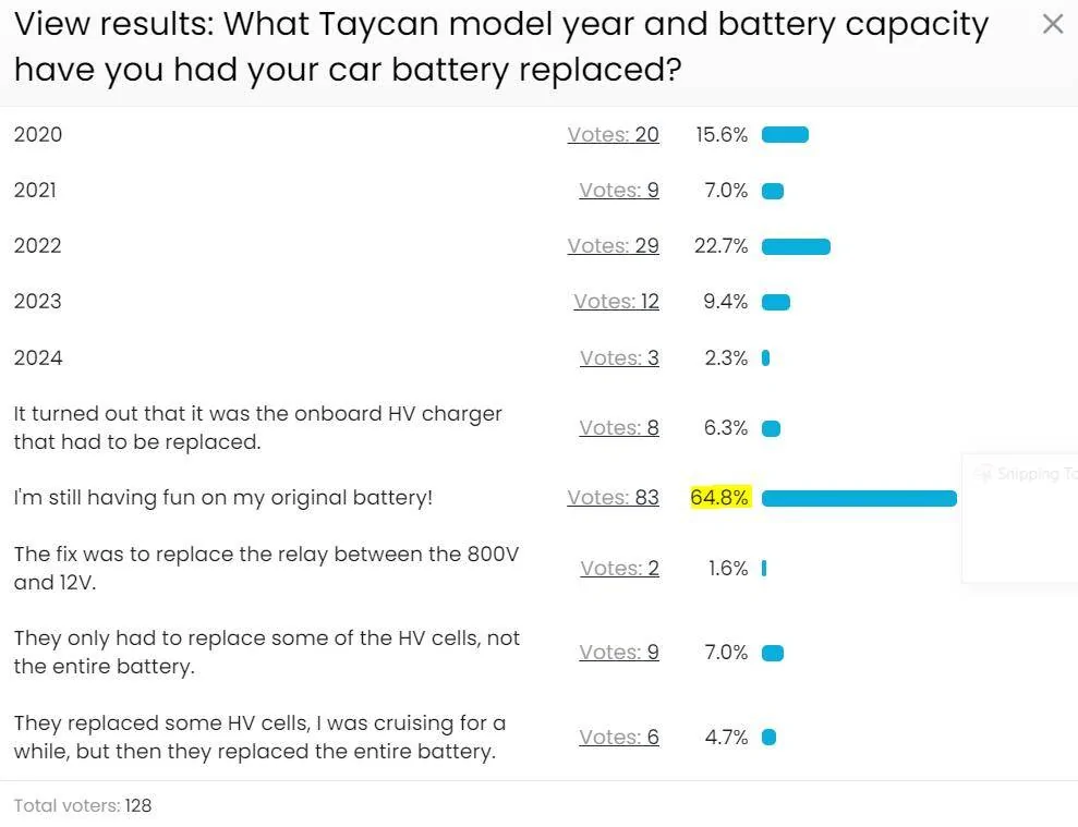

In passing, my 9/10 example was not that hyperbolic when i see the battery pack failure stat from this very forum. It a forum so incidence rate may be amplified, but still.

The rear view camera everyone loves has been ‘optimised’, hope this means upgraded!
Headlights are new too
Interior is the same apart from active cooling for the wireless phone charger but it is still in an awkward place
The protective under tray for the battery is now GRP rather than metal, so hopefully that reduces the dents and large repair bills some are facing.
All the big stuff on your list will hopefully lead to a more reliable car, Porsche will have learned a lot from Gen1, reflected in the scale of changes during a mid cycle refresh. For example the HV heat/cool system is 2.5x more powerful than Gen1 so perhaps an admission the original system was not up to it, demonstrated by heater failures that seem to be the number one issues on here.
This is good news I think. Did you find any references for that change?
I missed it.
I missed it.
see this, reversing camera 'optimised' so not clear if that means new hardware or new software but it should be better :please:
