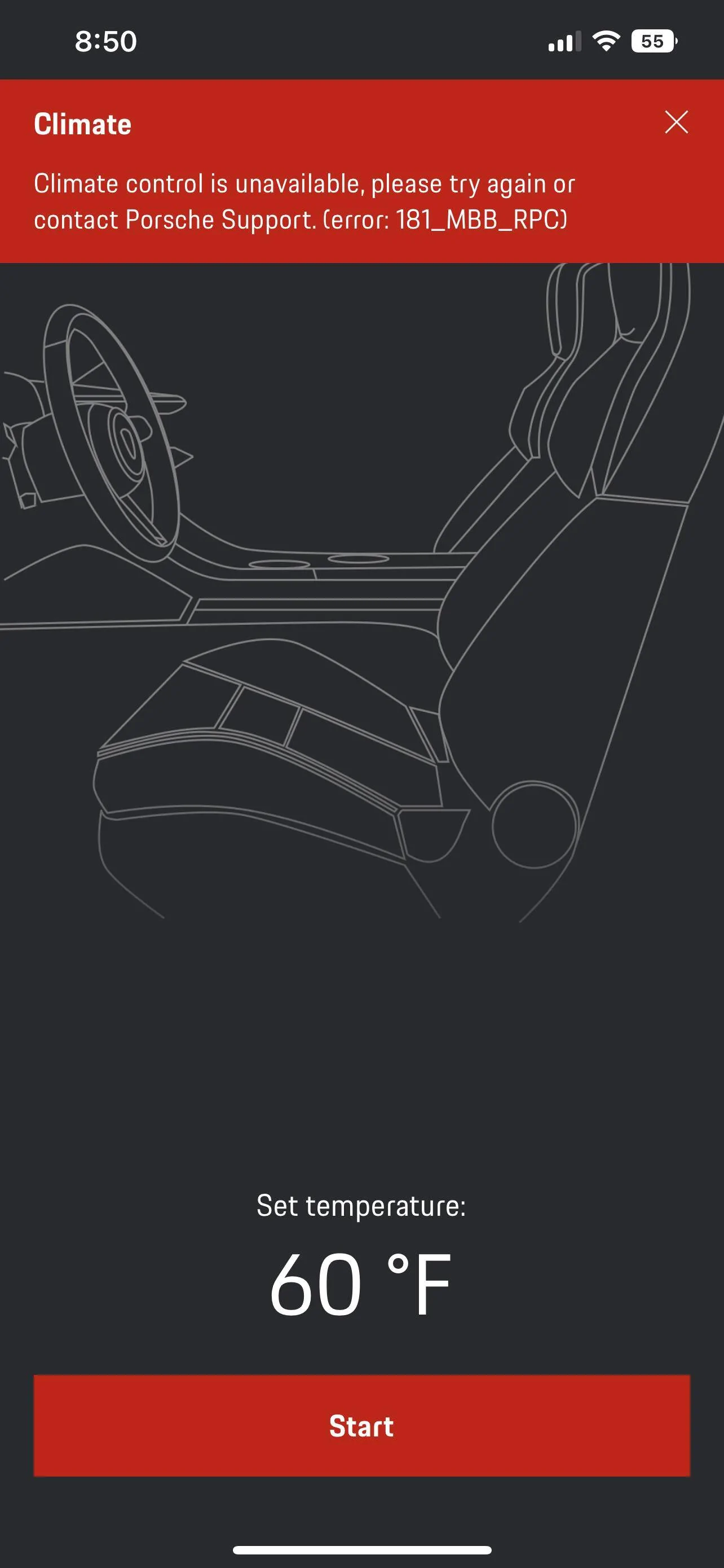

I initially thought I joined the AC going out club that is covered under the WMP5 recall where there are three sensors that need to be replaced. By chance, I was getting a new tire replaced at Porsche under warranty today and the tech did a quick look, but said I needed to drop the car off as nothing obvious was not working or disconnected.
Seems strange that it worked fine and then totally stopped blowing cold air. The blower works fine and strong, it is just hot air.

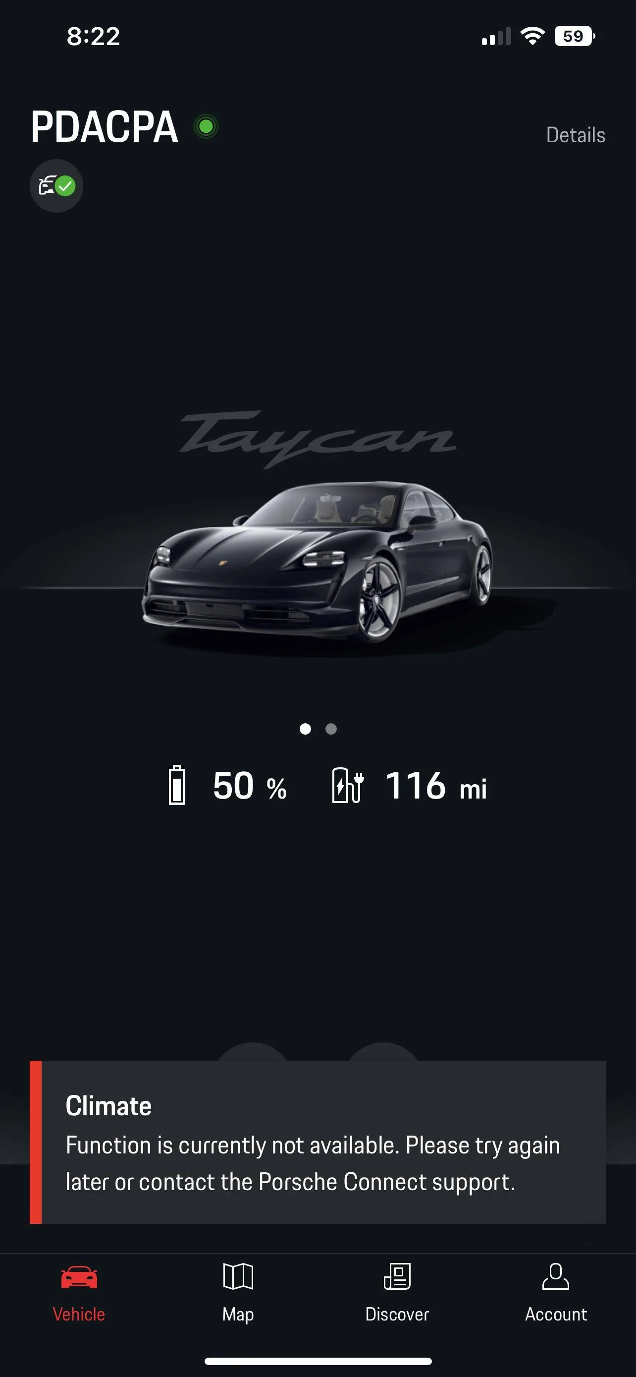

Then tonight I realized that I did not get my notification on my Apple Watch (and iPhone) that my 7pm precool completed for my ride home from work. So I started messing with My Porsche and the old Connect app. Both which I use all the time to select "Climate" and pre chill the car when I am walking out of a store to the car.
I did the 2 finger salute and rebooted the PCM. Have locked the car and kept the key well away from the car for hours. So far, nothing but hot air blowing.
The apps are not able to precool the car. See the attached pictures (one from My Porsche and one from Connect).
Has anyone had this happen? I am thinking this is different than the WMP5.

This is normal when you ger the AC problem, you can’t Control the AC with your app then.
