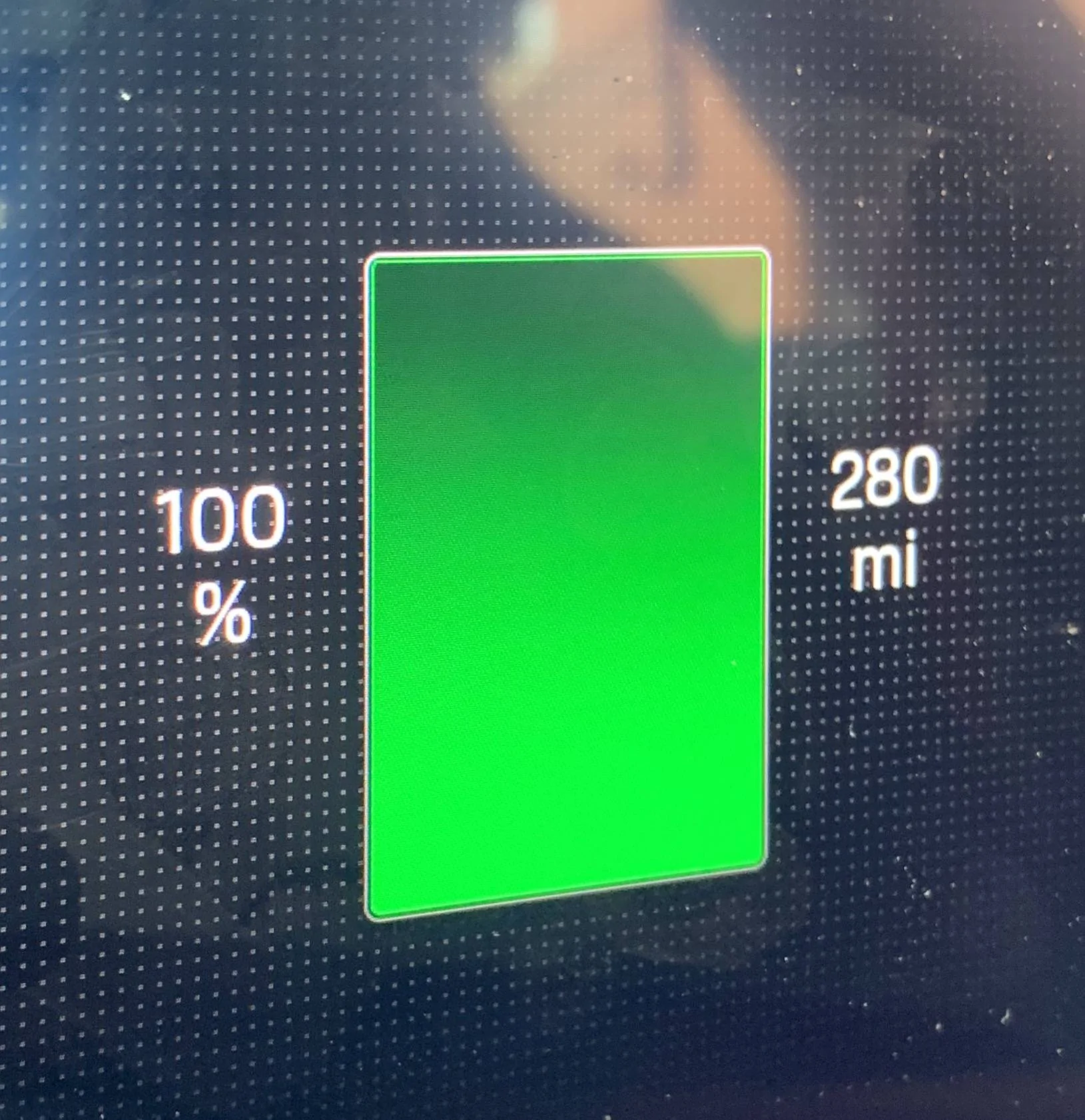

I drove at and above the speed limit yesterday. But the speed limits were 40-55 mph.
Today, this is what my car is telling me: 280 miles of range :cool:

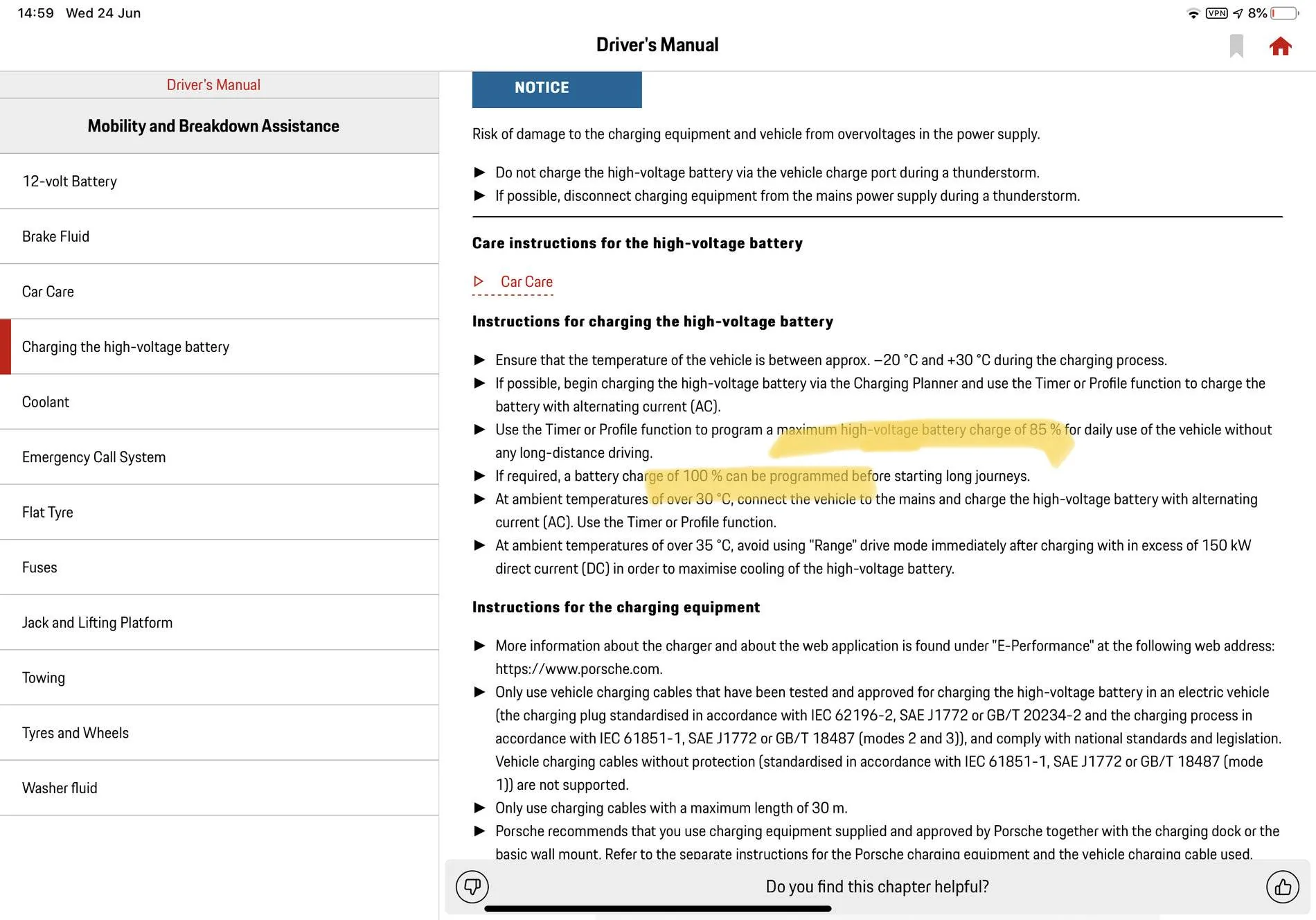

What is this 80% recommended maximum charge thing? No one at the dealership said anything to me about this, couldn't find it referenced in the Good to Know. I've also seen people here allude to it, but don't see an obvious way to limit charging to 80% (or any other number) . . . feels like when I plug it in it's just going to charge to 100% (I've only had the car a few days and only plugged in the charger to make sure it works). My understanding is 100% is really only 90% anyway, as they limited battery charge to ensure battery life in a non-overrideable fashion.
3,907
3,552
Yes 85%isthe recommended daily charge option in the Good to Know app. If the dealer did not know this it is surprising. They are clearly not trained on the car then. It is also stated in the same app that you are fine to charge to 100%for a long journey. And you can easily change the charge level either with a profile or a timer!
Porsche Taycan Distance & Range Anxiety - How Far Have You Gone 46FA53C7-AA69-42E9-949A-83836C32E0CB
This is undoubtedly true about the dealer/car. Thank you for the reference, so just a follow-up question though . . . I don't see how to actually set the maximum charge? In the general charging profile it only has a minimum. Does it default to the 85%? And if so, how do you override it to 100% for a road trip?
