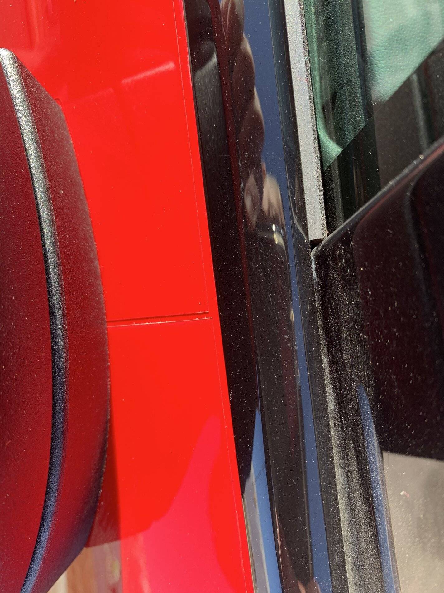

Does anyone else with full PPF have a seam like this?

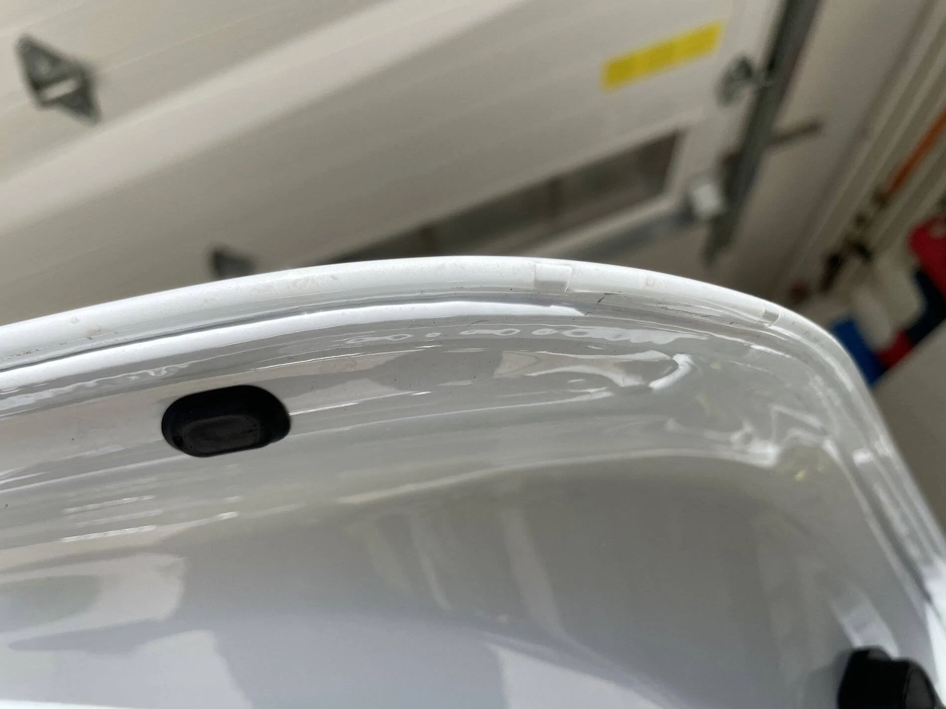

Here are some additional pics on what a really good wrap should look like. No seams at all visible on the outside.
Porsche Taycan Does anyone else with full PPF have a seam like this? IMG_0017
Porsche Taycan Does anyone else with full PPF have a seam like this? IMG_0018

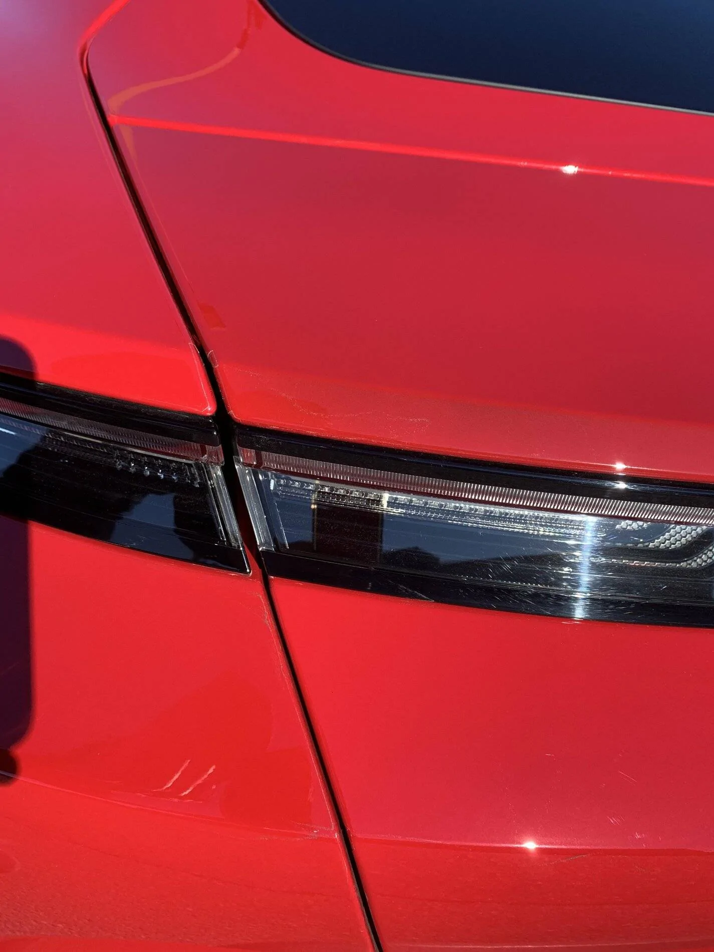

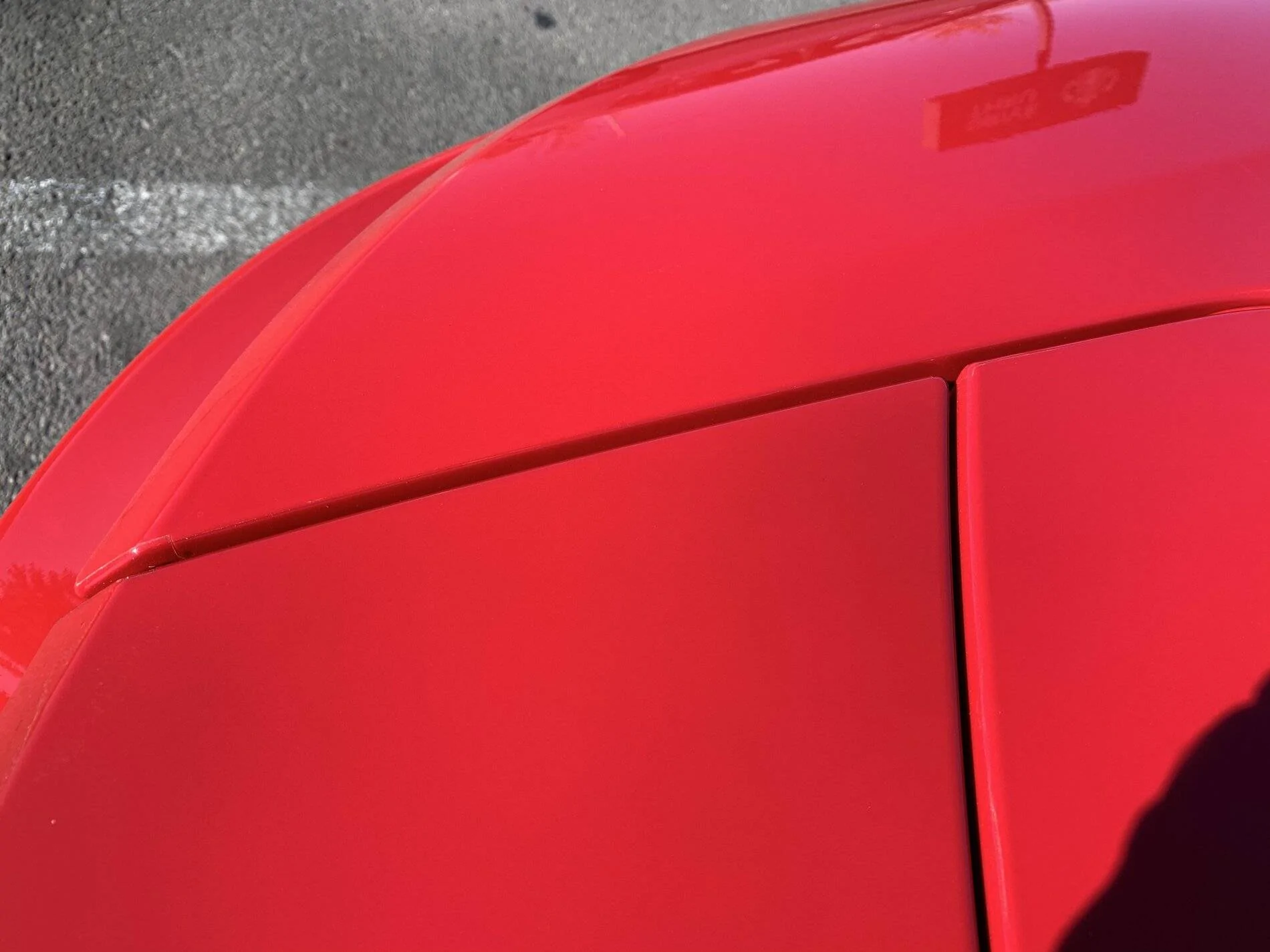

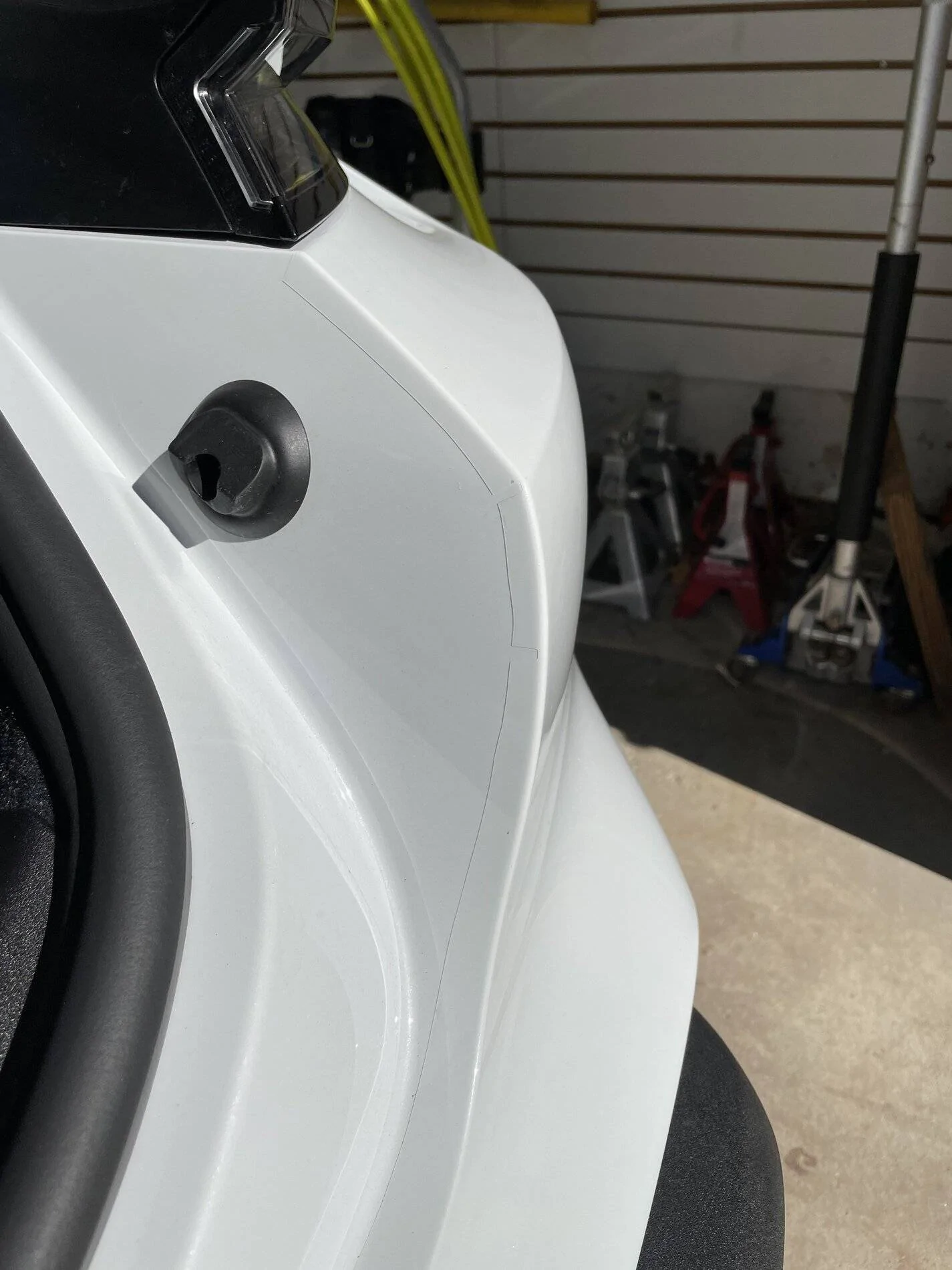

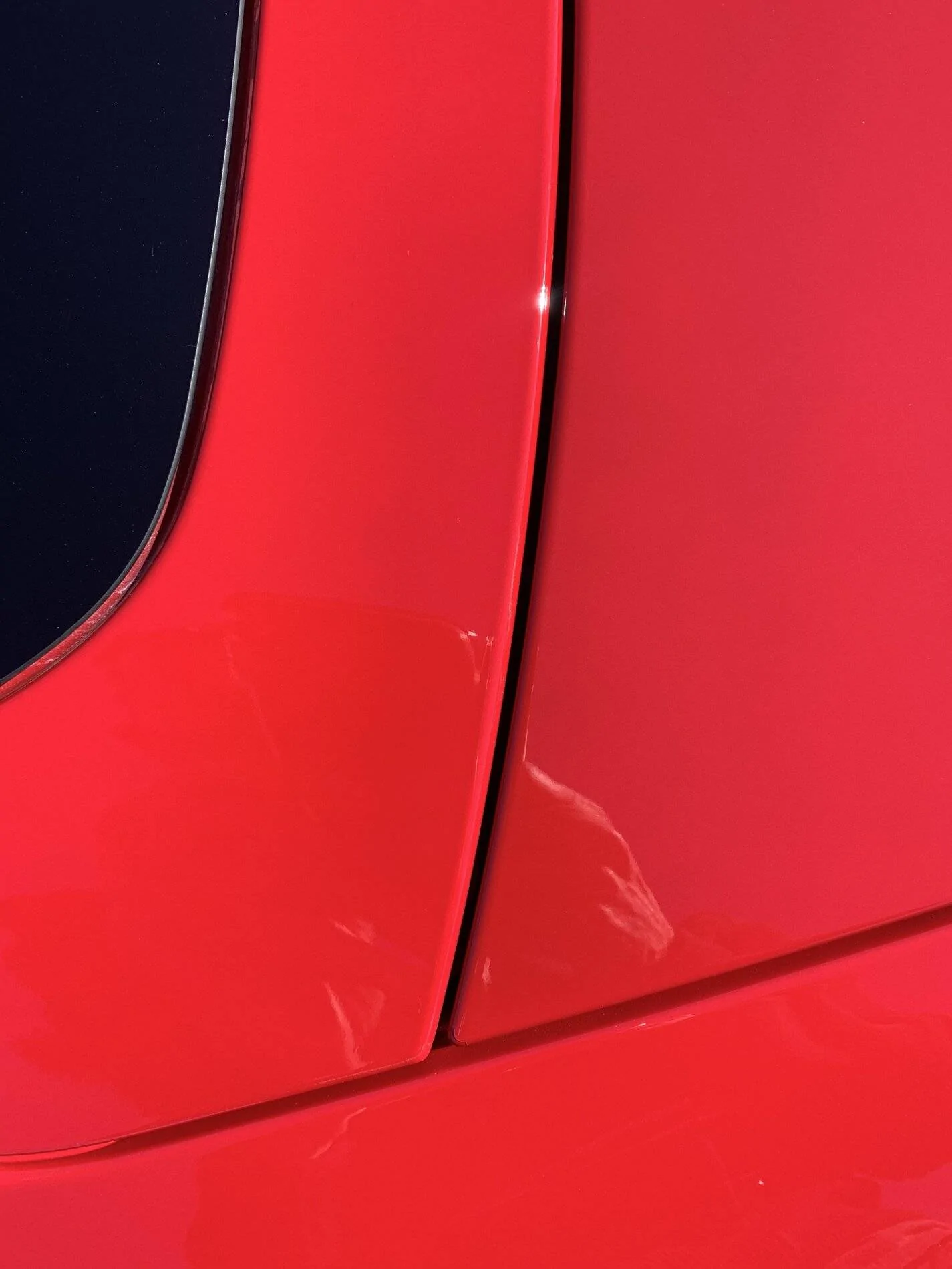

As others have mentioned I believe the warp should be cleaner. Up to the edges as you can see in my images. I know these guys used templates pre cut. This is a PPF Permaplate from the company that my Porsche dealer uses. (Dealer threw full wrap in with purchase). Normally I would use the XPel product as I have on other cars.

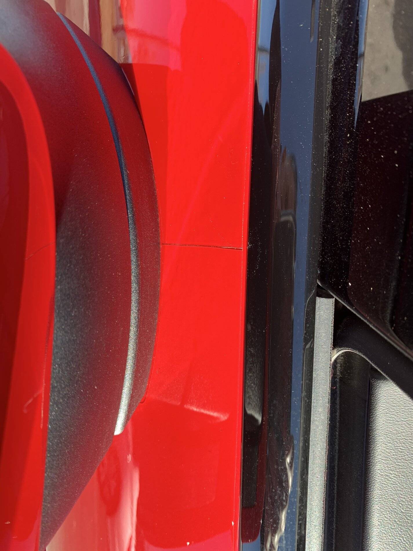

Found one seam not particularly happy with inside of each side view mirror top side of the door image attached. Seems to be collecting a little dirt.
This is absolutely terrible - almost worse than no wrap at all. With a top-notch job, There should be NO SEAMS visible whatsoever on the outside of the car. Everything should be wrapped under. It is quite expensive however, expect to pay $5K-$6K or more for a quality job. I would highly recommend getting a full Xpel wrap from a very highly regarded shop, along with outer ceramic coats that are guaranteed for the life of the car (with a refresh every year for $120). My shop also says there is always something that isn't quite right, or comes loose, and they'll fix right away. That's the kind of place you want to find.
So far, after 2,200 miles in the rain and snow the car looks incredible and is amazingly easy to clean. Just a wipe with the detail spray and cloth does the trick.

The key is a good installer. Ive used several in my area over the years and really its down to 2 shops now. The precut templates from XPEL have a setting that makes the cuts larger than the panel to allow the installer to wrap the seems around the edges. Lazy installers will use the standard one which has lots of seems. Lights are tough unless you want to pull the lights out. One installer actually pulls off all the emblems/badges/shields as well and the replaces them on top of the film. When they did my 488 they did this and I had to sign a disclosure that the shield may crack when they pull it off (as its ceramic) which is a $1500 part. Luckily it did not happen to me.

I would imagine some installers will mistakenly use the templates for the wrong style of Taycan bumper, for example if a 4S is optioned with the Turbo/Turbo S bumpers.

Whatever they're telling you about a 'custom wrap', I'm not sure why anyone would want to deviate from the computer generated 'custom wrap' that Xpel has for the Taycan. If the wrap is done correctly, it is absolutely perfect. I don't know what they think you are getting extra for a 'custom wrap'.?

I agree the XPEL computer printed cutouts allow for overlap to wrap the seams. Plus no cutting near the paint. The only bummer is the a pillar on the Taycan goes all the way to the rear quarter panel so I may have to skip the a pillar, wrap the entire roof line and rear quarter panel or accept a seam somewhere.

If you saw noticeable seams, then the wrap wasn't applied perfectly. If you're talking about the sharp corners on the hood and a few other areas, because the Xpel wrap is very stiff, there is no way they can 'stretch' the wrap over a sharp corner. They have to make a cut in the wrap at the corner in order to fold the wrap under as the two edges meet. If your shop is using another type of wrap that can be stretched (such as was done on my car shown in the profile), you can easily cover the corners but it's much thinner and not going to be the quality of Xpel. Ask them what kind of warranty they will give you. Choose your poison here...
I'm as OCD as anyone, and I can tell you there are no visible seams whatsoever on the outside of my car. (Yes, there are some very slight cuts at the sharp corners that you can see if you look very closely). They even made a custom tool (and special wrap piece) to wrap the carbon diffuser on the rear all the way under the car. If 'custom wrap' means they will cut a few pieces to do some extra things that the Xpel wrap doesn't cover, that's fine - that is what my guy did. The Xpel guys aren't idiots, therefore there is no reason to think the computer generated pattern they developed is flawed. It should be designed to fit the Taycan perfectly, with wrapping on all the edges. I'll say again, from firsthand experience, if the computer cut Xpel wrap is properly applied, it is perfect.:like:
