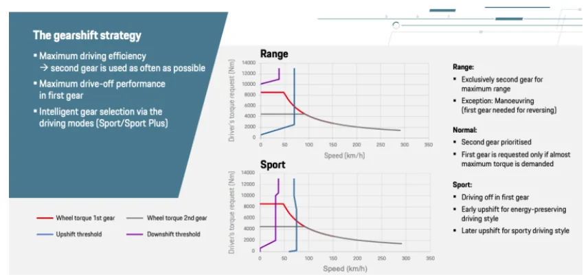

“First gear is mainly used in Sport and Sport Plus driving modes. Launch Control is also available in these modes. The transmission remains in first gear for a relatively long time, then shifts into second gear with a shift overboost.”
https://media.porsche.com/mediakit/taycan/en/porsche-taycan/der-antrieb
Tested sport mode on my RWD this morning going to work. It still upshifts at 85km/h so there's no difference there but downshifting might be different (I have to confirm). I remember that it would downshift when dropping below 55km/h regardless if I was braking or not while this morning it would downshift only when I lifted the foot from the brakes aka I felt the downshift as low as at 35km/h as I braked down from 70km/h. Remove the foot from brake pedal and hear the "kzz" and motor reving up slightly at whatever speed (below 55km/h).
Need to test in normal mode again to confirm if the behavior is the same (or not)
Same behaviour. 85km/h upshift, 55km/h downshift. It does feel different somehow. Not sure what it could be. Just the stiffer dampeners?
