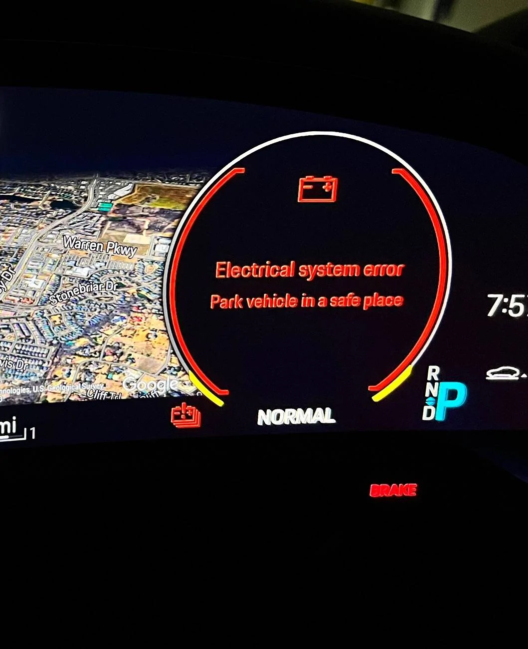

Soooo it's now my turn with the dreaded red ring... About a month ago the red ring came up, I left the car and locked it for a few minutes and it was fine - thought it'd just be a one time thing (wishful thinking, I know). Then two weeks ago the car had the red ring and wouldn't start - Porsche assistance came the next morning and it worked (sod's law). The technician that came was very helpful and advised that I take it to the dealership whilst it can still move. Did that, they looked at it, said they couldn't recreate the fault and returned the car after 64days.
Fast forward 6 days, the red ring comes up again and Porsche assistance came out again - this time the car is still inoperable. Towed it to the dealers and has been there since last Thursday - no word as to whether the fault is still on the system or not.
The first technician when they plugged in their OBD reader said there was an HV temp sensor fault - Porsche couldn't identify the fault code and hence why they returned the car in the first incident. The second technician said he wouldn't bother with the OBD as it's likely the same issue - said let Porsche deal with it (which is fair).
I'm now worried that the fault will have gone away by the time they look at it in the workshop, and they'll call and say they can't recreate the fault... I'd have to take the car back and drive in anticipation of the fault coming up again. Any advice from fellow owners as to what I can do now? Can I insist that they deal with it even if they cannot recreate the fault? Seems mad that I'd be expected to take an obviously faulty car back just because they couldn't recreate the fault...

Ok, you can add me to the list of ”Electrical System Error” Taycan owners. My 2022 Taycan GTS just give me that dreaded red message last night. I had no idea what it meant until I searched this forum and saw that a few others have had the same issue.
After I finished charging my GTS I saw the message. Fortunately, I was parked in my garage and not out on the highway. The car will still turn on but, I can only switch to neutral (drive or reverse doesn’t work). Called Porsche and had it towed to the dealership today. My SA said that he had only seen one other Taycan at the dealership with this warning message. The one that came in had to have the entire battery pack replaced. They are still working on my diagnosis, but I‘m expecting this will be a long journey.
The good news (I hope) is that the dealership give me a 2024 Taycan base model to drive as long it takes to get my GTS repaired. I’ve read several horror stories in the forum about the timeline to get certain of the battery issues resolved. I’m certainly hoping for the best, but expecting that my experience may not be much better than the average of others that have shared their stories here.
I certainly hope that Porsche is able to eliminate these kind of issues from the Taycan line going forward. My expectation for their workmanship is much higher than this.
