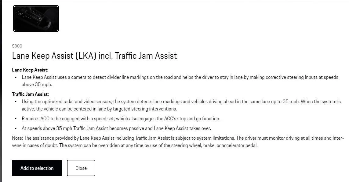

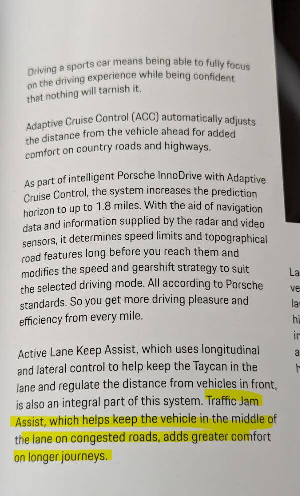

I am new and I have optioned all Assistance systems, so I have Active LKA, ACC, and PID, however, I am having a hard time figuring out if I have and how to detect presence and operation of the Traffic Jam assist or equivalent since it is mentioned on the Brochure (in the same paragraph as Active LKA) but not mentioned in the Manual and no evidence of it in the PCM screens. ACC and PID both state in the Operating Principle that they only work at 19mph+ speeds. For example, new Macans now have ACC as standard in the US but Traffic Jam is called out as such and a standalone extra cost option with clear description how it works at low speeds with ACC.
Taycan Printed Brochure: Page 31
Porsche Taycan Driving Assistance - Where is Traffic Jam assist? 1693323324487
Macan Option that clearly states how Traffic Jam assists works with LKA and ACC:
Porsche Taycan Driving Assistance - Where is Traffic Jam assist? 1693324778235

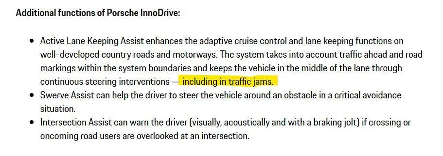

I was hoping for real world use inputs from someone who is using ALK in traffic jam scenario (speeds below operating limits of ACC/PID) to confirm that the car is basically driving itself (keeps itself in the lane) with no inputs from the driver (gas/brake). I am avoiding those conditions for now, so my intent was to learn from someone else how it works before I try it myself.
I found this info that indicates that Traffic Jam is not a standalone feature like in Macan but just part of the ALK when ACC is On.
https://media.porsche.com/mediakit/taycan/en/porsche-taycan/die-assistenzsysteme

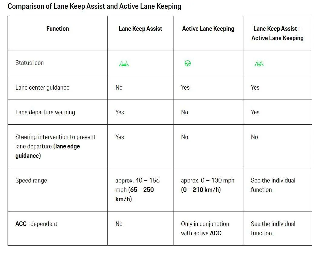

This table explains everything I was looking for in terms of Traffic Jam type function.
ALK is active when the wheel icon is green and passive when grey and ACC must be active.
ALK operates as Traffic Jam given its stated operating speed of 0mph+

violuma
Jul 21, 2023
451
676
San Carlos, CA
2024 RWD
Then I'm happy that you have found it, and maybe this is just me, but that table sums up pretty well why I declined all of the "quasi-autonomous" features.
I think they treat the driver like another of their CANbus modules, and I don't think I'd be a very good code module. So I chose several "inform driver" technology features, and zero "assist driver" ones.

The table you posted is correct but honestly that table makes things look more complicated than they really are.

I had been studying that page in my user manual so glad my reaction to it was not just me!
Specifically, I'm baffled as to why adding ALK to LKA loses the steering intervention -- seems like adding more ADAS features should increase the level of driving automation, not decrease it?
Or is that idea that ALK should prevent you from needing steering innovation?
