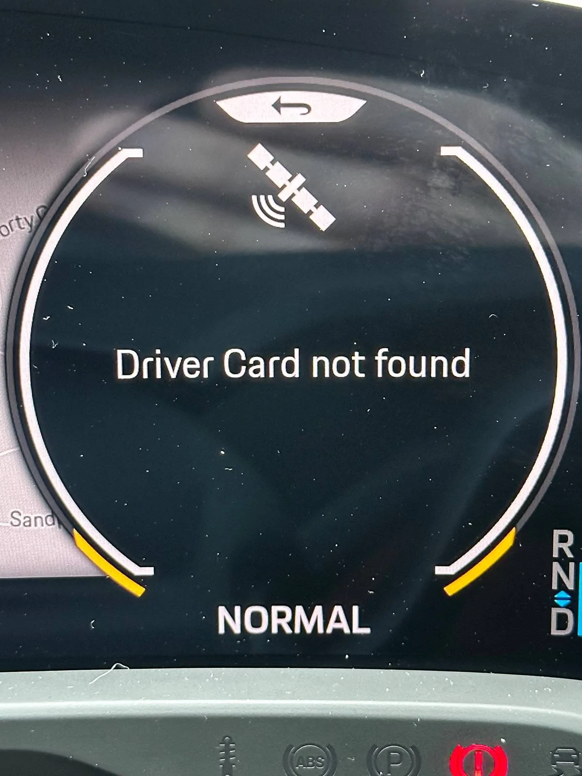

I always get a warning on the dash if I start to drive and the fob isn’t detected - sounds like that’s not happening
I've assumed (risky) mine is working as I've always taken it with me. What does the dash warning look like? Thanks
Here it is … hmmm, I really need to clean the dash …
