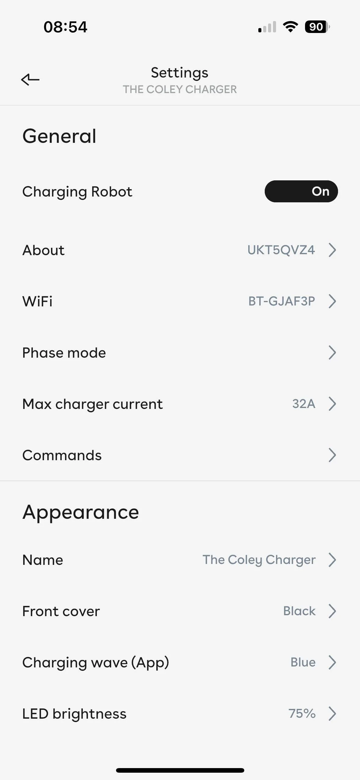

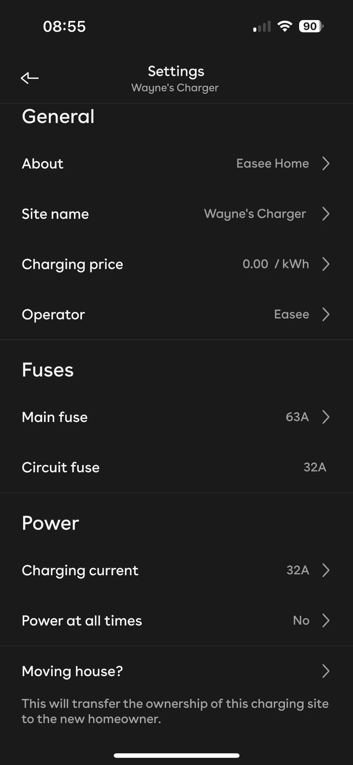

Hi mate. I have this charger. I don’t use the charger profile to set charging times. I use the Porsche app. Never had an issue charging. Here are screenshots of my Easee charger settings. Hope this helps.

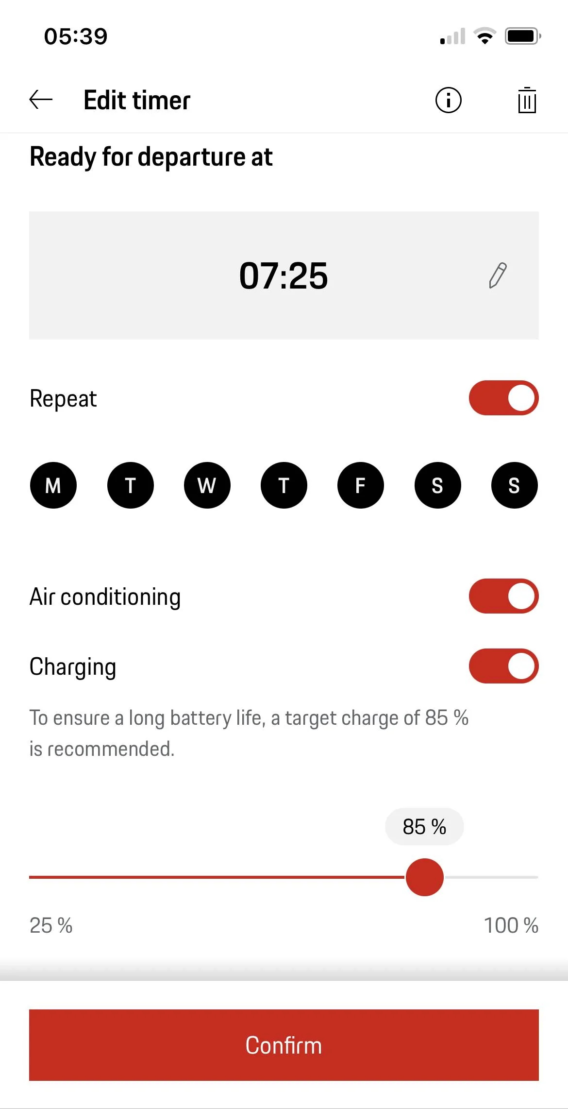

I don’t have a regular profile I use but below was one I setup for when we went on holiday before NYE.

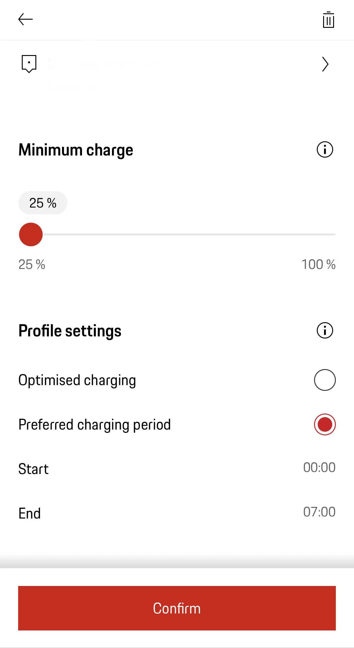

I've attached a location based profile (min 25%), daily timer, preferred times 00:00 - 07:00, depart at 07:00, 85% charge. Works 100% for the past 26 months.
For non Porsche EVSEs the rule of thumb is to ensure no timer or scheduling feature is enabled on the EVSE (ie run in dumb mode).
Ensure that you don't have other conflicting profiles or timers active either.
I have 2 location based profiles (Aberdeen and Edinburgh for example) active and a single timer.

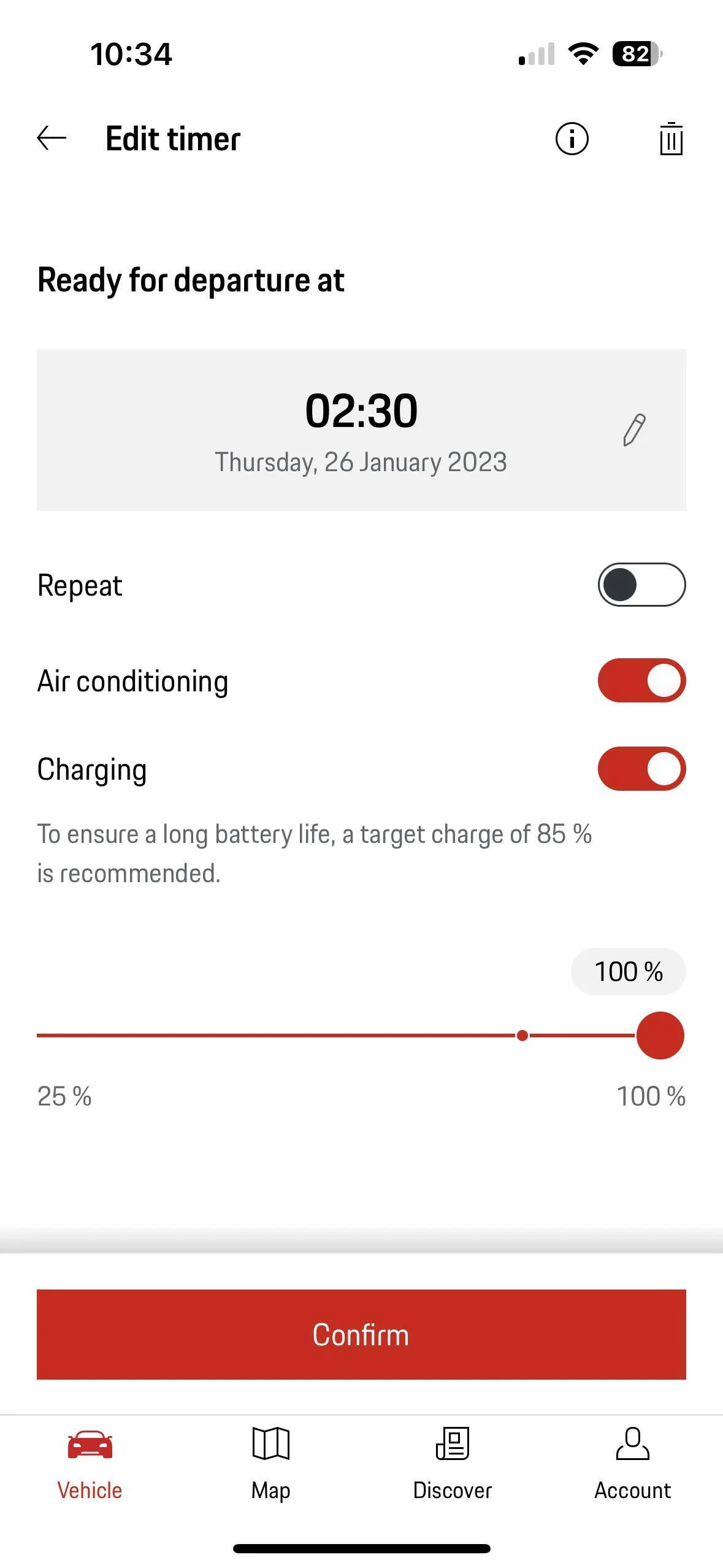

These are mine which look similar to me:

Yep - these are perfect.
1. Do you have other timers active?
2. Do you have other profiles active?
3. Is your EVSE in dumb mode - no programme enabled?
4. Reconfirm actual problem(s) experienced?

Yeah, that's not correct.
25% means to charge the car immediately up to 25% and then wait for the timer event.
Please don't confuse further.
