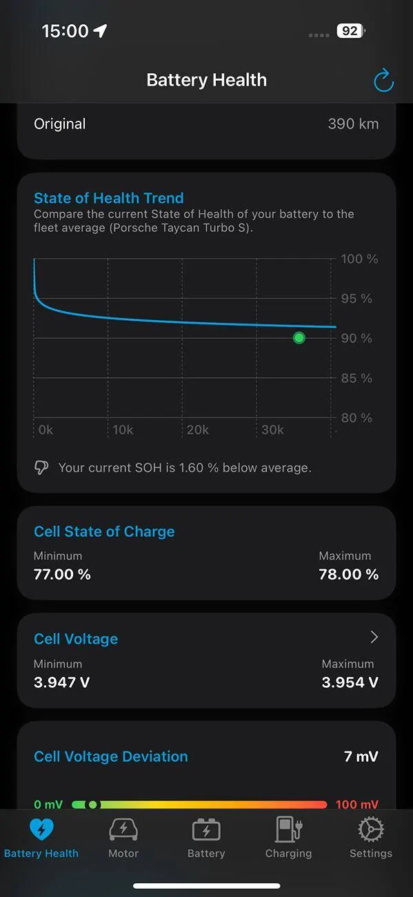

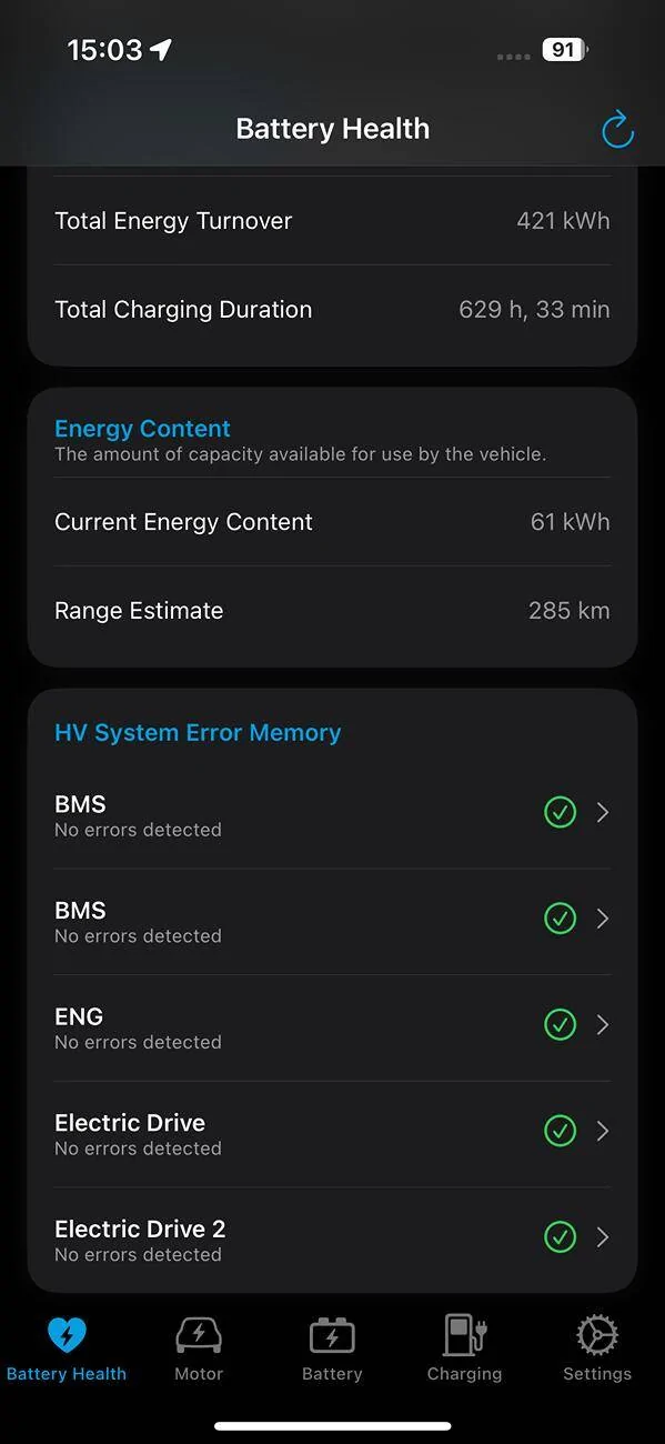

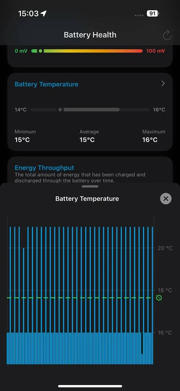

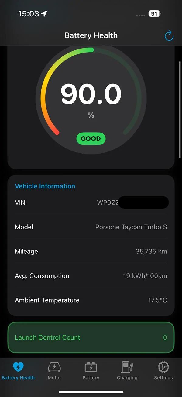

Here is what it pulled for me. I did have a compatible dongle hanging around that I had never used. Was reluctant to use CarScanner app due to its origins. It's great that an EU registered company is making a high-quality app – even if it is not as detailed as CarScanner is.
It is a little bit nuts that I purchased a Turbo S and have launched it precisely never!

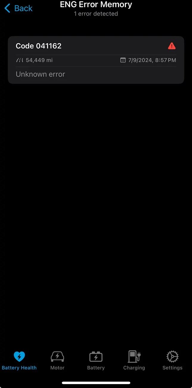

Pretty nice UI. Seems to work. Wish there was a decoder for the error codes.

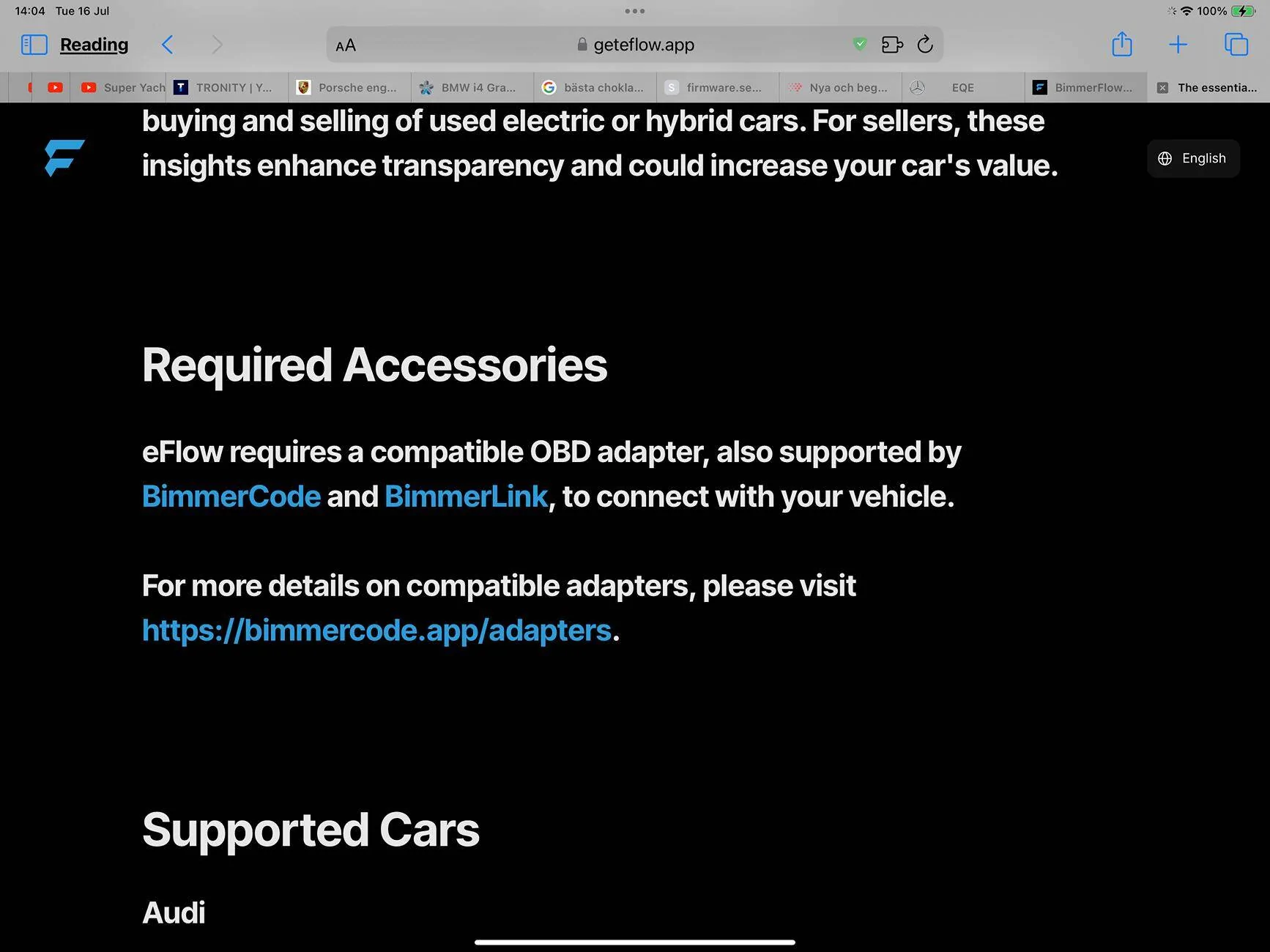

For the uninitiated, can any eflow user please let me know as to how connect this to the Taycan? I downloaded the app and am not sure how to proceed to connect. Rather than try and miserably fail, I thought I would ask here -). Thx!

Have a look at the website and find a suitable OBD reader. I had an OBDLink MX+ available and used that one.
Porsche Taycan eFlow app now compatible with Taycan and VW group IMG_2144
Put the OBD reader in the OBD socket below the steering wheel and find the BlueTooth name and connect to it.
Then start the app and connect the app with the OBD- reader.
Should be fine with the readers in their list
