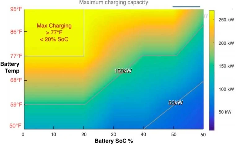

Power is measured in kW. You were charging at 61 kW, not kWh.
Energy is measured in kWh.
Your charging power was probably not limited by the other cars there - more likely by your SoC and your battery temperature. See this chart:
As an electrical engineer, I guess I should know better. I’m more used to dealing in micro amps than amps.
Regarding charging rate, is this graph from Porsche or EA? I didn’t preheat but the ambient temperature was around 50 degrees F. From your chart above it looks like 50 kw should have been applied to the car. Yet I saw 61+ kw for the charge session.
It’s from another member - posted in the charging and battery section of the forum:

With regards to your charging: sorry - pet peeve of mine:
Wow...had no idea temperature affected charging speeds so much. I will certainly remember the preheat capability next time I charge at EA.
One other reason he got low kW could be how "full" his battery was. The speed really slows down once the battery gets above 80%. I saw a video of someone likening this to pouring water into a glass from a pitcher...you pour fast until the glass is almost full...then you slow down so you don't go over. I am sure there is no relativity to this analogy except to visualize/remember it.
I think I started at about 25%. I only charged to 50% at the EA station. Drove around 80 miles and had 19% before charging again last night at home.
