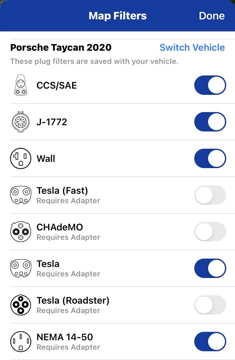

with a TeslaTap and a good mobile EVSE this is the filter settings for Plugshare so that you can find chargers in area that you could charge from while away from home.
Porsche Taycan Electrify America/Charging NA Question 24F0BE65-70C9-4123-BE4B-9A170022538E

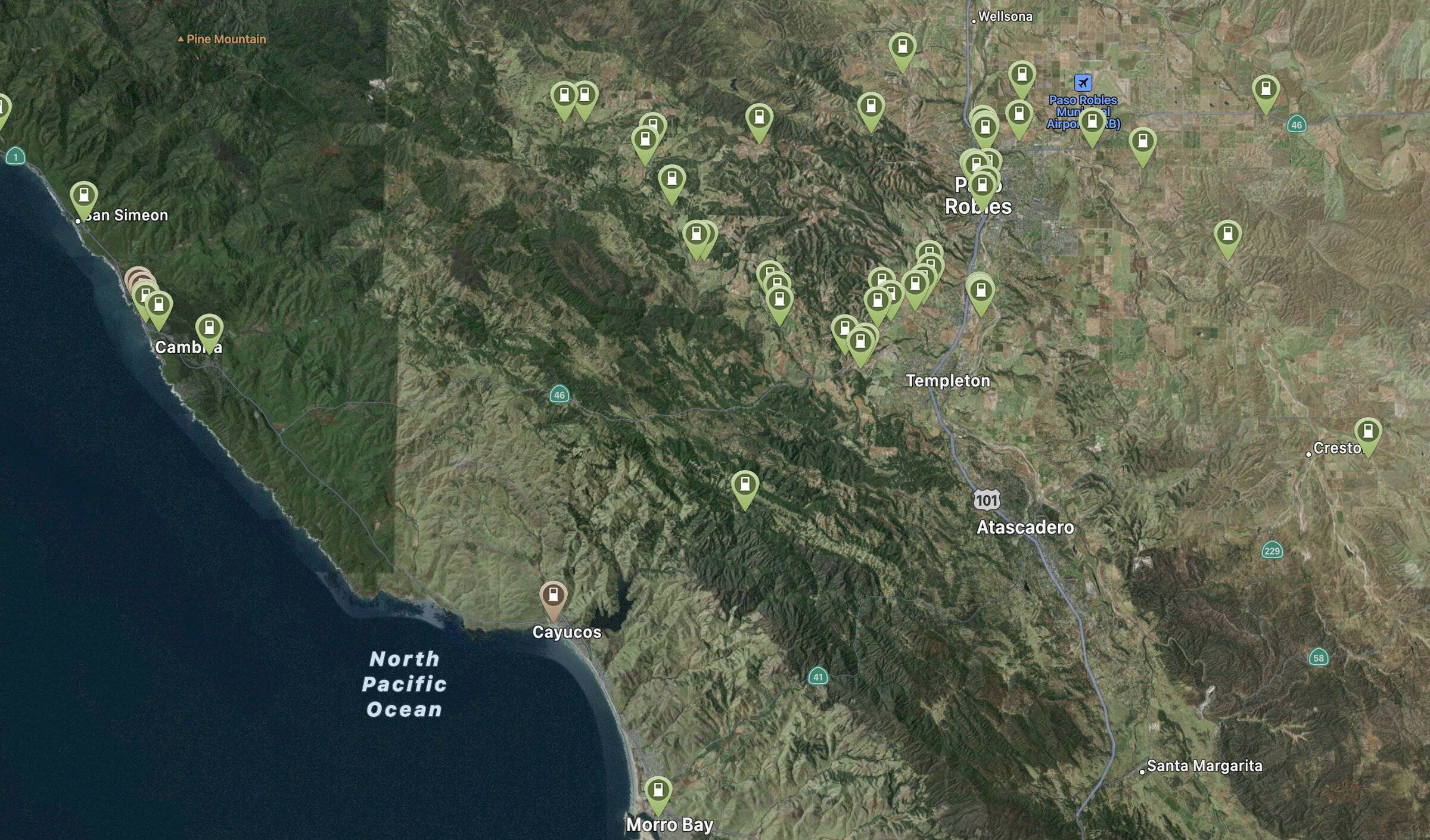

and here are the "slow" charger "Tesla" chargers you gain access to in the PasoRobles area (for example) by owning and having a TeslaTap…the filter here is showing _ONLY_ Tesla chargers - of which as you can see there are quite a few…
the green pins on the map would be inaccessable to you as a Taycan/EV owner with out a TeslaTap.
most of these pins are wineries - it simply awesome to slow charge your EV while doing a 1-3 hour tasting…you should be able to get about 8%/hour while charging from most these…
NOTE: Tesla Destination chargers are not any particular kw rating - Tesla Wall Chargers (which all of these are) can be configured from 12 to 80 amp charge rate (15-100 amp breakers) - most will be in the 40-60 amp breaker range (32-48 amp charging) - and of the fraction outside that range bigger is more common than smaller (there are more 80/100 amp Tesla Destination chargers than 12-30 amp Tesla Destination Chargers). But you should via a TeslaTap get anywhere from 7 to 11 kW charge rate at most/majority/90% of Tesla Destination chargers…if you have the 19.2 kW charging option and find a 100 amp Tesla Destination charger (there are quite a few) you'll get your full 19.2 kW charge rate and do a happy dance.
