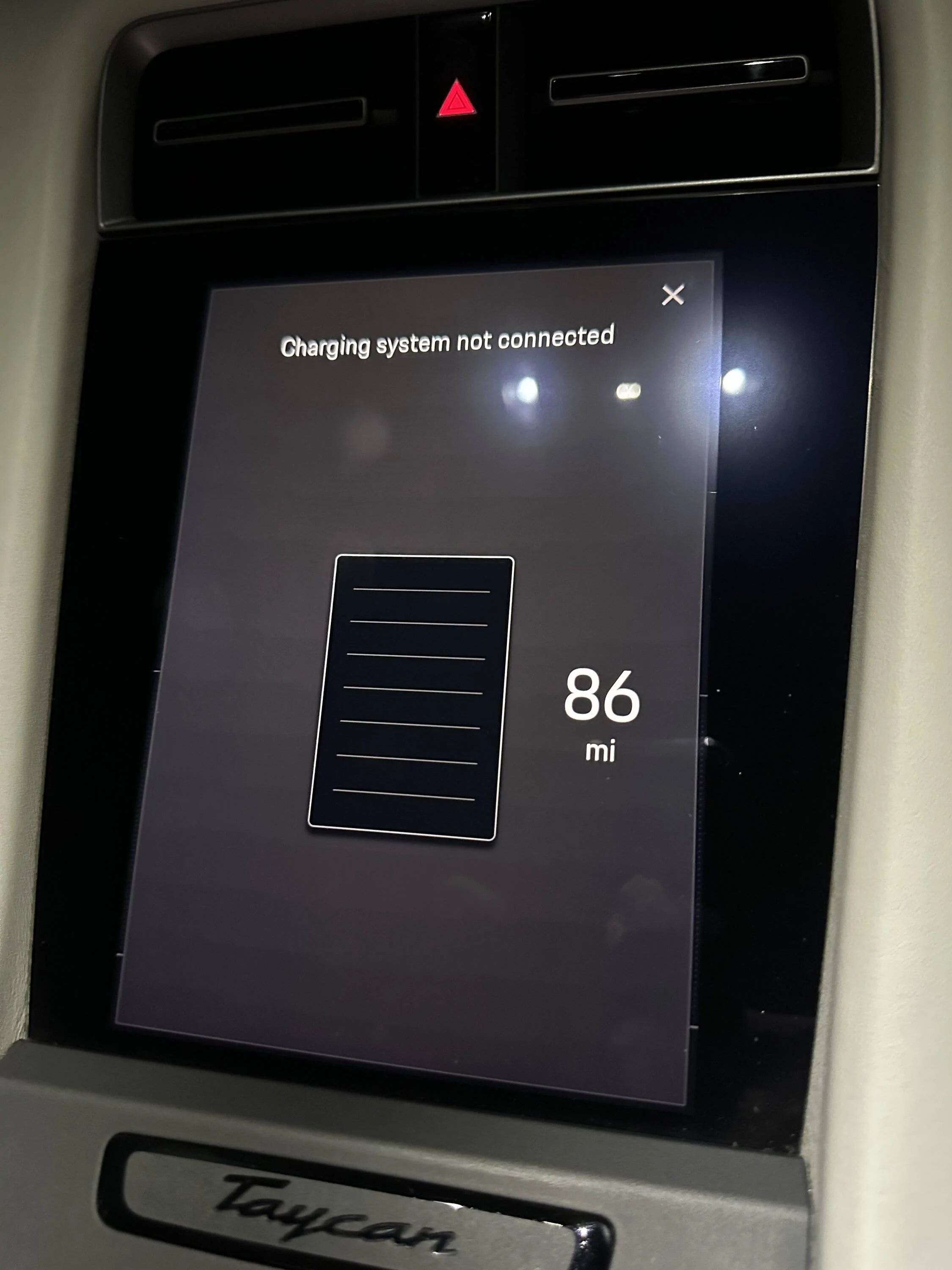

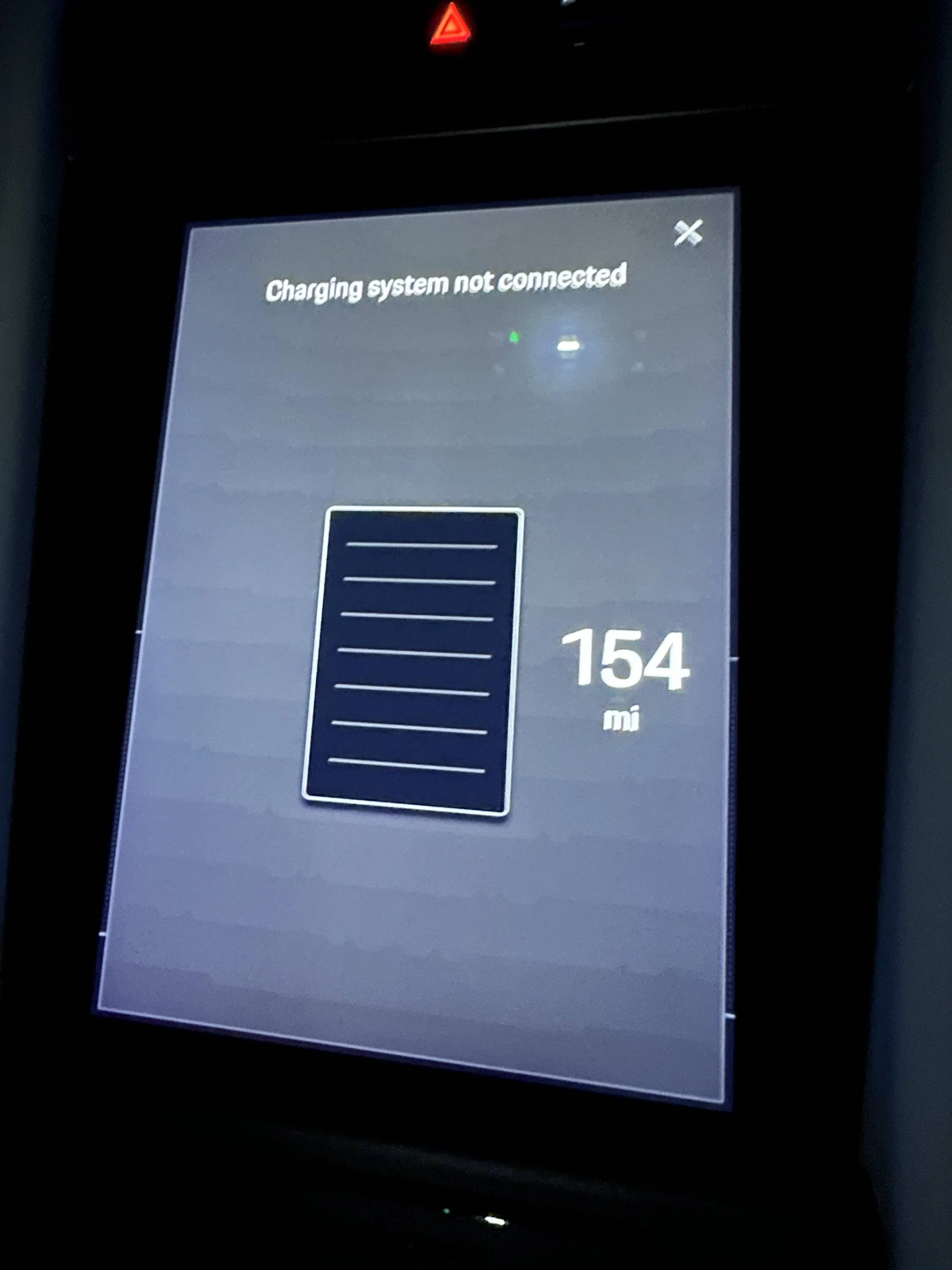

Hi all,
After a software update on Saturday I’m getting an error message “charging system not connected “ on the center console… car still takes a charge but doesn’t show the charge level and is stuck at 75 % reading… anyone seen this !?

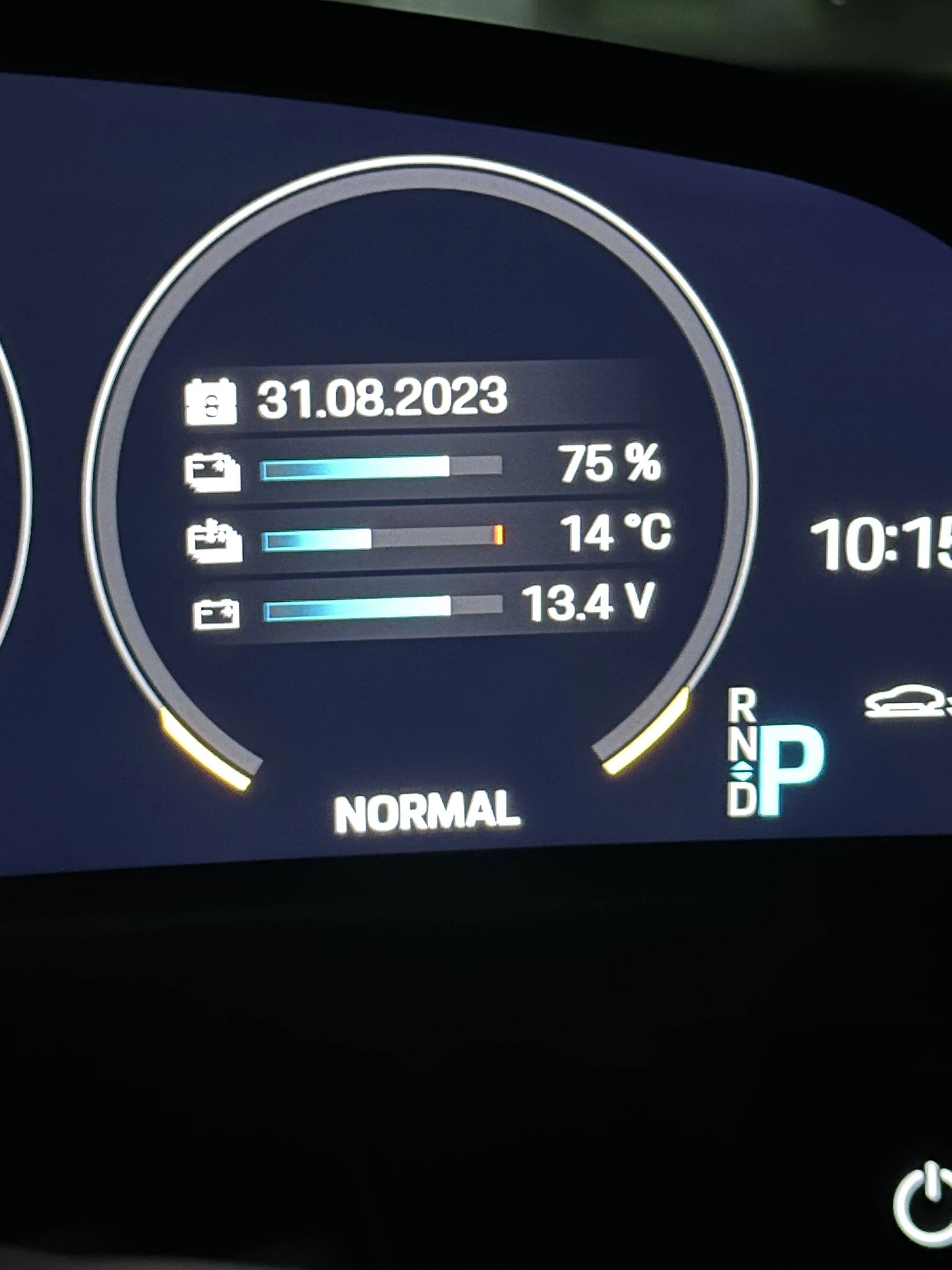

Anyone ?? Still getting this message if the car is charging or not charging… stuck on a reading of 75% regardless of what charge is actually in the car
Did you try to reset pcm with the two finger reset ?

Nope unfortunately it didn’t work ?

You might want to go through this thread section, especially concentrating on posts by @ciaranob. From afar, your situation seems like it may be related.
Thanks… went through that but none getting the same message as me and my car is still actually charging ok… just not displaying the charge etc !
