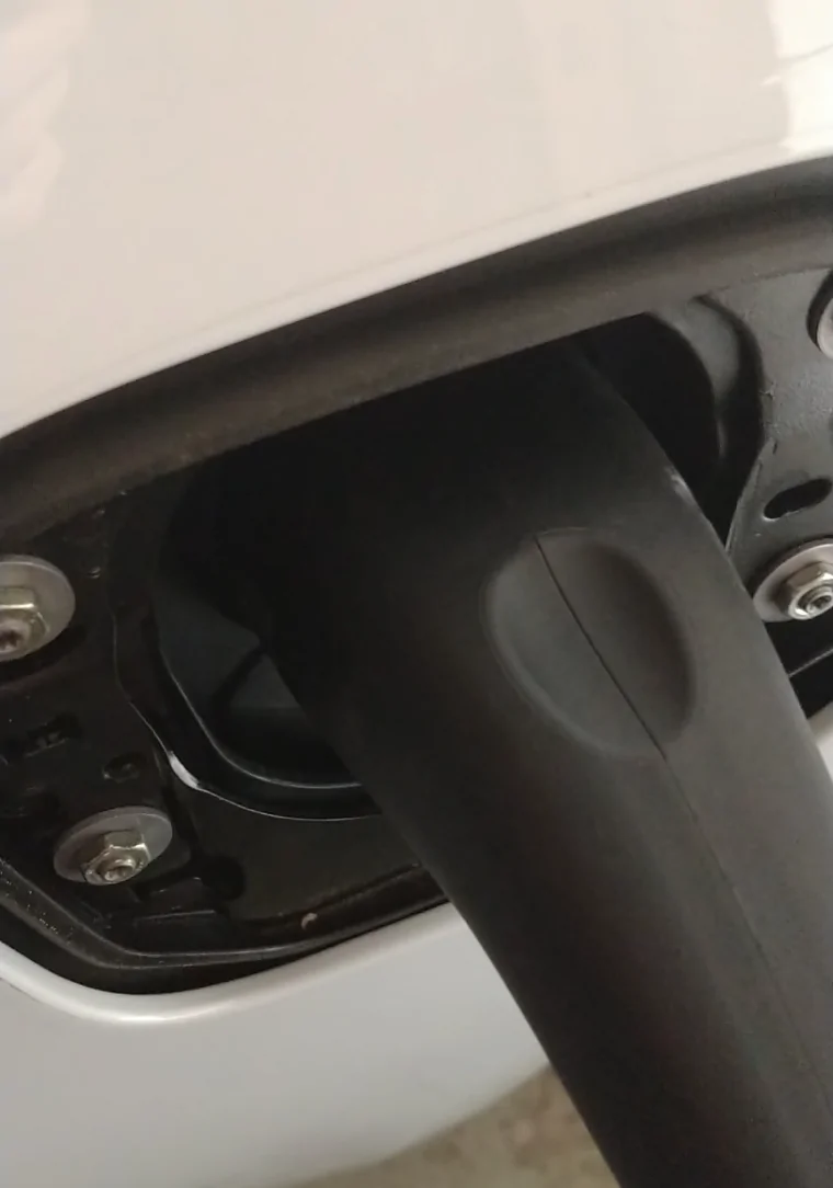

First time:
Last weekend I couldn't disconnect from AC charger at work.
I pulled the cord for emergency release, it disconnected.
The door wouldn't close though.
I drove home with the door open.
Next day the door was closed again...?
I tried to open it: nope, didn't work on both sides.?
I removed the cover with the tool:
Porsche Taycan Charging Port Impaired - "Left (or right) charging port impaired" error message Screenshot_20220312-203619
It didn't charge.
It looks like the locking doesn't work anymore cuz I can hear it trying to lock...(pulling the emergency cord made it got stuck?).
I pulled out the plug.
Literally...
After a few days the doors started working again!
But still the charging on the right side didn't work.
I called Porsche on friday and brought it in.
And you guessed right.....no problem whatsoever! ??
It charged without any issue...
I drove home to check at a fastcharger: no problem.
I tried at home: no problem.
Yeeee! ?
I checked today: doors won't open. ???
I think I still have a problem.
Actually two:
-doors won't open.
-can't charge after pulling cord.
Let's see what happens this weekend...

Forgot to report back.
At that time I brought it in again cuz it didn't work properly.
After replacing the sensor and free the emergency cable (and rerouted it properly) it all worked again.
And it still does.
