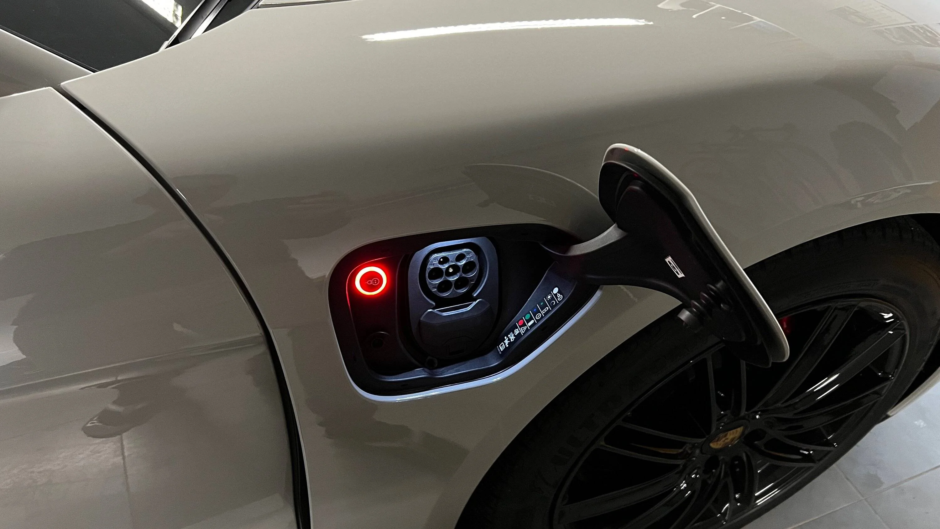

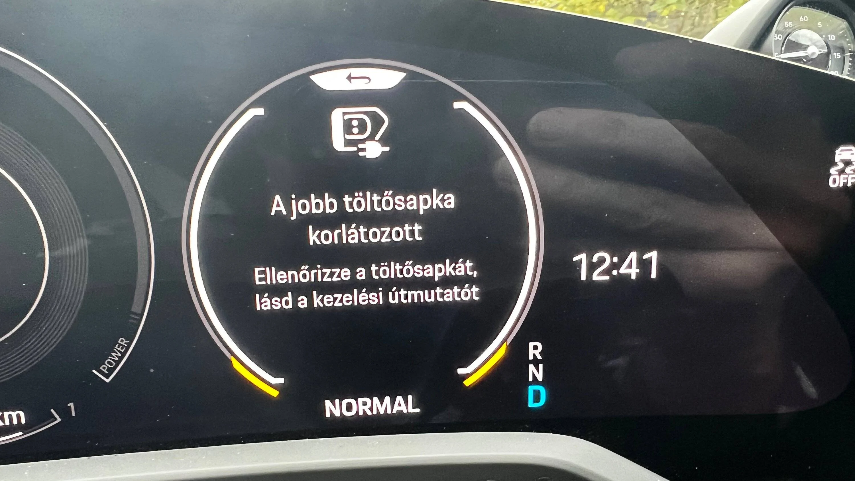

I have a manual one - NOT saving from this. Received the same message, red light etc. Spent a week in service, the door-locking motor has been replaced finally. Unfortunately if any of the locking/closing system become wrong, charging will be not allowed on that side, although I could open the flap. Additionally I had this failure on the DC side, so only AC charging was possible. Just got back from a road trip from Germany that time... what about if this happens on the highway where no AC at all...
NOTE: It started like most of you experience. Disappeared the message for days, sometimes for almost a week, plugged in/out and OK, left the car tried again later was ok etc. Before died and did not work at all. This began with a contact fault, sometimes ok sometimes not than brake the motor (door locking or closing one).

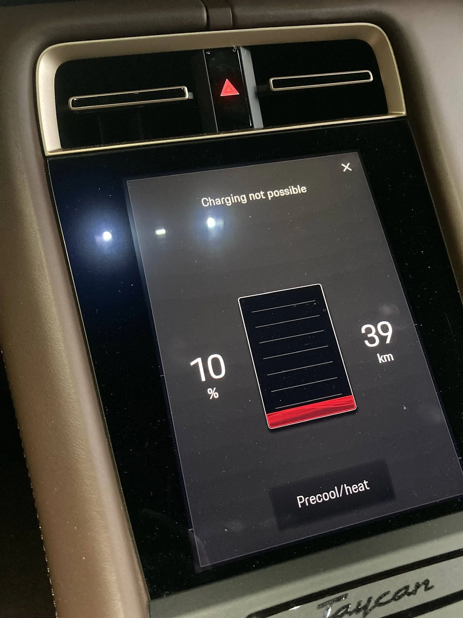

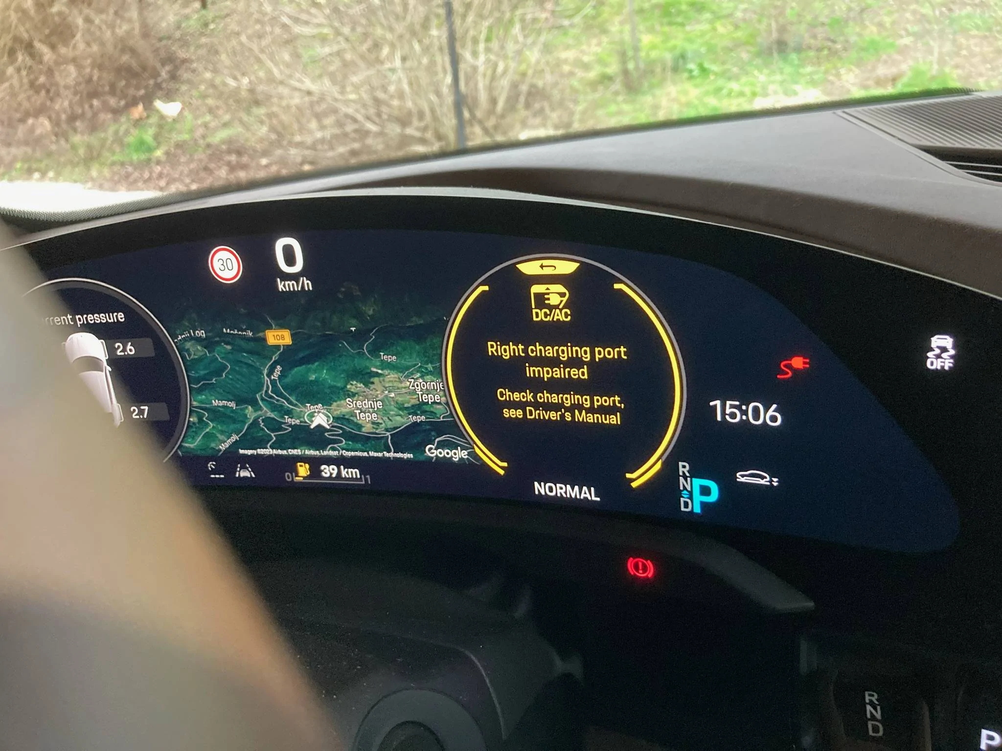

I just came home with 10%SoC, wanted to charge as usual, red error displayed: charging not possible.
I locked & unlocked the car, tried another (passengers’) port. Same error.
I sit into the car, switched it on, made photos below.
Then, I locked the car again, went into the house, came back after few minutes, tried again…and it started to charge :whew:
any ideas?
some more info:
- outside temp +12 C
-battery temp: 22 C
- Last trip: 123km, 52km/h, 22,6kwh/100km
I find I have to insert the charging plug dead square to the socket to avoid the impaired port message.
Initially I solved it by wiggling the plug in the socket as I inserted it but then someone mentioned making sure the plug was square onto the socket and haven't had the issue since.... fingers crossed ?

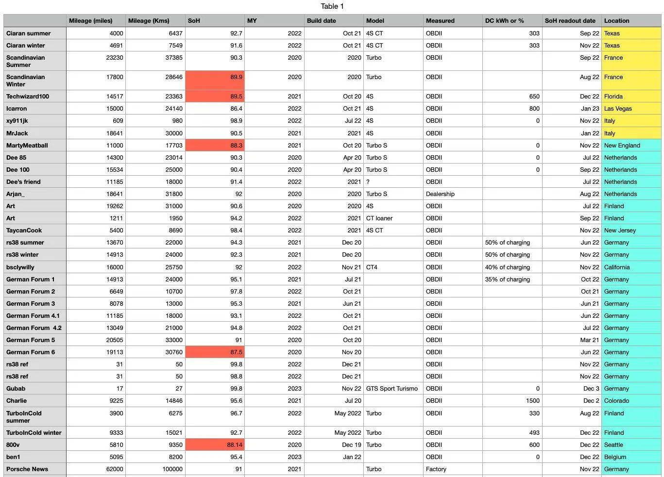

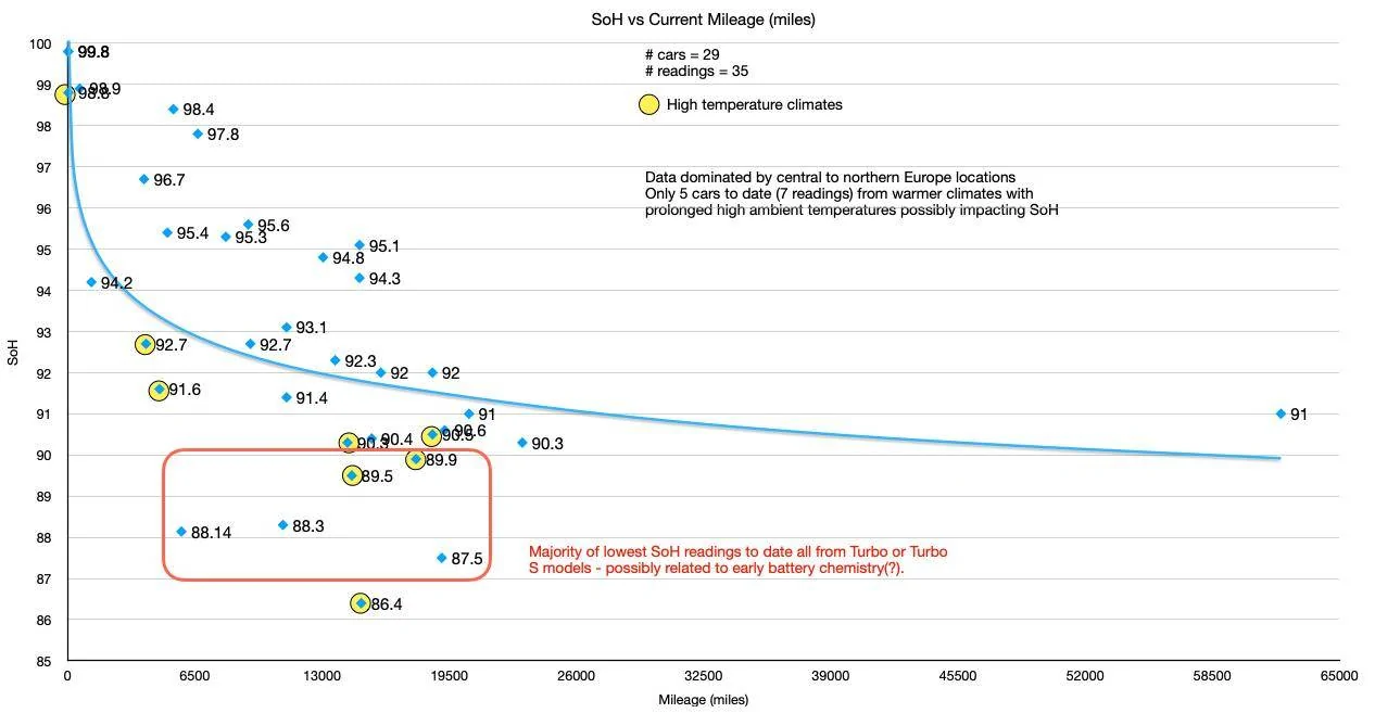

Well, the car run 12k km and 6 months old. According to the stats battery state of health around 90-92% at this stage. On the other hand we have ca. 9% battery reserve, they say most of it at the bottom.
Reactions: B61
B61
Bine
May 31, 2021
2,722
1,724
SI
Well, the car run 12k km and 6 months old. According to the stats battery health of state around 90-92% at this stage. On the other hand we have ca. 9% battery reserve, they say most of it at the bottom.
After 6 months, SoH already dropped to 90-92%?
