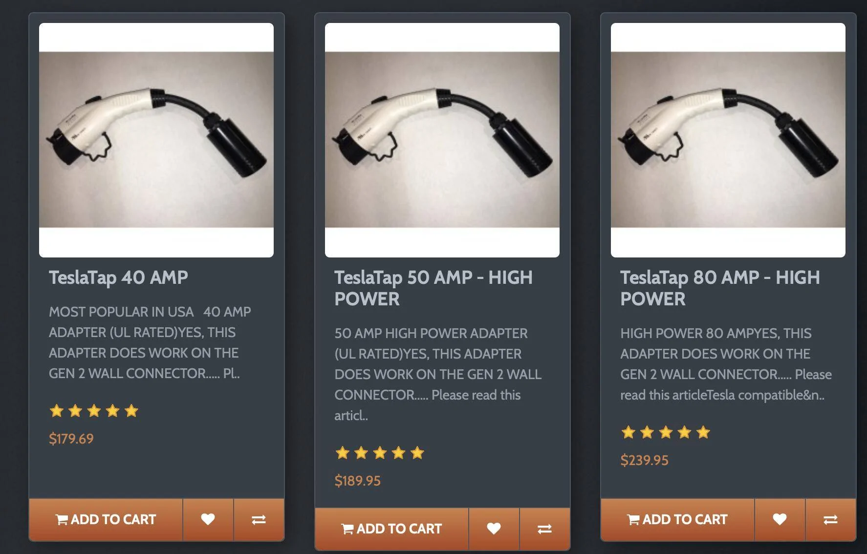

TeslaTap's product range…recommend the 80 amp version for Taycan - since that is well with in specification for 48 amp charge rate.
Porsche Taycan EV Roadwarrior adapters “kit” screen_shot_2020_07_20_at_4_15_46_pm_782446b604b8035ab09e98717dcb64a7fc746283

Drat!!! I have the 40-amp version. Anybody want to buy mine so I can "trade-up" to the 80-amp model?
