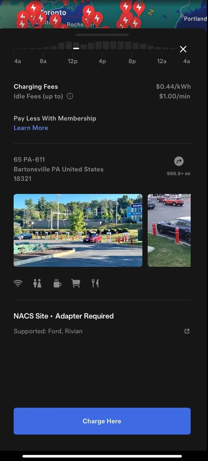

only Ford and Rivian are allowed at most Tesla Sites right now…
see screen shot below
Yes. There are a few stations that Tesla has opened up to all cars. There is only 1 located in the whole Bay Area. It’s in Scott’s Valley. It was pretty seamless when I gave it a try.
