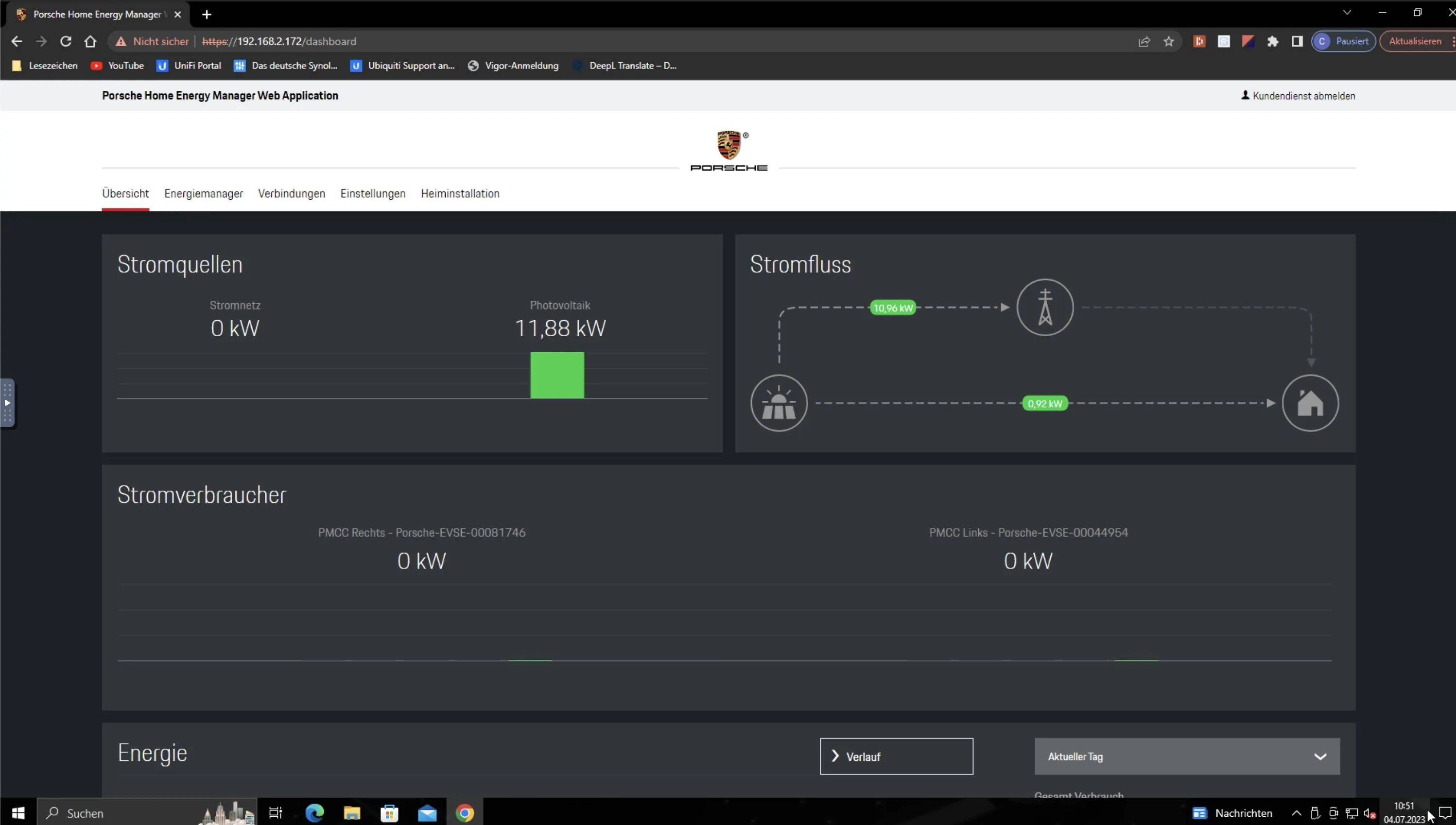

@cmaar do you have the charts of the PMCC devices showing this? And do you have coils for the HEMS installed at the wires going to your PMCCs ? Does this happen on both PMCCs?

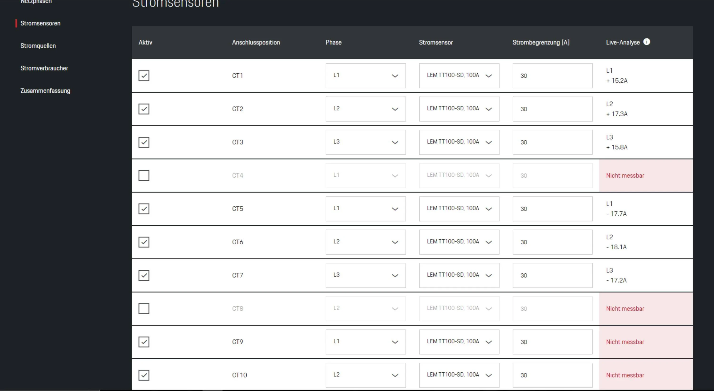

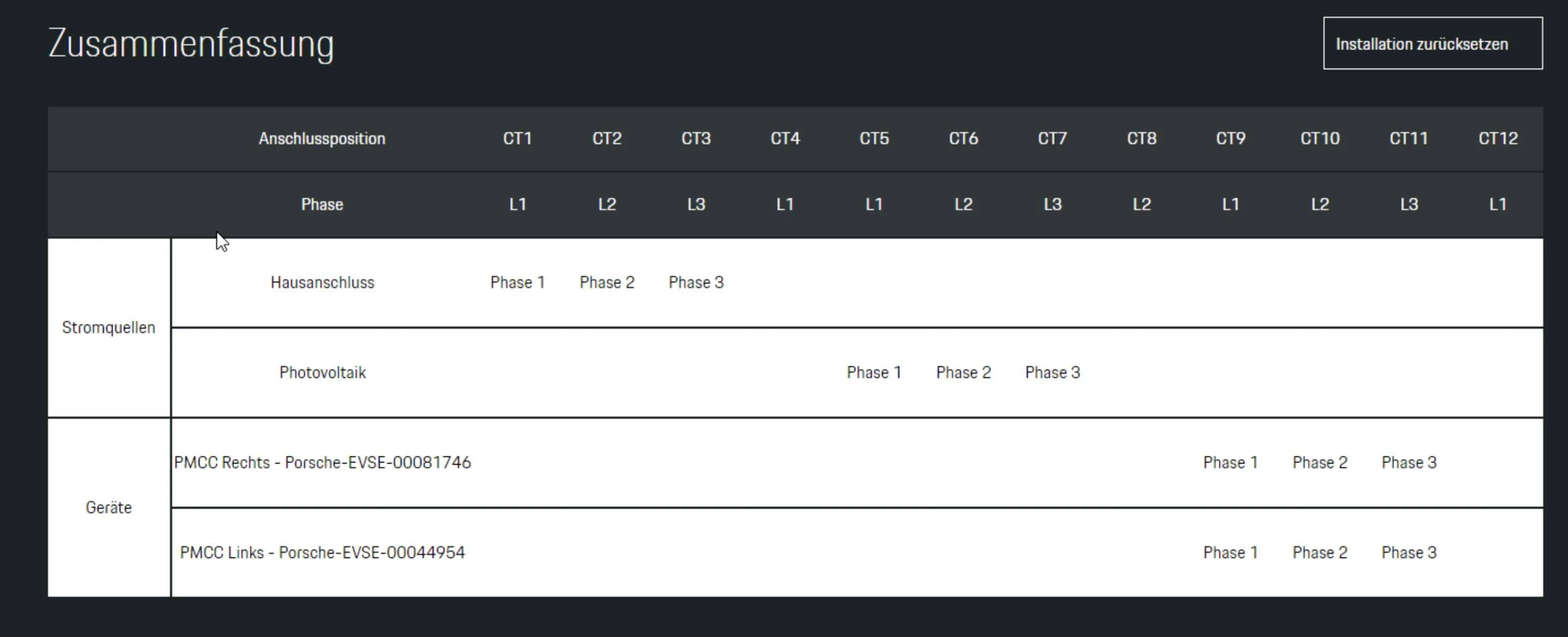

I have:
- 9 coils (3 * PV, 3 * grid, 3 * PMCC) all of them working properly
- as I stated Im using WLAN instead of PLC
- I managed it once to connect via PLC but after switching to WLAN I wasn't able to return to PLC (tried it hard at the weekend, I used the web interface of the HEM an the PMCC without success :-( )
- surplus loading during the day with sunshine works fine, the system modulated appropriate
Attached pictures show the actual state without a connected EV
