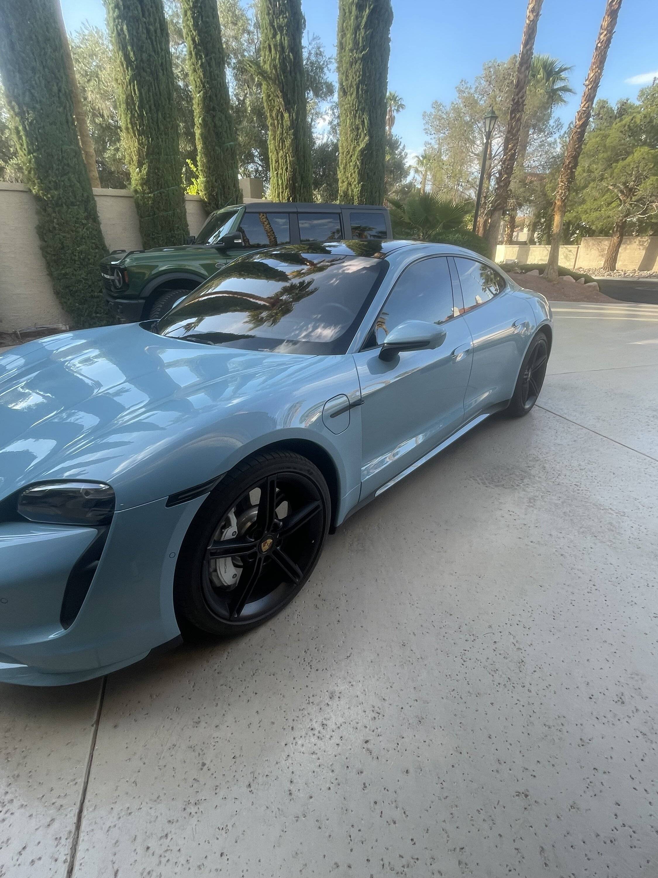

I’m new here. I bought a 22 Turbo last August. Unfortunately it was hit 8 days later. It literally took 7 months to get all the parts to fix the car. I have a slightly sour taste in my mouth. Nevertheless I’m headed to the parade on Monday which is about 241 miles from my home in Las Vegas. My app says I need a charging stop in Barstow for around 20 mins. I’ve signed up with Electrified America ? Everything seems pretty straightforward but I am still experiencing range anxiety at home. I have been reading posts about tire pressure and car set up. Temperatures across the desert are expected to be over 100 (air conditioner a must)with possible heavy winds. Is there any suggestions or anything I need to be aware (wary) of?

Is that blue a PTS variant or just std and, as in shade, looks different to me? Have to say possibly the first pic where I'd say the factory white calipers look really good against that color.
Congrats on getting her back - now just enjoy the ride - this trip will wash those 7 month blues away :)

Thank you for the advice. it the standard frozen blue I believe but I didn’t like the matching blue rims so I made them all black. That could be the difference and it does make the white look much better. im Excited to try this trip and missing my 911 platform just a little bit. Hopefully whenI return home I’ll be in love again!

Agree 100% re black wheels :)
Def not a 911, nor is it meant to be, but an absolute blast in it's very own and unique way :)
Whilst you'll notice the weight in certain maneuvers, for most 'spirited' daily driving you're going to be real close to the 911 'planted' and responsive feel.

Sorry about your terrible misfortune and glad you can now enjoy the car. I've said it many times before, but I never tire of seeing the combo- maximising black details and minimising silver ones does something magical to FB in my eyes, intensifying the saturation.
