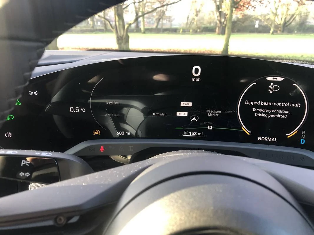

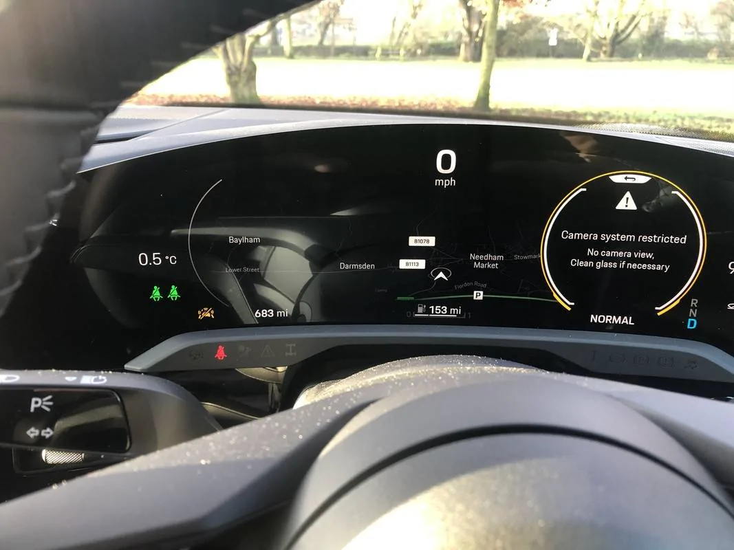

So, nothing serious, but 3 sets of warming lights today. It was a frosty morning, and I’d left the car outside last night.
Used pre heat to warm car up and it did this very well.
Got in and drive off and got, various dash warnings. Cameras not working, brake assist not working, headlight fault. Carried on driving to destination and all gone when re started.
What do we think, a frost sensor of some description?

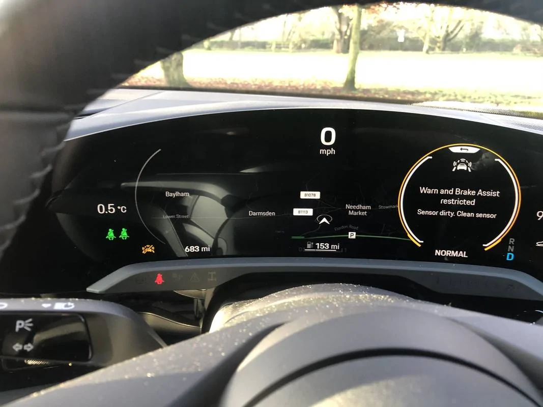

I got the sensor dirty warning too this morning. Very frosty here so assumed it was ice or something similar obstructing the sensor. Went away whilst driving.

I got the warn & brake assist message. I’m sure it’s linked to the adaptive cruise sensor but don’t quote me on that.
Definitely frost being the culprit in my case.
I had a Cayenne turbo that used to hate inclement weather & would throw a fit in heavy rain, amongst other of mother nature’s nasties. The Taycan has nowhere near that level of sensitivity...... Yet.

Clean your window.
Sensor in the windshield is probably obstructed by frost or damp.
Your car is kinda "blind"...

windows were perfectly clear and clean. Had been on pre heat and nicely defrosted screens all round.

I experience all of those messages quite a lot and have done since bought the car. Even when spotlessly clean. I believe that the sensor (up by the rear view mirror) is one of the last parts of the windscreen to demist and that is what causes it. When my car is warmed up and dry It doesn't happen. Next time it happens, get out and inspect the centre of the windscreen, I suspect you will find condensation on the sensor window.
Will do. Not great if it is this though as loads of cars have sensors here and no issues. Bit odd if so.

Get those messages all the time. Just ice, damp & dirt. You should try driving up here for a few weeks ?
