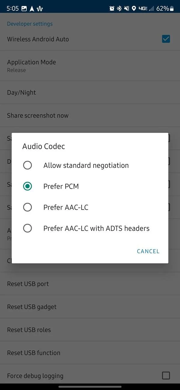

Fixing the lower quality:
1. Enable Android auto > developers options > Audio codec > prefer PCM
This makes sure that audio streamed from phone to PCM is lossless.
While some may argue that we don't need lossless codec, I disagree. Even when streaming YT music in "High", I can notice less audio artifacts when lossless transmission is used.
p.s. Android auto wired or wireless uses same codec, so that doesn't affect audio quality. Perhaps Apple CarPlay needs to be wired for lossless audio codec.

I think those settings are excellent! Thx for the tips. Something in those allows unlocking lossless communication. Tracks from Tidal sound phenomenal on my Burmester now.
