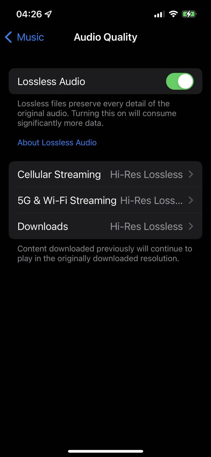

Burmester in the Taycan is the best sound system I have heard in a car. Pair that with the Apple Music and make sure you are using the 3D sound function and you will never want another sound system again. Hands down, the best.
