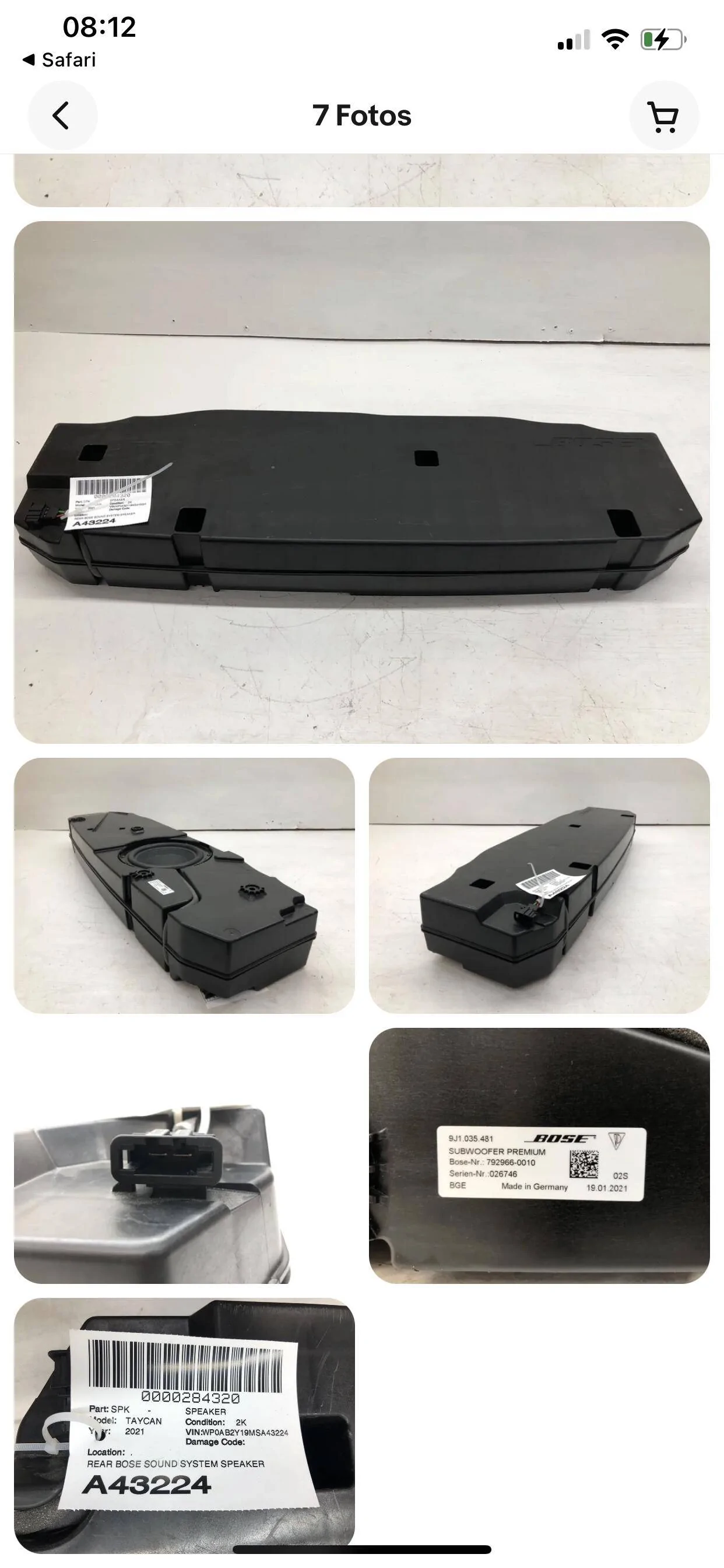

I have found Original Bose Subwoofers and Speakers for the Taycan on some Online Shops. Anyone has experience with installing this?

You also need to BOSE FW in the headunit, otherwise filters will be skewed.
You'll also be needing an amplifier....and if going down the aftermarket amplifier route, while you are at it, i would have someone put together a tailored aftermarket subwoofer solution instead. It will undoubtedly sound much better.
