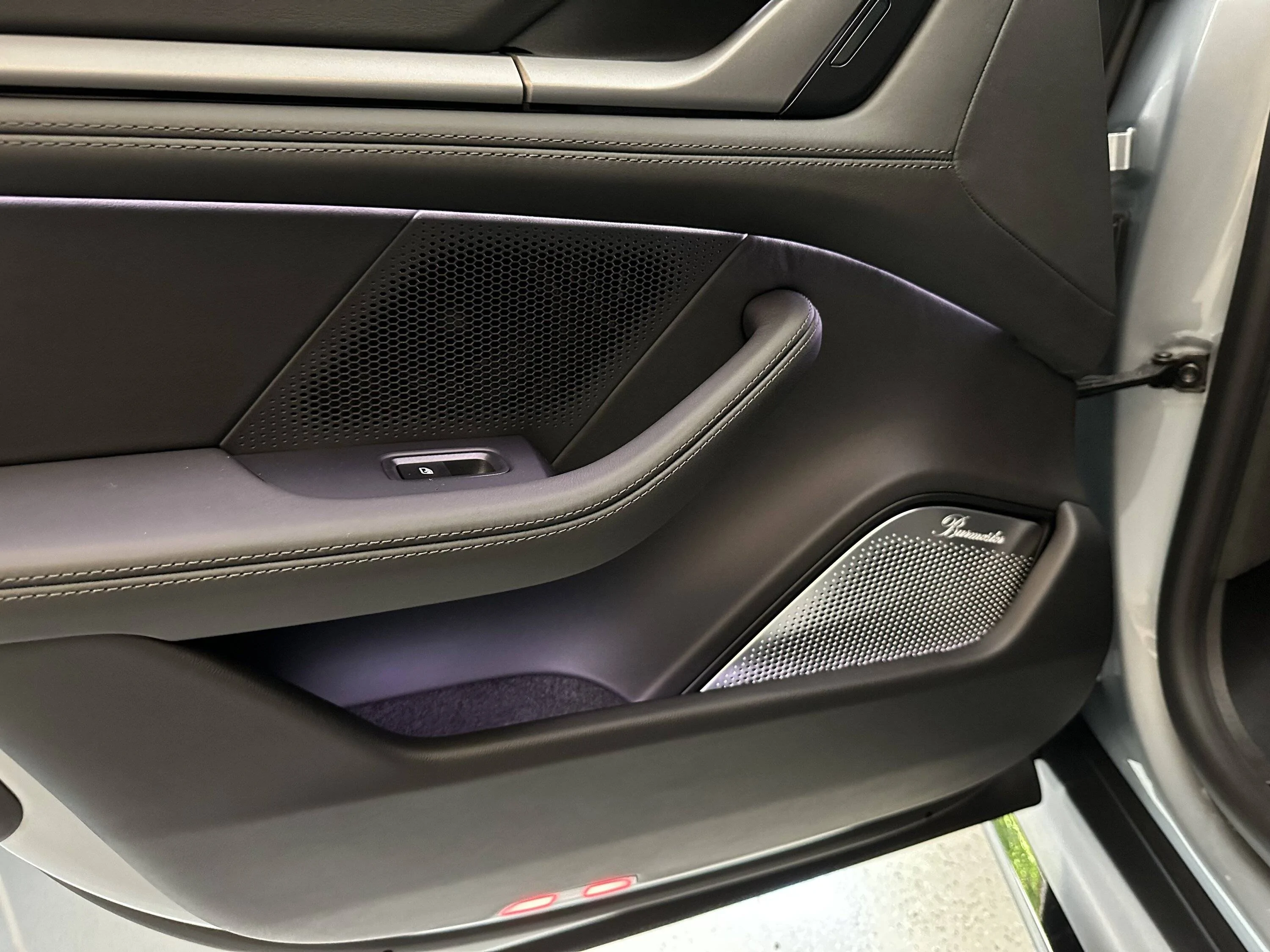

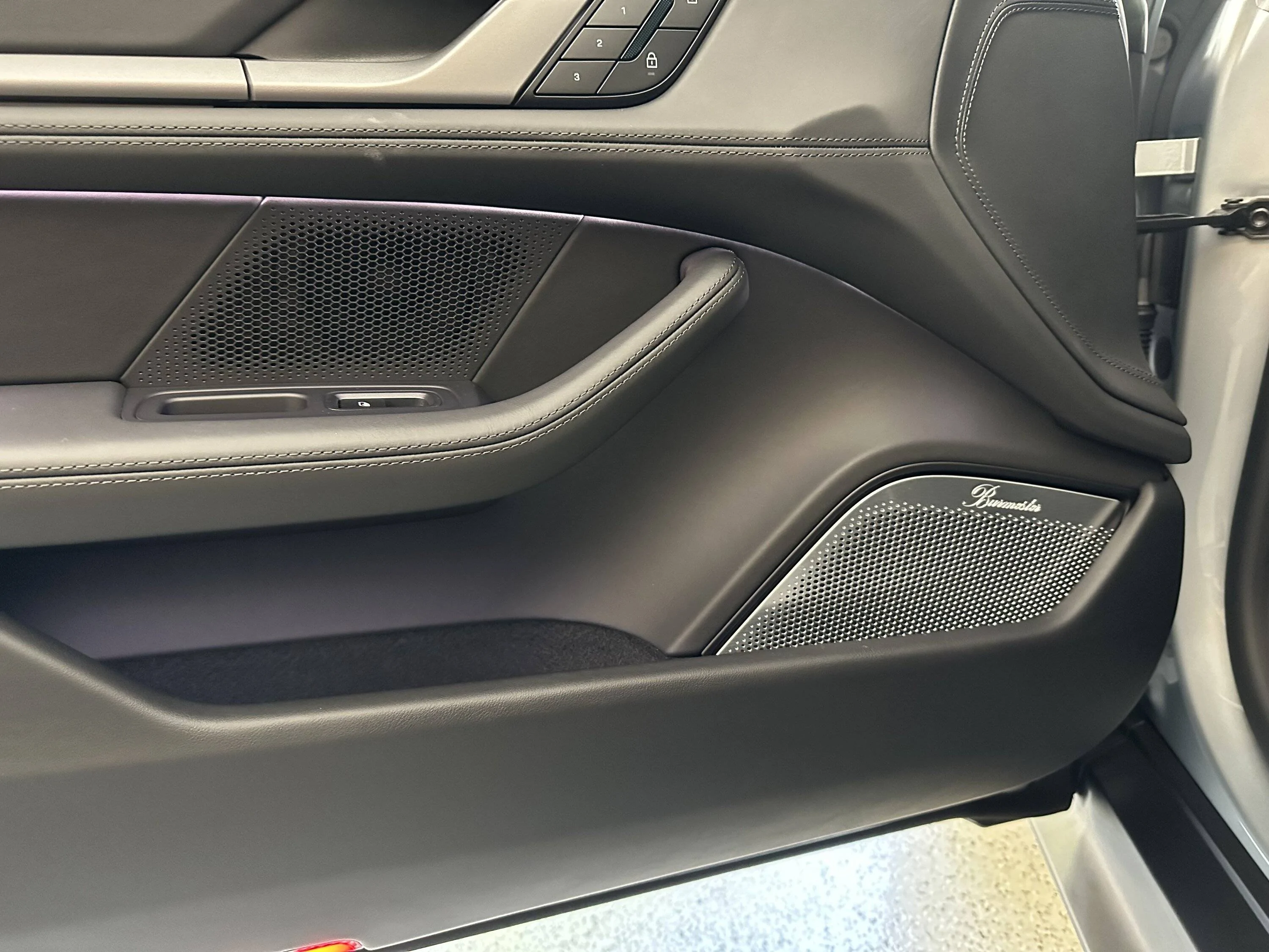

Front Door:
You can see from the photo there are two speaks in each front door. The first speaker is in the middle of the door above the handle with no logo. The second speaker is at the base of the door behind the storage bin with a logo. I don’t like the mix and match here, one has a plastic cover no logo and the other a metal cover with logo. They should look the same. I don’t like the polished metal, better with a mat finish. The speakers have no backlight capability unfortunately. The Burmester brand in italics looks medieval in a modern EV Porsche. So the aesthetics aren’t the best. Then in the second photo you can see the design snafu. Rather than the speaker being recessed in a fitted way into the storage bin facade, it is actually recessed behind it and about one third of the speaker is below the top of the facade. This is very disappointing from an appearance perspective, and while I’m not a sound engineer, I have no doubt the sound experience is impacted.
Porsche Taycan Burmester sound system option IMG_2523
Porsche Taycan Burmester sound system option IMG_2559

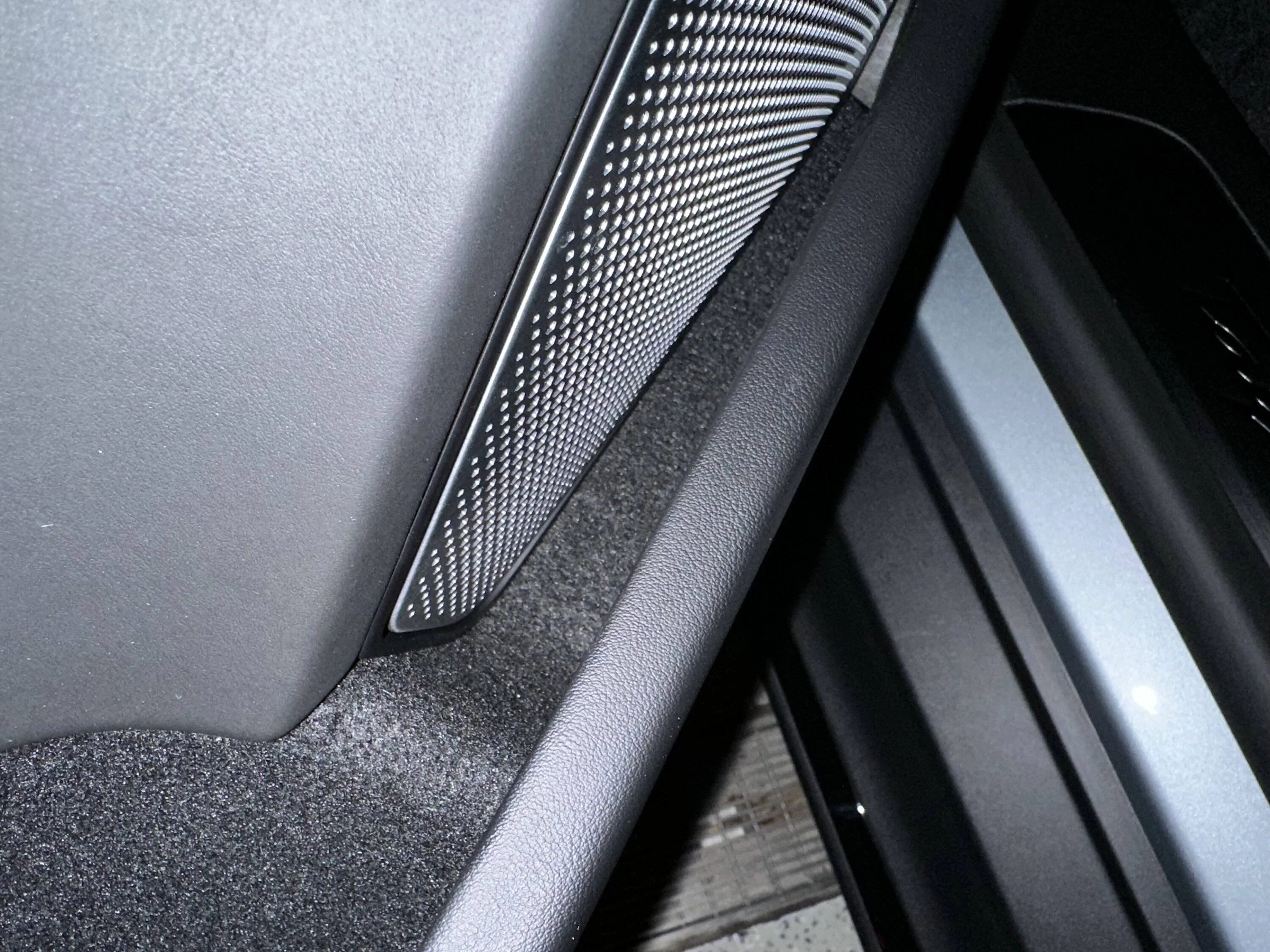

Rear Door:
The rear door is similar to the front door, however we are losing a bit more of metal covered speaker behind the storage bin facade.

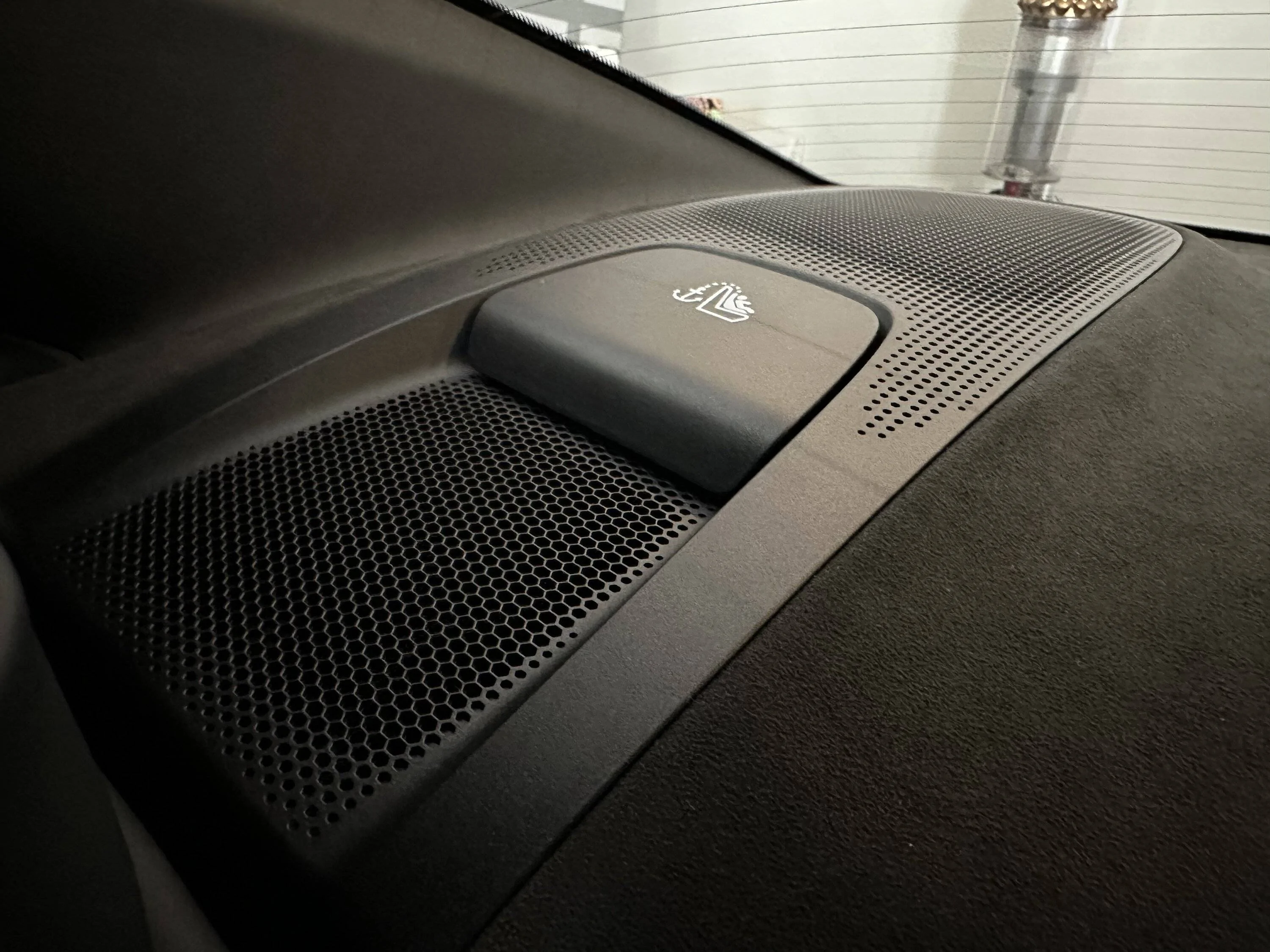

Rear Shelf:
There are four speakers on the rear shelf, you can see the two left side speakers in a single plastic enclosure with no logo.
Porsche Taycan Burmester sound system option IMG_2521

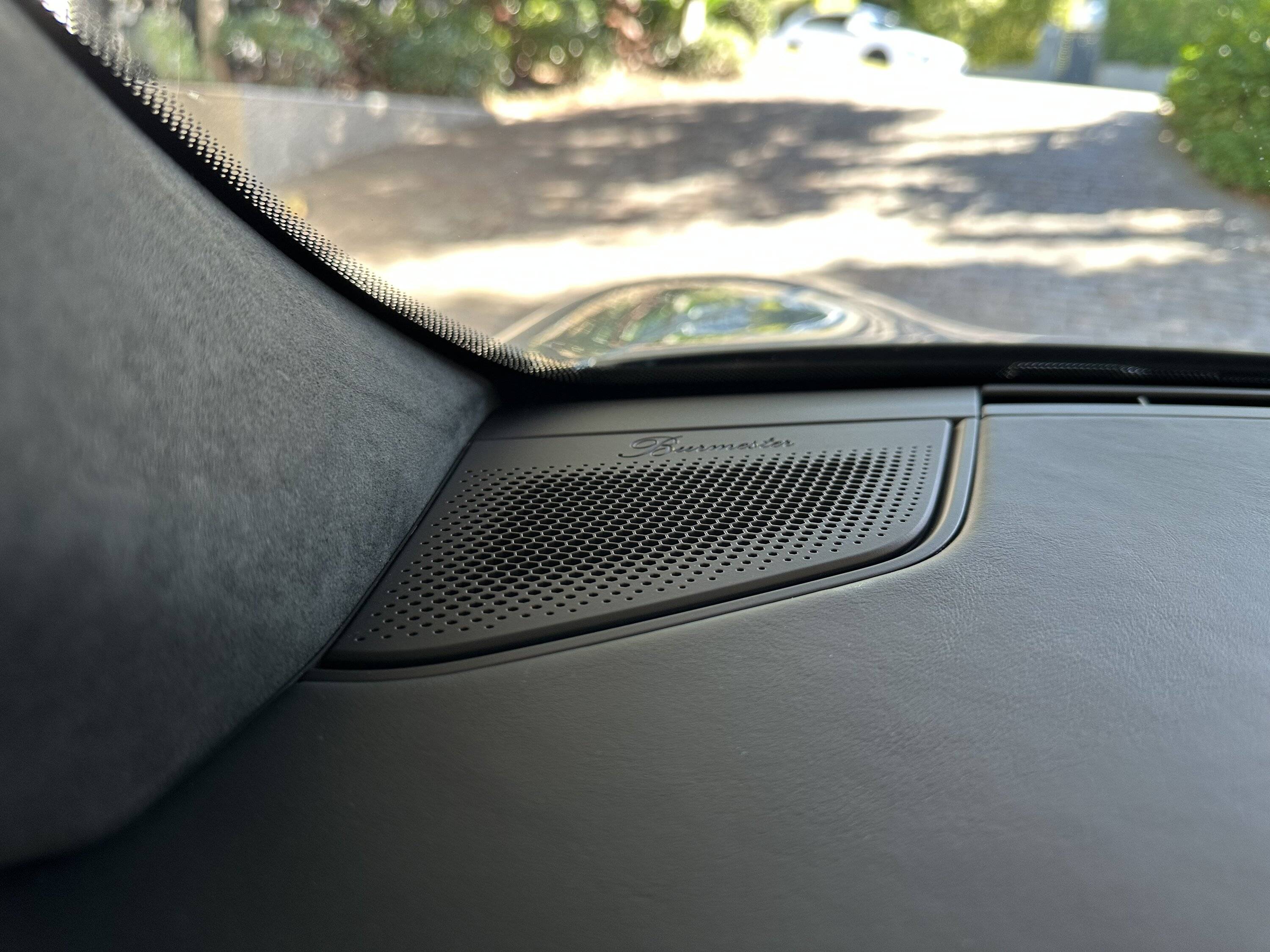

Front Dash Side:
There is a speaker on each side of the front dash, in plastic with logo.
Porsche Taycan Burmester sound system option IMG_2527

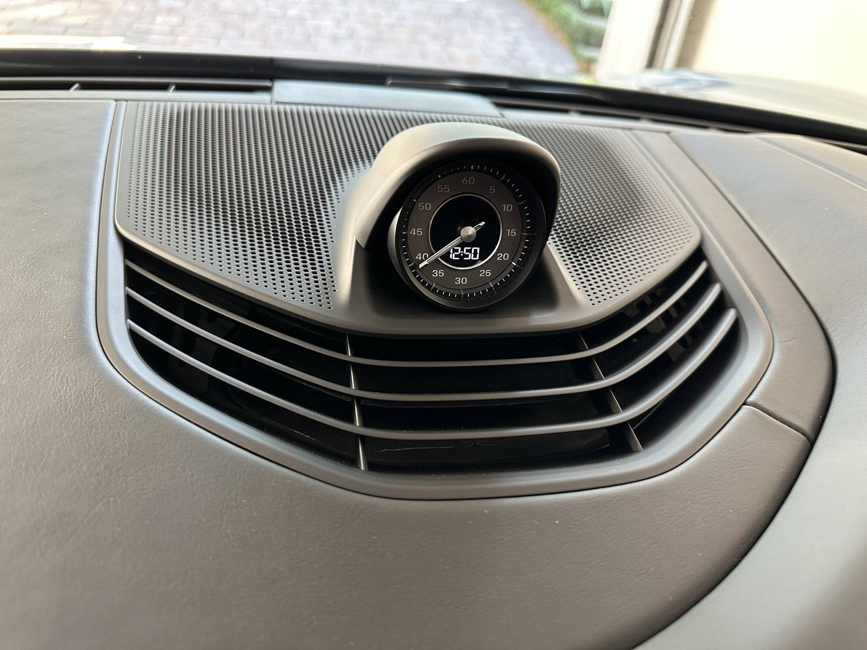

Front Dash Centre:
There is a speaker in the centre of the dash, in plastic with no logo.
Porsche Taycan Burmester sound system option IMG_2528

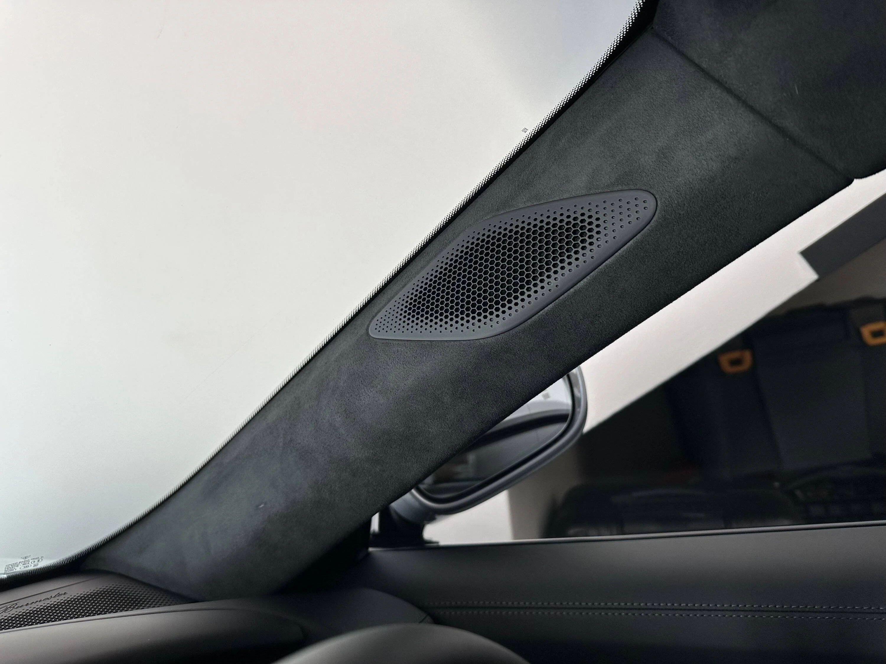

Front Pillar Speaker:
There is a speak in each front pillar, in plastic, a slightly lighter colour of grey than the other plastic speakers, with no logo.

I also have burmester. What disappoints me most is the poor vibration suppression. I could fixed most of the rattles but it’s so disappointing there are still some. The only way to fix that is a full disassembly of the doors, which I don’t have time for.

Also have Burmester and agree with your assessment. Best OEM Ive had was B&O in a Q7. That was really good but also quite a bit more expensive than even the Burmester. Also have B&W in my X5, cheaper than Burm. But better. Now I must say that I haven't experienced the full potential in the Taycan due to design or assembly mistakes. I have dismantled the doors and there is an issue with all drivers mounted directly in the panels. There is not enough clearance between membrane suspension and the doorpanel, so at high volume, the membranes will actually touch the support base and distort horribly. Dont know if its a general design flaw or if they changed supplier of panels with bad tolerance. I have another post with pics. Describing the issue. I have fixed the above issues, but still the doorpanels themselves are to soft an rattles. Download frequency sweeps from spotify 30-100Hz in steps of 5 hz, use the fader to direct sound to the individual (more or less) and experience how bad it is esp. From 70-100 hz
Shiny front panels are a Burmester trademark if you look at their HiFi kit.
The lower speaker in the front doors is an 8” bass unit with all Taycan audio including the standard and at frequencies of longer wavelength than twice the gap from the loudspeaker driver to the storage bin won’t be affected much, so from around 1500Hz and up, so from an acoustics pov this isn’t a problem - though it may be a small one if you fill the door bin simply reducing the area.
After years of expensive disappointment I realised the laws of acoustics guaranteed limited sound quality in a car so don’t stress over it any more.
Digital signal processing can mask a lot of the problems nowadays but there is no actual solution to the fundamental problem that the position of both the listener and the speaker drivers is inevitably always wrong for good sound.
It is polishing the turd, though DSP turd polish has come quite a long way in recent years..
