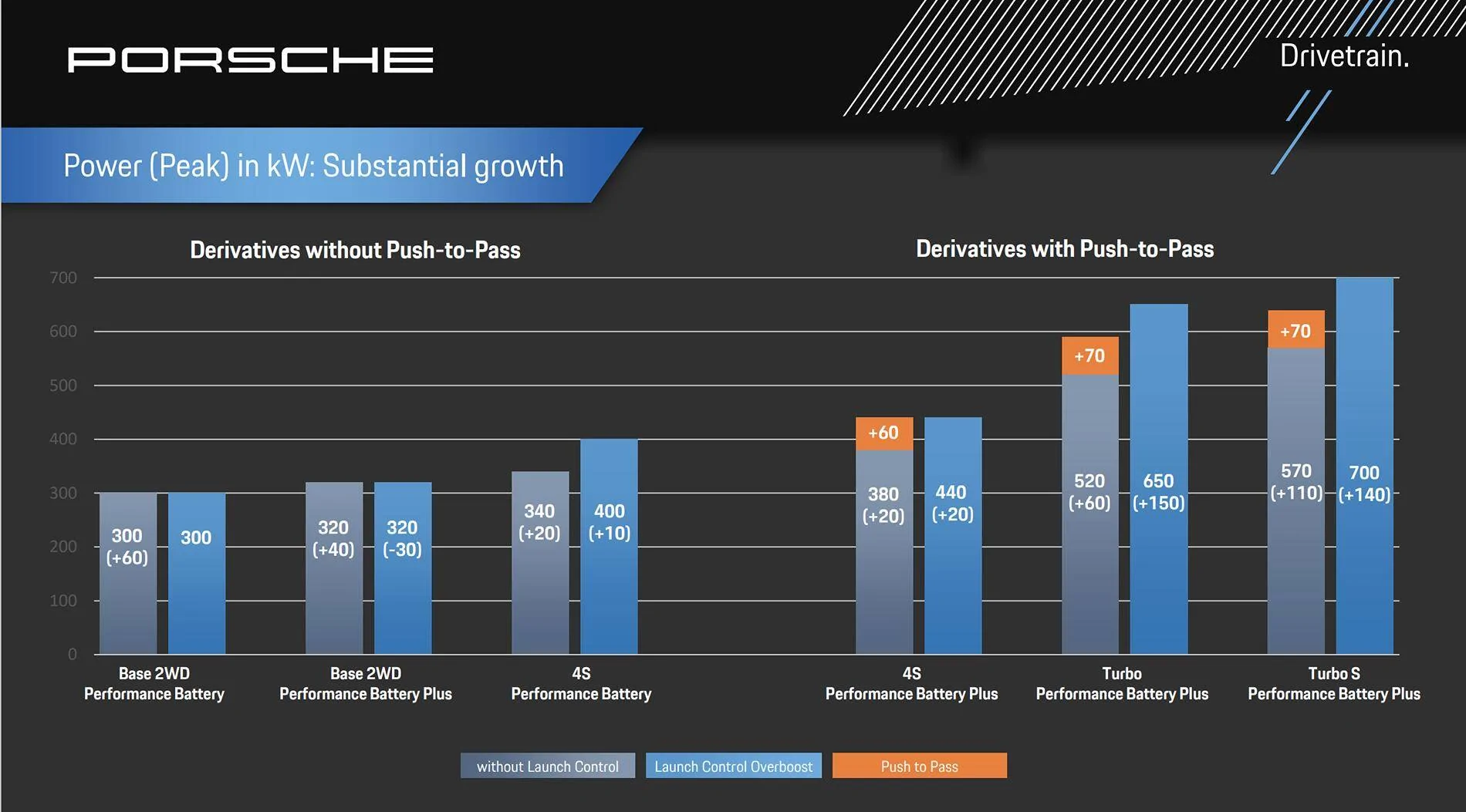

This graphic shows the power increases of each variant vs. J1.
So your 4S would fall into the 3rd column from the left with 340kw/400kw figures.
