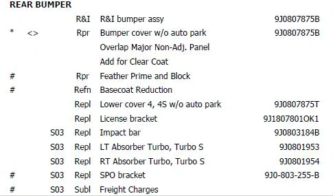

@mikezhang31 did they also replace the black trim part of the rear bumper (where the red reflector and the pop out piece is) ?
What about the undertray diffuser under the black trim of If please lmk the part numbers.
mikezhang31
Apr 26, 2023
151
229
This is all the parts replaced or repaired that was classified as rear bumper:
Porsche Taycan Got rear ended with a bike rack 1741780313473-7k

Yep, the lower cover was replaced, thank you!
