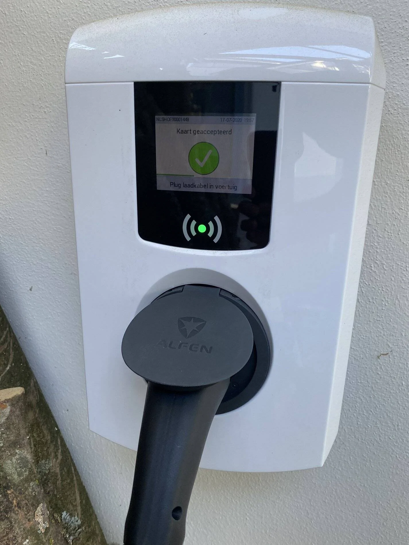

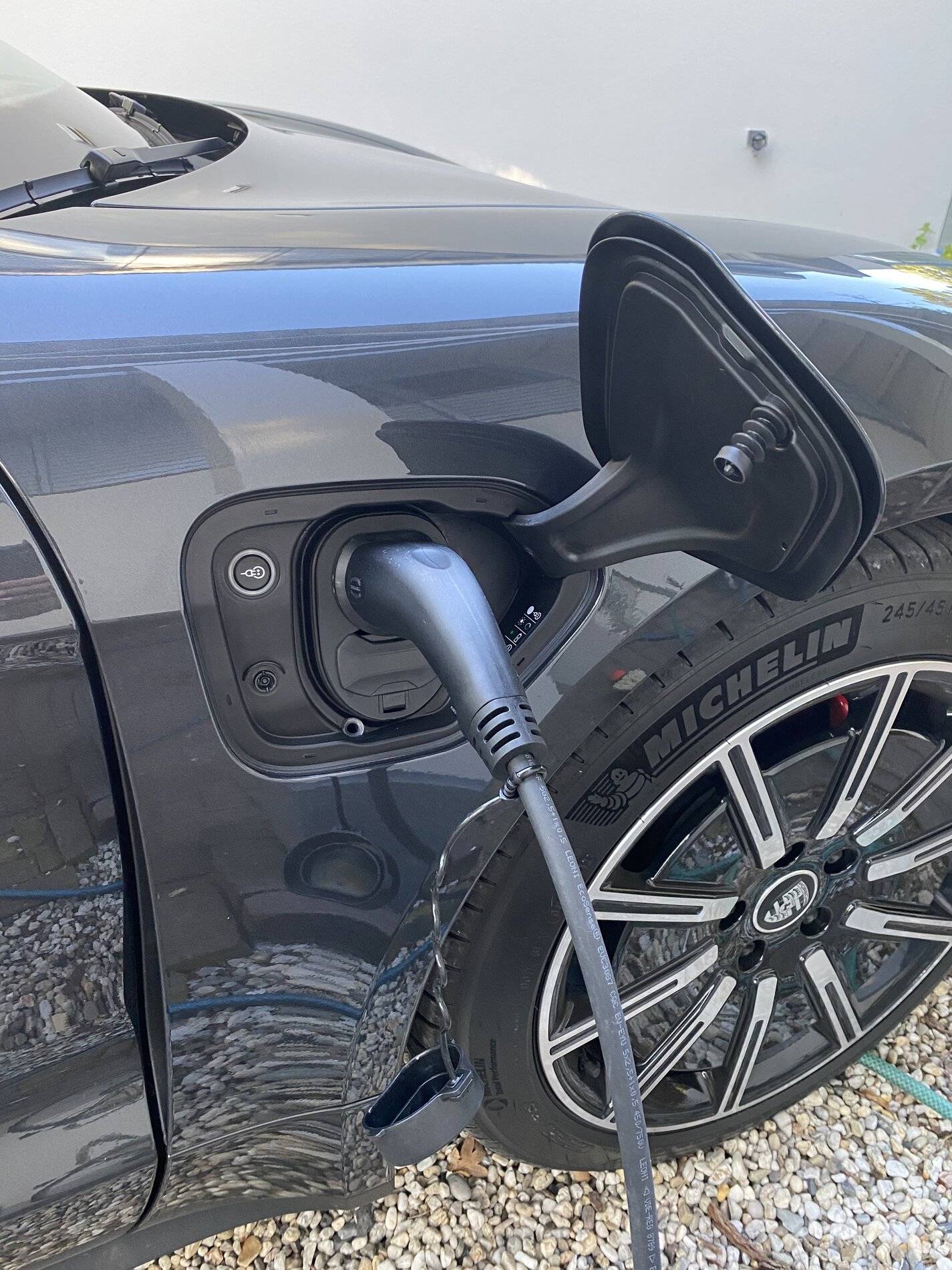

Can anyone help with this question? I have a home charger (see pic) and just received the card needed to get the charging going. Both ends of the cable are plugged in. The wall mount still says “plug in cable in car”. It does not charge.
Perhaps it matters that the car is at 80%? Any thoughts? Thanks a lot.

This does not look like the Porsche charger/where did you get the connect cable?

This is the cable I received with the car. The wall mount was delivered and set up by a Porsche approved company. The wall mount reads card approved, please insert charger in car. Which is where it is.
