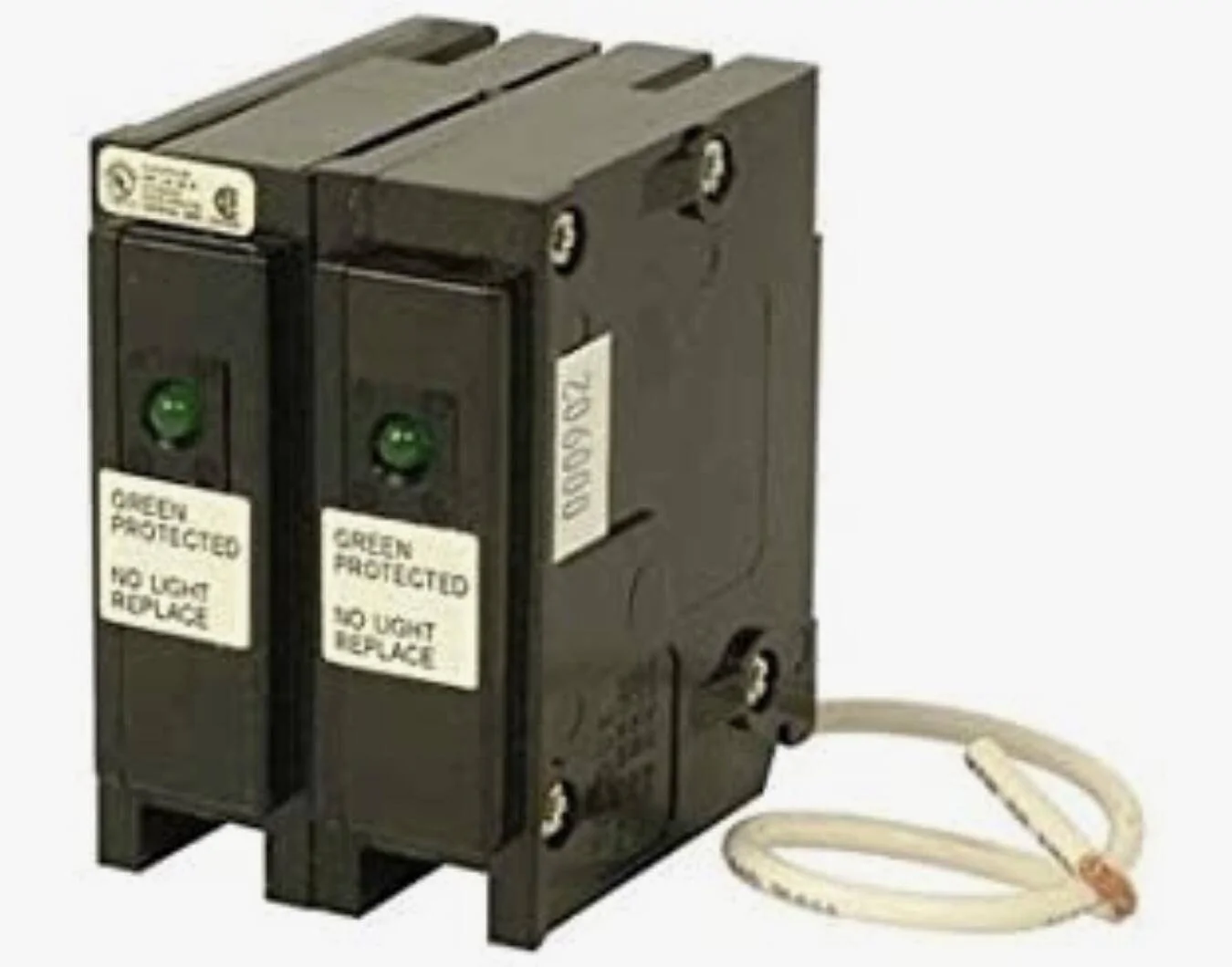

You can add a whole house surge protector to your electric panel. Two of them (1 for each 110v side) install like breakers and have a green LED that indicates they are operating. They just need to be matched to your panel.
Good for the entire house.

As @365B said, you can add surge protection for the whole house. I had two installed as part of a whole home generator project last year. However, I don't think surges would create heat. They are momentary in nature and tend not to have a lot of total energy (just high voltage). Suggest having an election check the quality of the plug, socket and the connection. For high current service, the plug needs to have a very tight fit with the contacts in the socket. If not, arcing can occur creating heat. Also suggest confirming amperage spec on your plug to make sure its within spec.
Good luck
