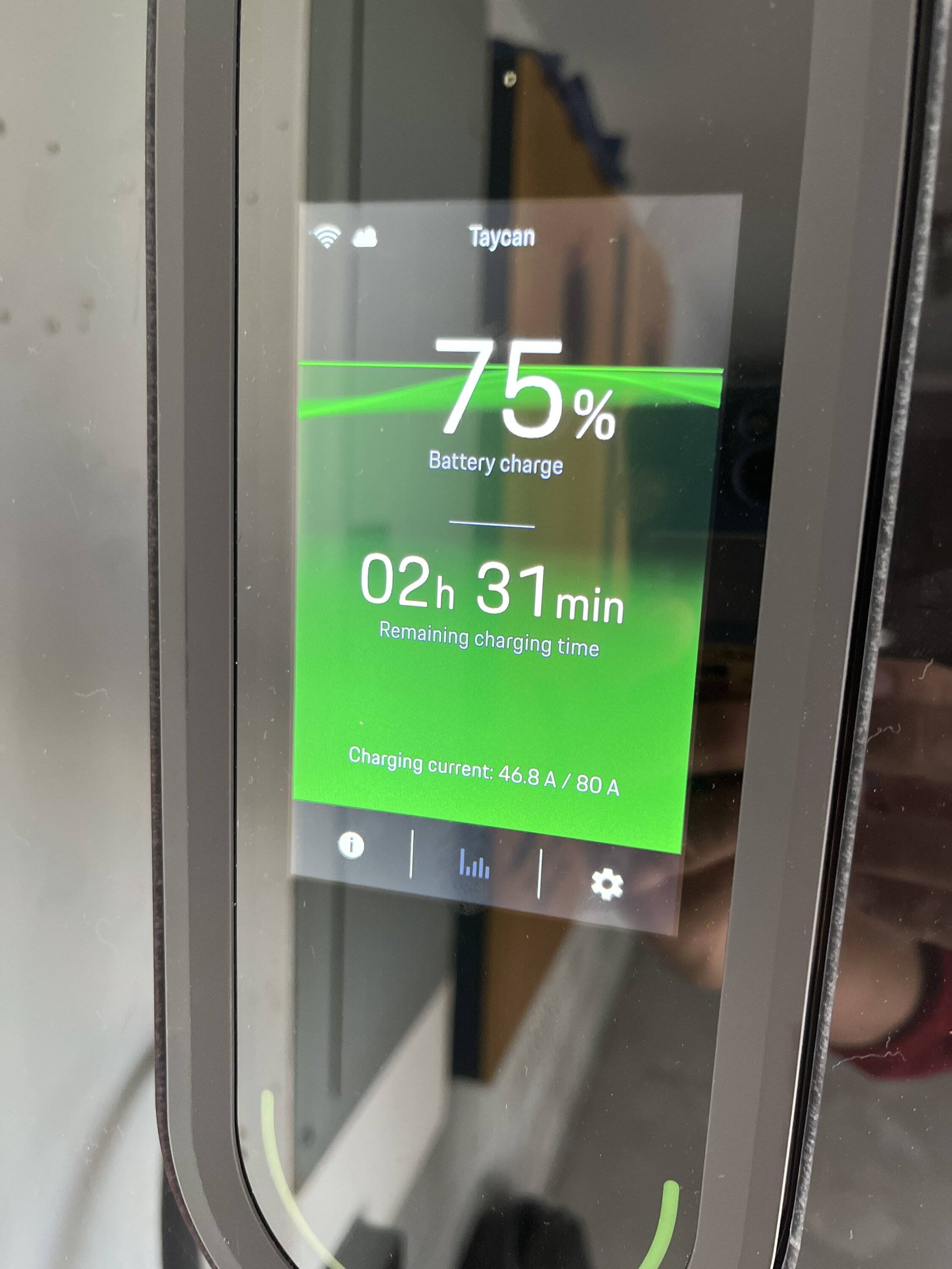

Question, just installed my new Porsche 19.2kw home charger. My car is at 74% when I pulled it in
When charging I have the setting max to 80a on a 100a breaker.
I am only getting 10.4 kw into the car. Should it not be 19.2?

standard Taycan is 11 kW (48 amps) - 19.2 kW is a $1680 factory option or a $5000 dealer service retrofit
based on the screen it appears your vehicle does not have the optional 19.2 kW option.

Crap! How can I tell what my car has? I can’t find my spec sheet right now.

your car is behaving exactly inline wiht expectations for the "standard" included onboard charger - your PWCC shows 46.8 amps - which is just shy of 48 amps (expected) for 11 kW "raw" charge rate.
the PWCC will charge other EV's at a full 80 amps if those EV's have 80 amp (19.2 kW) support.
the install is a one and done thing and good for future EV charging - you are future proof.
