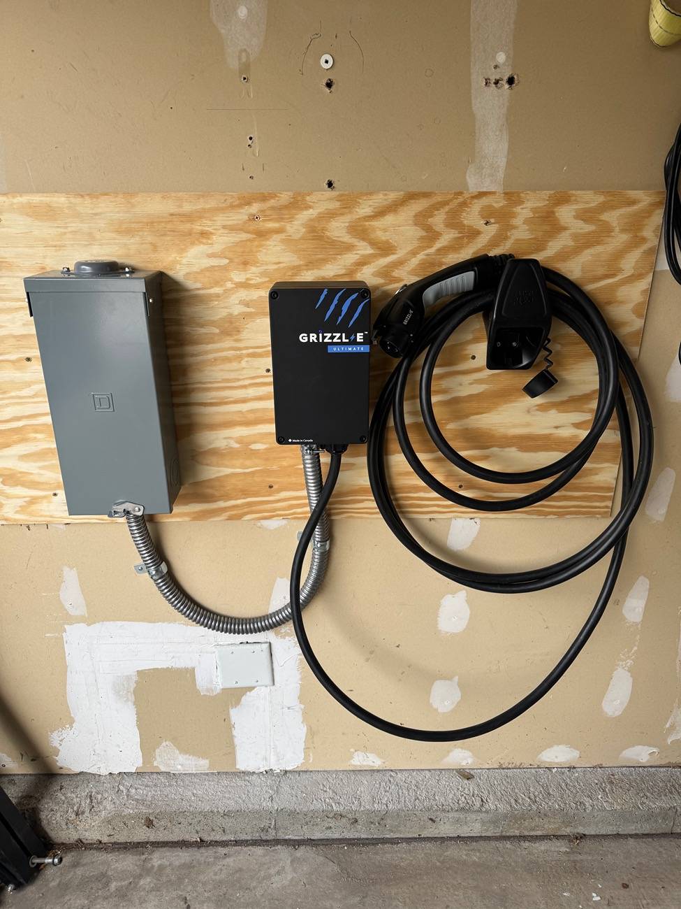

I had an 80amp Grizzl-e charger installed in my garage last week. I am in no way qualified to install a hardwired home charger, so I paid someone to install on the unfinished part of my garage to ensure I did not electrocute myself, or burn down my house in the future..
I am seeing over 10kW speeds when I charge the Taycan now, but the big thing about the upgrade for me is getting 19kW speeds when I charge my Silverado RST. The 40amp charger on the huge truck battery was just not fast enough.

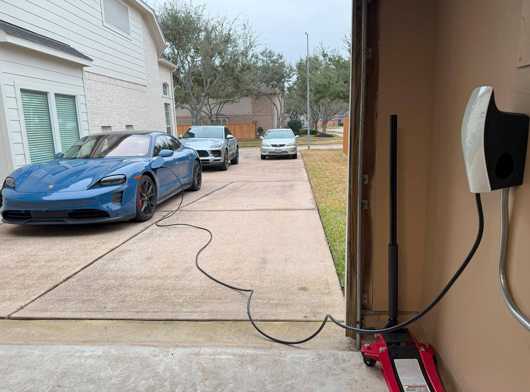

I don't see a Tesla in the drive port, so I was curious on the choice of a Tesla home charger when there are a number of equally as good choices on the market?

^ re Tesla Universal Wall Charger, the integrated adapter is kind of nifty should we ever get a J3400 car. Of course, the same thing can be accomplished just by slapping on (and off) a ~$100 AC adapter. But the cost was almost exactly the same as the $600 EVSE reimbursement from Porsche last year. And I get a kick out of patronizing Magic Docks while not liking Tesla's EVs (or its CEO) so might as well add its EVSE, right? Although even our discontinued 48a JuiceBox works just fine at our primary residence, since we never use any advanced features given the lack of any time-of-day incentives.
