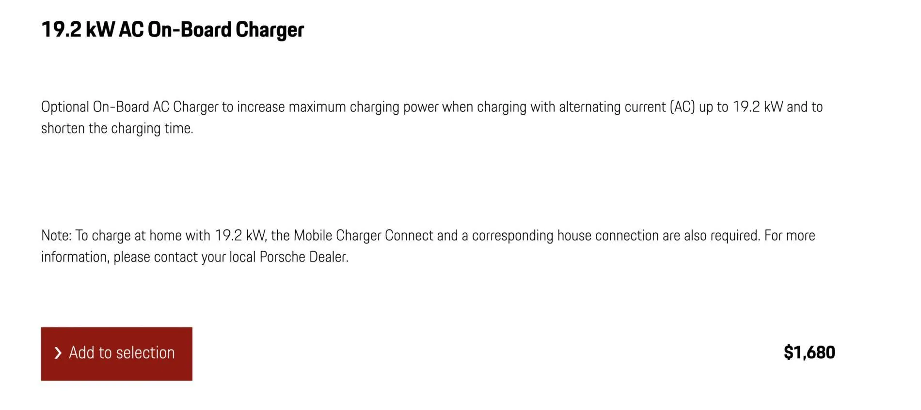

In US market its described as:
Porsche Taycan Just ordered 19.2 kW AC On-Board Charger. Screenshot 2021-03-03 at 05.52.36

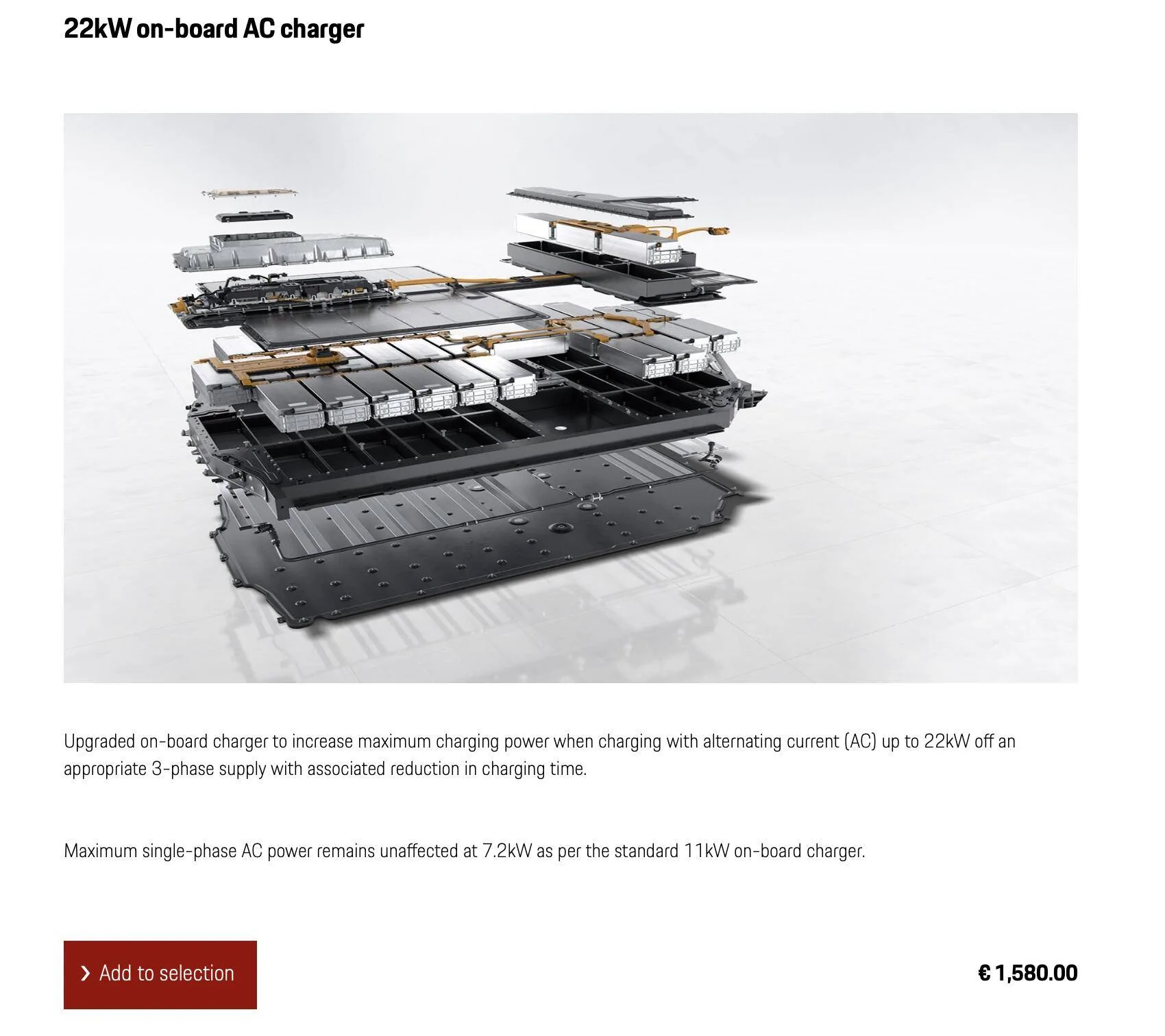

Where as in the EU its:
Porsche Taycan Just ordered 19.2 kW AC On-Board Charger. Screenshot 2021-03-03 at 05.52.58
For the first time I'm noticing 19.2 kW vs 22kW and also the mention of 3-phase in Europe an no mention in the slightly lower power US charger (answering my own question from earlier).
I'm guessing these are very different units installed in different markets and my experiences above have no bearing on the US charger that @GRV is having trouble ordering.

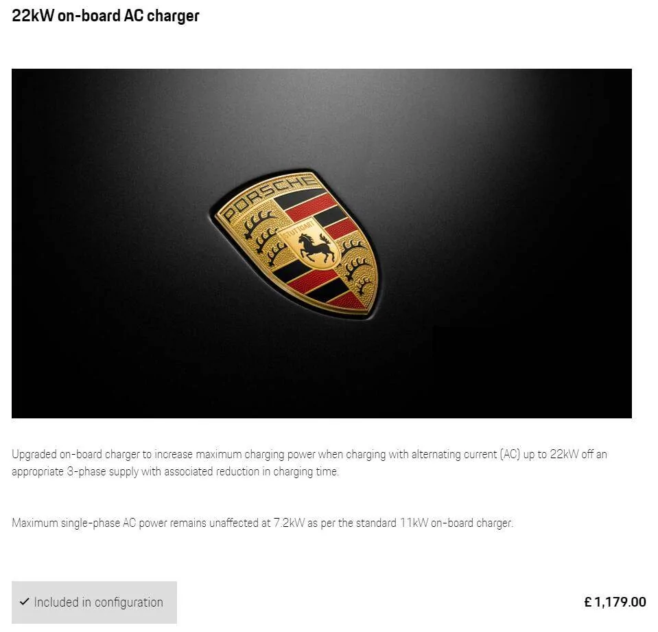

Still shows up in UK (ours is 22kW but imagine they are one and the same).
Porsche Taycan Just ordered 19.2 kW AC On-Board Charger. 1615224681274
Not worth the ?
